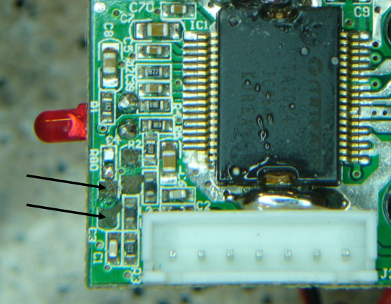

mistake?
I have rev D, just took off C3, C4, did I take off too much?, no place to solder the new caps to (actually wire).
Can this be salvaged?

Re: mistake?
gychang
Oh dear, you've taken the pads and traces as well.....
Still salvageable though, you just need some wire-wrap wire to bridge from the connector pin (or somewhere up stream of the cap you removed) to the input resistor.
just about to bath the kids so maybe someone else can do the pictures.......
