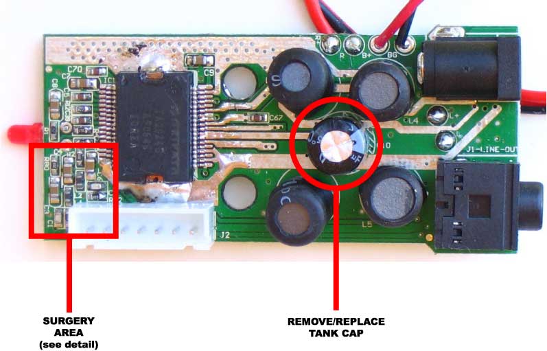

Here are some updates on the new Sonic board.
It seems to be easier to modify than the old board. There have been some nice improvements.
Images and diagrams in the next few posts.

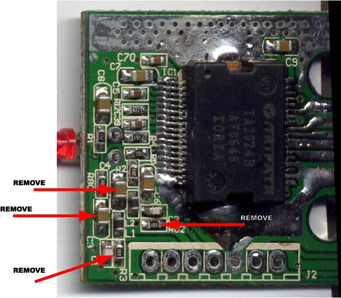

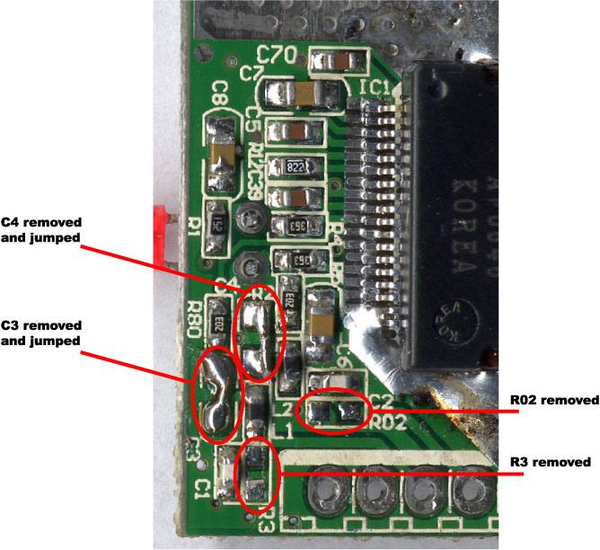

After surgery. Small delicate work.
To bridge the removed caps, use a tiny bit of L shaped wire. You hold onto one leg of the "L" with pliers or tweezers, cut off the extra after soldering.
EDIT: No need to remove the plug socket. It was done here just for illustration.

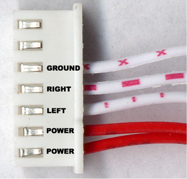

This is the new plug that connects the board to the volume pot and switch. Nice to have a plug!
Don't reverse the cable, the wires are in opposite order on each end. You will not need the last 2 wires on the right, as they come from the mini-plug and go to the pot. You will be bypassing all that, right?
You can use the red switch wires for your own switch, or just connect them together if the switch is elsewhere.

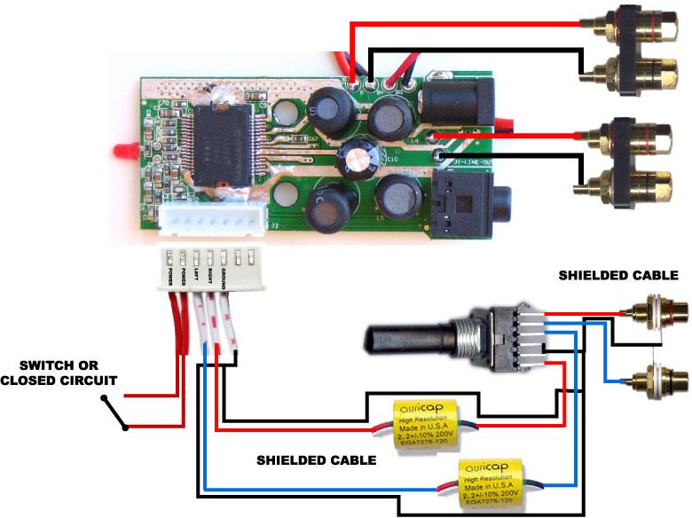

I do need to find a better way to illustrate the shielded cable. Maybe a dashed line for the shield? Or maybe an actual photo of the cable? Anyhow, just wire it up as best you see fit. As long as you get the right wires in the right places, you should be fine.

Questions for panomaniac (and others)
1. Why use a shielded cable?
2. What to do with the two metal (magnet?) rings around which the speaker cables are wrapped?
3. I saw many use two braided wires for all their connections. Can I braid two 24 gauge wires from cat-5 cable? Does that really make a difference?
Thanks to all for infecting me with the D-virus :)
Helps keep noise out of your input signal There is more noise inside the amp than you might think. A long run of unshielded wire can pick it up. 50Hz to 2MHz

panomaniac said:
Here is a detail of where you will do the hard work.
I finally got around to doing this mod, it sounds much fuller now. I used jantzen 2.2 caps instead of springing for the auricaps but I am satisfied.
I learned a lesson when bridging the caps on the board, I should have used wire like you said but I used solder and got too much in there and had contact with one of the resistors, it took 15-20 minutes to clean it up while being careful not to lift the resistor.
