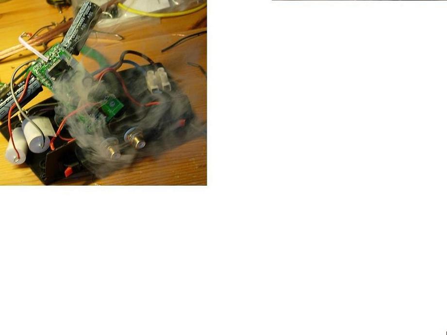

i found that the board it self has terrible through hole plating so even the process of desoldering anything off the board removed any of the through hole plating that was there in the first place.

OK, I understand that there could be bad connections, especially during newbie soldering maniac hours.
But what I have found out is that I have +power on the pins loaded by the trace from where the new "C10"s are located.
I do also have reasonable levels of resistanse measuring on different places all the way from input to input pins.

During measuring the numb T-amp it really was showing it's real condition.
$70 worth of hobby just went up the chimney sort of.
And, Yes they are $70 in sweden + shipping. Someone to buy in US, cutting the board loose from the rest and mail it in a stuffed envelope to Sweden - for a reasonable amount of compensation of work?????

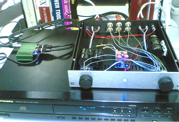

Thought I'd just post a pic of my finished (for now) SI 5066 - I spent extra pennies on a nice box from autocostruire.com to keep the wife happy - although now she wants me to add IR remote control and put the Dac in the same enclosure...!
It's just the usual stealth mods, 6800uF across the input power with 680uF onboard (thanks to lostcause for that), 22uF across the inputs, and a set of the autocostruire inductors. (and a blue led which is far too bright 😎 )
I realise the layout isn't ideal and I should probably braid all the signal wires but I'm happy just for now.
My fears of lightweight bass are all out of the window as there is ample from my Mission M72i's. It's a real pleasure to listen to in fact, no obvious deficiencies so far, as surfer51 says I'm sure I'm getting detail I never picked up before. We are moving house soon but then I will have some more space and hope to build up an Amp6.

Nice case , neat work toolkit! just what i had in mind for the case, i have a marantz cd 63 ki signature, what's the dac your using , does it make a big difference?

The DAC is a DAC in the box - recommendation was via thread on here but I can't find it now. It was to revitalise my Marantz CD52 - but the jury is still out as I have also only just bought a CD63 after my CD52 died a couple of weeks back and I haven't been able to listen properly yet - all still on my desk at work!
