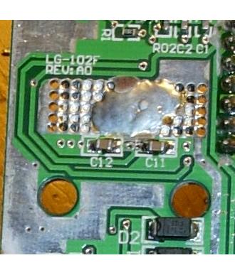

Hi Sharky, sorry for not responding sooner but Sunday is a rest daty afterall 😉
OK so 1st off....yes the caps and inductors crete a low pass filter to remove high frequency RF from the inputs, this makes it easier on the amp.
I have jumped in straight to the pins via an offboard resistor and to be honest I can't tell any difference....is the amp struggling?...no idea!
OK question 2.... look at the link I posted not so far back -extreme modding-, it refers to a thread where '@If' goes into some detail on C10 placement. Personally....I do this modification first before all others because I find it really does make a big difference. I used to drill through the board with a 0.8mm bit and put two caps (one on each VDD pin), that's a little ambitious at this stage so just solder the two + leads between C11 and C12 and the negative leads to the big solder slug.....or just one BIG cap if you can find one?...Just make sure it is very LOW ESR and you're on to a winner😀
You just have to do what you feel confident with...you know what I mean?
Stay cool man and enjoy the trip, if you loose you're cool 😎 you'll loose your board...and that's damn easy...trust me

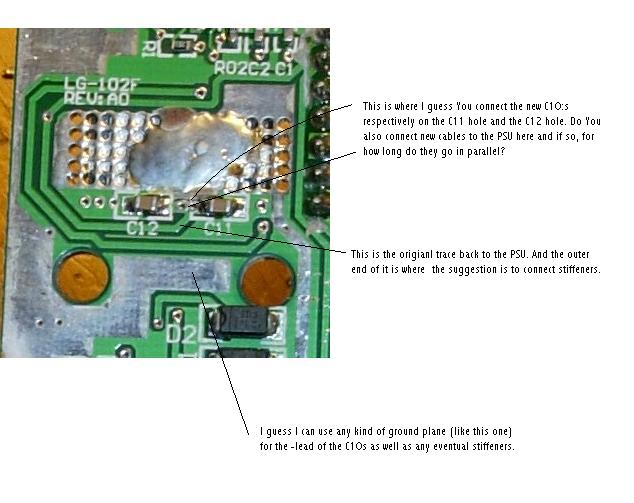

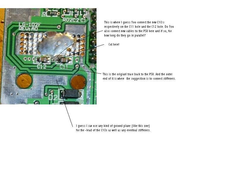

OK, RF doesn’t seem to be a big thing on the input (I guessed it had to do something with that) so I just go right in on exC3/C4 then.
This is where You suggest I should connect the two C10s as I Suppose
http://www.diyaudio.com/forums/attachment.php?s=&postid=681701&stamp=1121324759
http://www.diyaudio.com/forums/attachment.php?s=&postid=681709&stamp=1121325944
which also would be the bottom one of these two
http://www.diyaudio.com/forums/attachment.php?s=&postid=680706&stamp=1121208887
am I right? Looks as a pretty much possible newbie step. Except from the anxiety of how much film/paint I should scrap away to be sure to get rid of enough of it to have contact and still have anything left of the trace…..

Looked at my board and did find something that didn't look like the pictures I related to in my last post. You where talking about drilling holes. When I look at my board it looks like it's two through passes down to the other side of the board right there where I was supposed to solder my +leads from the caps. Wher do they go??? As I haven't found out where C11/12 (as well as the C10) are on the schematic I'm not quite shure of doing the right thing just solder to the whole...
Still wondering about the C10 totally in parallell with the stiffener caps. Why use C10? From my last post up here. No ee that has a great expl?!
Hi Sharky, quick answer....I'm just in the middle of something..
You're board is not the standard layout so we will have to look at the traces to be sure....
C10 is to ensure that you have a filter cap as close as possible to the chip... if you put the cap/s under the board then they replace C10 as they are closer... I was refering to C10 as the low esr filter cap rather than the original....no harm in leaving that there though as well....
OK, time to answer you now...
The two through holes are the same on any model of Sonic, they go through to the supply trace under the chip. That's why you should solder them there. The two SMD caps (C11/12) are the other filter caps and are very important.
However, I have been warned about 'oscillation' from two caps in the same position so I drill through from the end of the supply pins (different position) so that each supply only draws from one capacitor....and I can get it slightly closer to the pins.
I also used to cut the trace between the pins on the board so they were totally independant all the way back to the PSU.
Those new boards look better quality and possibly a better design, but be carefull when reading about past references (C10 etc) as they may not be the same between board revisions.
EDIT: On closer inspection your board is only slightly different from the one's posted on most mod sites and throughout this thread.
OK! Trying to gain some knowledge here, supply to what according to the schematics I linked to in my second last post?
OK, but same question as above, but where to find them on the schematics, There are no numbers or even sometimes the right size (33uF for C10 etc)Lostcause said:
I try to understand. I guess You mean the supply pins on the chip, and that's somewhere else. But where does it then connect to the C11/12?
Isn't that the whole thing if have understand anything 🙂 which might not be the case. To make a cut between the two holes inside of C11 and C12 because they supply to different parts of the chip (different channels maybe????). Does that mean that You connect one C10 to each hole and also cut the power trace just before reaching C11 and C12 and make new power loads via cables from each one of C11 and C12???
Does that also mean that one could connect one Stiffener cap (lets say 5600-10000uF) in parallell with the C10:s respectively?
The last question comes from my present thinking that the stiffeners seems to be in total parallell with C10 as decribed earlier - combining different posts. Or am I wrong here?

Yes I agree in both cases. Brought up @lf:s and my pictures of the same place of the board on the 19" screen and found out that the where very much the same. Just less solder slug on my new board and som minor changes on the traces.
I still do have a bit of a problem following all Your explanations. But looking at myself now compared to a couple of months ago I would have considered myself as an expert from that time beeing. As the newbie I still in fact am.
And this is - according to my very very basic knowledge combined with a number of posts along the way of this thread, how it could look like if I try to follow them.....
To complete the picture there should be another one of each thing, but connected to the hole of C12.
Ofcourse with cuts made between the holes inside C11 and C12 and a close to C11/12 cut on the trace back to the power-in pole.
That is if I should try to follow the instructions from Your post Lostcause together with the other ones.
Somewhere it feels like I'm messings things up, but still... following the advices about stiffeners and C10s it could according to my mind look like this. Even if it doesn´t make any sence having both a small low ESR cap and a much bigger ultra low ESR cap in parallell - or does it?????
