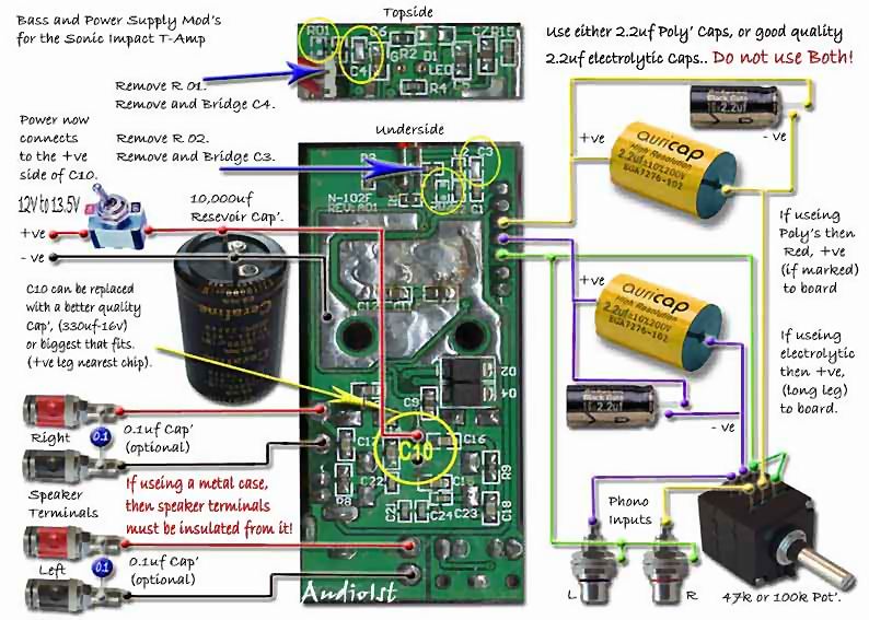

My problem is still - so sound and no light. Got me another multimeter and found out that there is +12 and -12 power to the board. As I don´t have any (lately remebered) electronic experience my next step was to find out if there were any power between the +12 power and groundplane which it wasn´t - My next question is if that is good or bad....;-).
The power +12 is connected over the blobs where the switch should be connected and qould also be found where it originally was connected. So the +12 is alright on the board.
The -12 is connected on the original position, and is alright to the blob. From there I have no idea of where it should/could be found elsewhere....

There is no -12V on the T-amp, just +12V and ground. If you have connected -12V to the ground connection, you have effectively supplied the T-amp with 24V and destroyed it.

Firstly.... you mean +12V and 0V right?, your supply should not be a +12V/-12V....
The best thing to do is connect the 0V negative wire to the large solder pad under the chip and then solder the +12V to the chip side of C10 under the board....if the LED is still dead then we need some close-up pictures.
Make sure you connect the 12V to the pin nearest to the chip.......

Offcourse there is no -12V, just 0 and +12V - It was just names that came up in my head from reading tons of posts about powersupplies and trafos.
Ok, I try to switch place of the 0 first because it seems to be no contact between the original 0 input an the rest of the boards ground. Lostcause to You really mean the soldering pad with all the small holes in it or the big one in the corner opposit from original 3,5 input?

The best setup is to get two FM's onto the sonic, one on each supply pin, but that's pretty tricky to do so make C10 an ultra-low ESR 1000uf (8mm casing fits but you can get bigger ones in there if you put it under the board).
The trick is to get it/them as close to the power pins as possible, this shows you how to get two in there....
extreme modding!
Then, if you decide to have off-board stiffening then you need to have that as close to the board as possible and keep your leads as short as possible. This one bridges the + & - lines like this:
stiffener
Note that you can connect to the existing holes or jump the power to the + lead of C10, but the latter nulls the switch and leaves the Sonic permanently ON.

audio1st said:Another diagram that I hope might help somebody out there....
Another sexy diagram from our hero!
Nice one
No led but at least half the sound i had in mind from the beginning. At least from half as many channels that I was counting in having sound from. So there is hope for mankind.
I soldered the 0 to the big ground plane on the bottom of the ship and suddenly, there were 13,2V to the + pad, but still no led (who needs that anyway🙂 .

Audio1st our hero, even the stiffener cap on picture. Everything set for the Pure Newbies - except for the local traning cource in soldering SMDs. GReat job Audio1st.
But still - only one channel . . . any one have any idea of the next step. Measuring somethings (the multimeter is up and running) or unsoldering cable by cable shifting them around to find out where the problem is???
