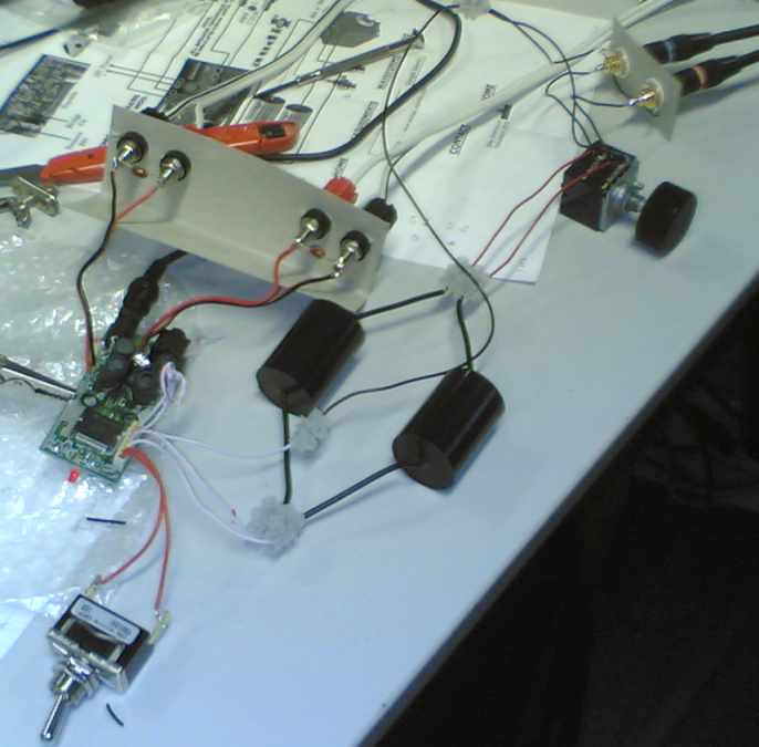

Got rid of the battery compartments and lots of space apeard. I´m mounting the board 90degr turned with the stiffener cap at the end. The two inpt caps wll be put one in the end of each batt comp. Fits perfect.
Got everything soldered except for the Allps pot that hasn´t arrived yet. Hope it will fit together with the rest of the stuff.
Got in to bit trouble thou. After I got rid of the R01, R01, C3 and C4 I couldn´t bridge on the place for the C3. Nothing is accepted to attach to the place where the C3 was. Big trouble
. Have no idea if I could do anything to get the solder pewter to attach.
The next step is to find some other place to bridge to. Have found the L1 and R1 but are not really shure about where the right side of them are to attach to each other. Especially as they are on the opposit side of the board.
Almost here but apparantly not . . . .but so far Happy anyway.....

Yes, bridging those tiny pads is hard.
I have been trying to simply place a fine wire in parallel with the capacitors, effectively bypassing them.
If you do happen to remove the caps, take a very fine single strand of wire from a piece of multi strand wire. Hold it in position with a clip or something. Place a tiny dab of solder on the tip of your soldering iron, and just touch it to the place where the wire and pad meet, then pull up. It should have formed a bond. Repeat with the other pad. Don't hold the soldering iron on for more than a moment. If it doesn't stick, try again.
Additional flux, either on the joint or right on the tip of the iron, makes this easier.
It may be helpful to leave the wire long and use the extended ends to hold in position with tape or some kind of a clip. Once soldered, trim off the extra wire with a sharp knife.

Thanks once again Buckapound for Yor patience with me!
Ok, I´ll give it a try. Flux... aaa that´s something I remeber from 25 years ago. I didn´t think that was still around - that this was something that was used just because it wasn´t in the solder at that time - but is nowdays. I´ll try to find some at the store tomorrow.
I tried to rub the little places for the C3 with a screwdriver because I thought that it might had come some rubbish from the board on the spots - but I don´t know if that is possible? Anyway it didn´t make any differense.
We´ll se what tomorrow has in mind for me - maybe a nice bridge on C3 and some Allps arriving...

Finally!
Used Your recipie for fewer pixels, worked great. Newbie in many areas You see...
Halfway through I think I got the bridge over C3 right where it should. And if it´s not I have found a way to bridge from the side of C3 that is easier to solder to and to the right end of R1 as a life line.
Attach my construction in the half way stage. Using the two holes with plastic bolts and nuts to fix the board. The three wires on the top (red, black and brown) are going to the pot. So is the white and red on the bottom, as well as the loose ends of the resistors. The white ones on the bottom are going to the red Led as loosened from the board and will put back in the original position in the case. The case will look as original except for a new knob on the allps pot.
Not the nicest wiring seen on the net but . . . .

Yes, the Buckapound’s suggestion is very helpful. About SMD, take a look also to the “41hz” suggestion about SMD components soldering that it could appropriate to this situation (especially the paragraph "And now to the actual work" in the start of the topic)
http://www.41hz.com/Forums/topic.asp?TOPIC_ID=21
Contrariwise Buckapound, I had used a piece of solid core wire, I think It’s more simply to solder... look at "c4"in the second image in this my page
http://it.geocities.com/silvio_b2002/audio/t-amp/surgery.htm
My "t-amp site" http://it.geocities.com/silvio_b2002/index.htm

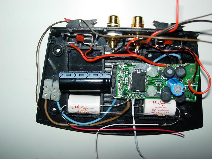

Bought me a new multimeter friday in a little electron shop. Gained currage enough to start working with it yesterday, and it was broken from the start, no sign of life. Tryed to shift it today, no other ex at home at the shop, new ones on thursday.....
What can I say

I got mine going OK - people at work are somewhat bemused about the tangle of wires across my desk. I'm using Soniq Sax 2.2uF caps on the input (from http://www.world-designs.co.uk/acatalog/Capacitors.html) - only because I couldn't seem to find a UK source for the Blackgates etc that are usually mentioned..
I haven't been able to pump much volume through yet so I'll have to reserve ultimate judgement until I've got the case ready and got it home.

Great for You . . . . Haha!
Interesting mess on Your desk - with the obligory Audio1st drawing on it. No "stiffening caps"??
Like to hear Your "vote" later on. What´s the rest of the system.
