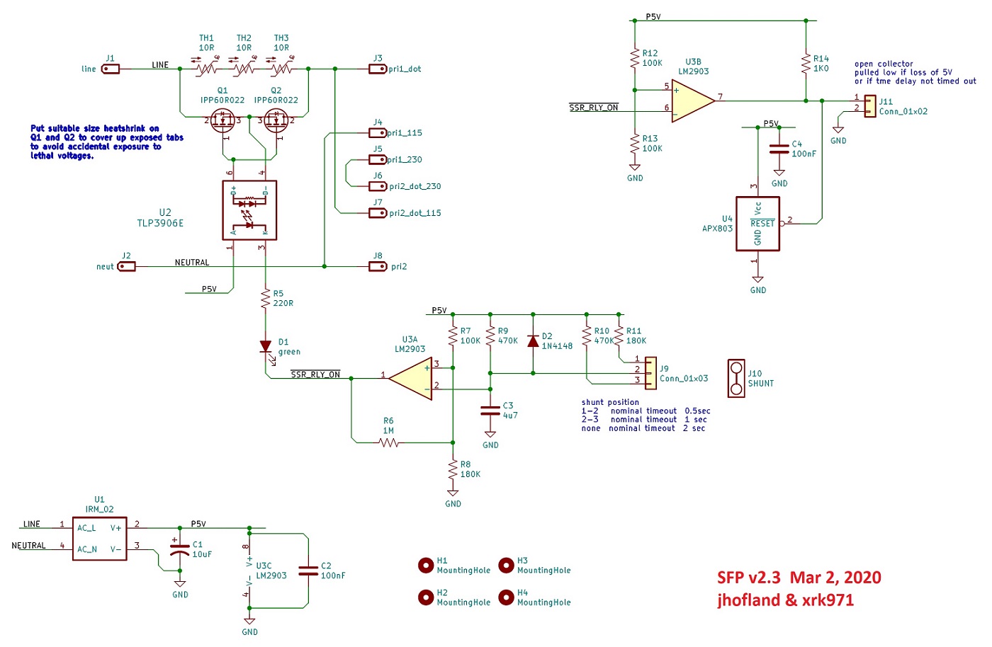

J9 and 10 are just header/jumper to select the turn on delay. Leave the jumper off (hang on one pin so you don’t lose it) for 2 second delay. The orientation of the header pins install does not matter.
Jhofland generally had Cathode of diode pointing to square pad. Easy check is to use the schematic and follow the trace. Which one goes to the comparator? That’s the one with the cathode (short pin).

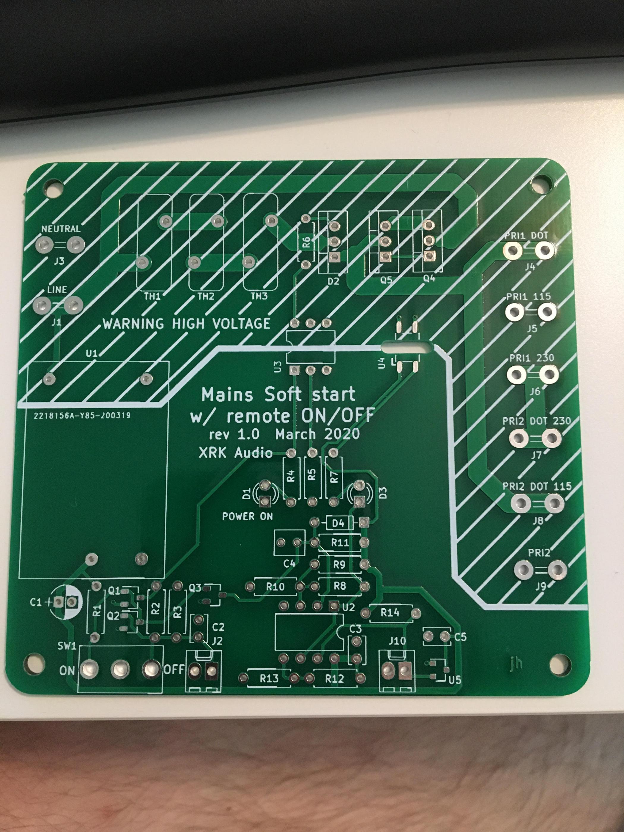

Hi X I'm finally putting together my Mouser BOM for the SFP. I think there's an Excel auto-formatting typo on the Mfr Part # for C1. What's that actual Wurth part number? I can't figure it out without the Voltage rating.

It’s just a power rail smoothing cap. Anything will do here as it is 5v. So even 10uF 16v is fine. But common ones are typically 25v or 35v etc.
As I continue to go through this BOM and look at my actual PCB, I'm not sure I have the right PCB. It doesn't look like any pics that I've seen and it's labelled rev 1.0. And a bunch of the component labels on the silkscreen don't align with the BOM v2.3
I bought this from you on 12/31/2020, so from what I can see the latest version then was (and I believe still is?) v2.3.
Or maybe I just don't have the latest BOM?
Hi PinkFloyd,
I’m sorry there has been a mistake. I sent you the wrong boards. These are prototype ones with remote shutoff carpabilty. So sorry about that. Let me send you a replacement set ASAP.
X

Looking at the schematic. Am I right in that J3 and J4 go to one amp channel , and J7 and J8 go to the other amp channel.
MM
MM
Hi Myles,
J3 and J7 are tied together and J4 and J8 are tied together. So if you have dual trafos J3 can go to J4 or J8 and J7 can go to J4 or J8.
That’s assuming your primaries are 115vac and your mains are same. If your mains are 230vac, there is a common jumper J5 and J6 to allow the two 115vac windings to be in series.
