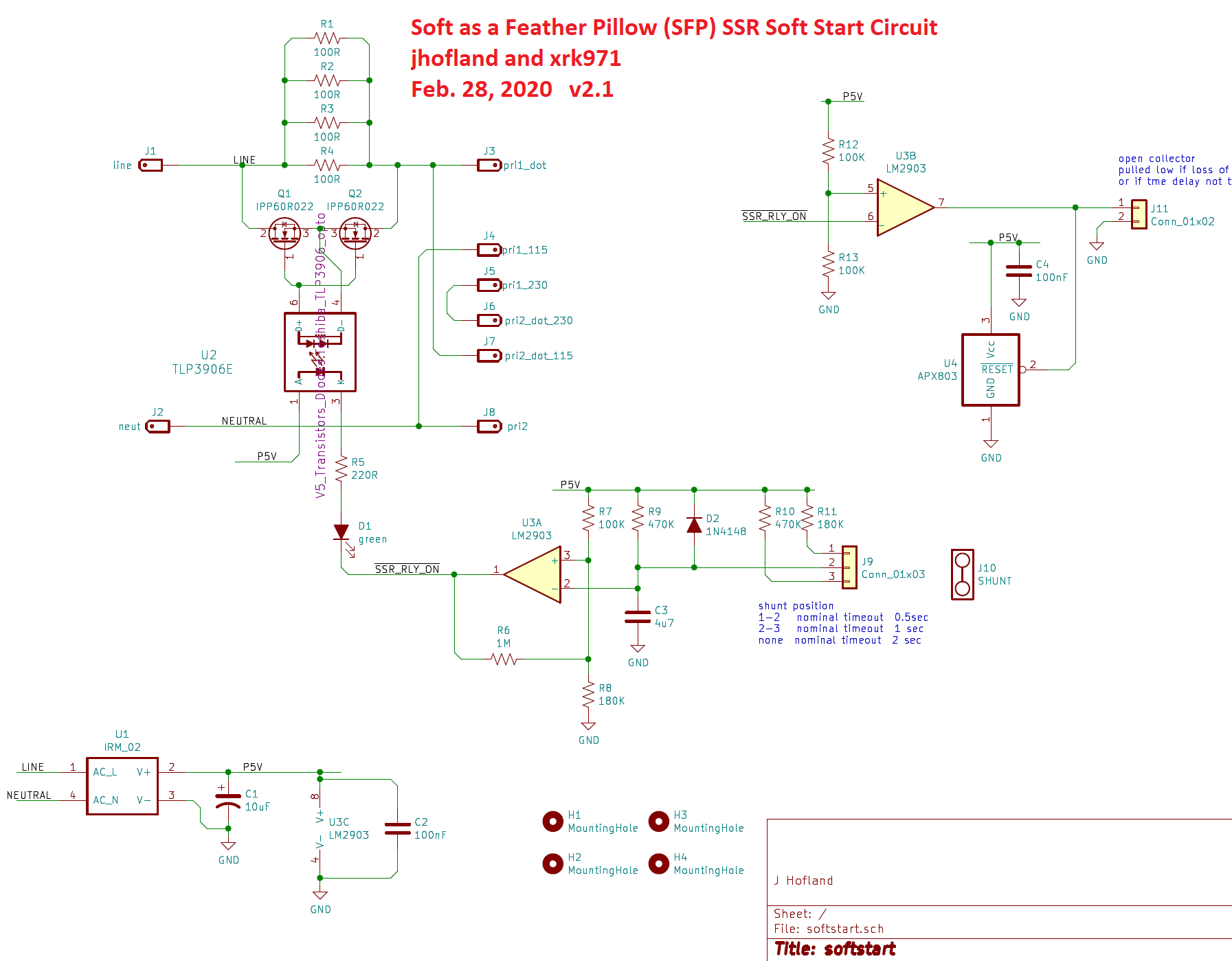

The goals of this circuit were to provide a gentle in-rush current limiter using a bank of power resistors during initial turn on, and then having a low Rdson MOSFET bypass the resitors after a set amount of time. By using a SSR vs a mechanical realy, we eliminate a source of arcing and wear, and the switchover is silent - no clacking of relays. Another goal of this circuit was to provide an added benefit of providing an open collector logic signal that can be used in conjunction with a speaker protection SSR that will tell it to instantly shut the speakers off if the voltage rail of the small on-board 5v SMPS turns off.
A special SSR ultra-low Rdson MOSFET was chosen that is rated for 600v, 23A, and has an Rdson of 22mOhms. This SFP can basically soft start almost any power amplifier in DIYA. With a low Rdson value of 44mOhm for two in series, we will have very low dissipation for even higher bias current Class A amplifers. The MOSFET is controlled with the usual opto-coupler and the start on time delay is controlled by a selectable RC circuit and comparator. Variable turn on time delays ranging from 0.5 sec, 1 sec, and 2 seconds is available via a jumper setting.

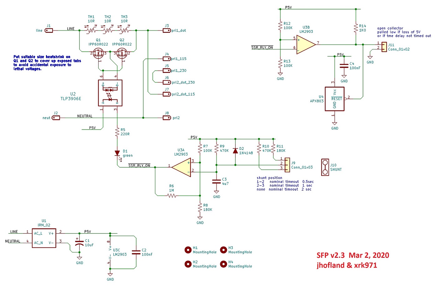

Here is the schematic:
821058d1582964599-soft-feather-pillow-sfp-ssr-soft-start-circuit-gb-sfp-v2-1-schematic-png
Edit Mar 3, 2020 revised v2.3 schematic with NTCs instead of resistors:
attachment.php
BOM for v2.3 here:
https://www.diyaudio.com/forums/attachment.php?attachmentid=821923&d=1583218278

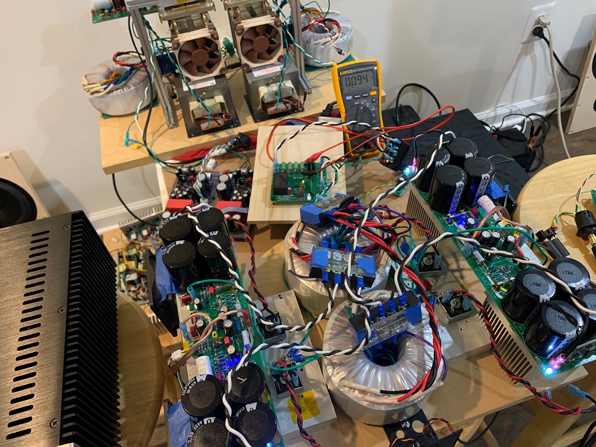

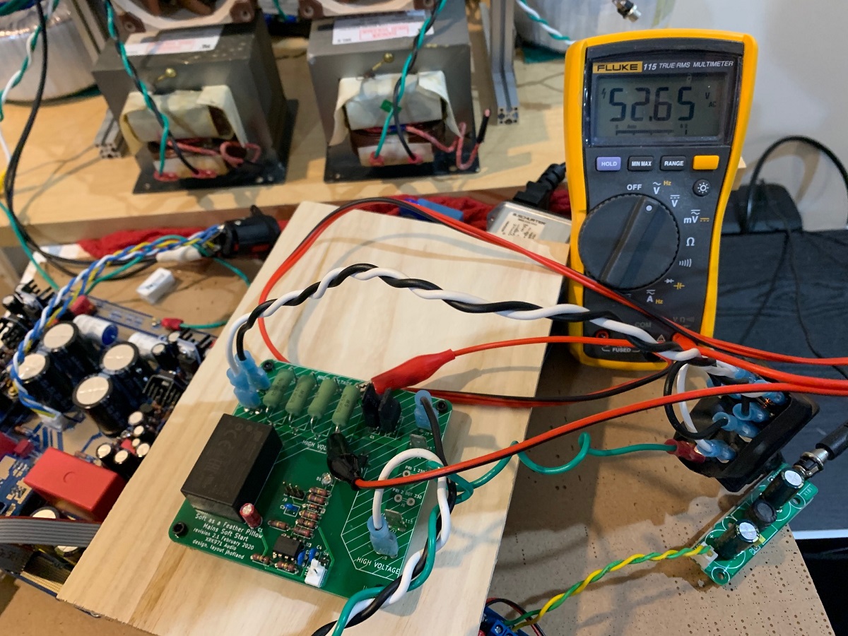

Here is the verification unit undergoing testing with the Omega amplifier:
https://www.diyaudio.com/forums/att...soft-start-circuit-gb-sfp-v2-1-test-setup-jpg

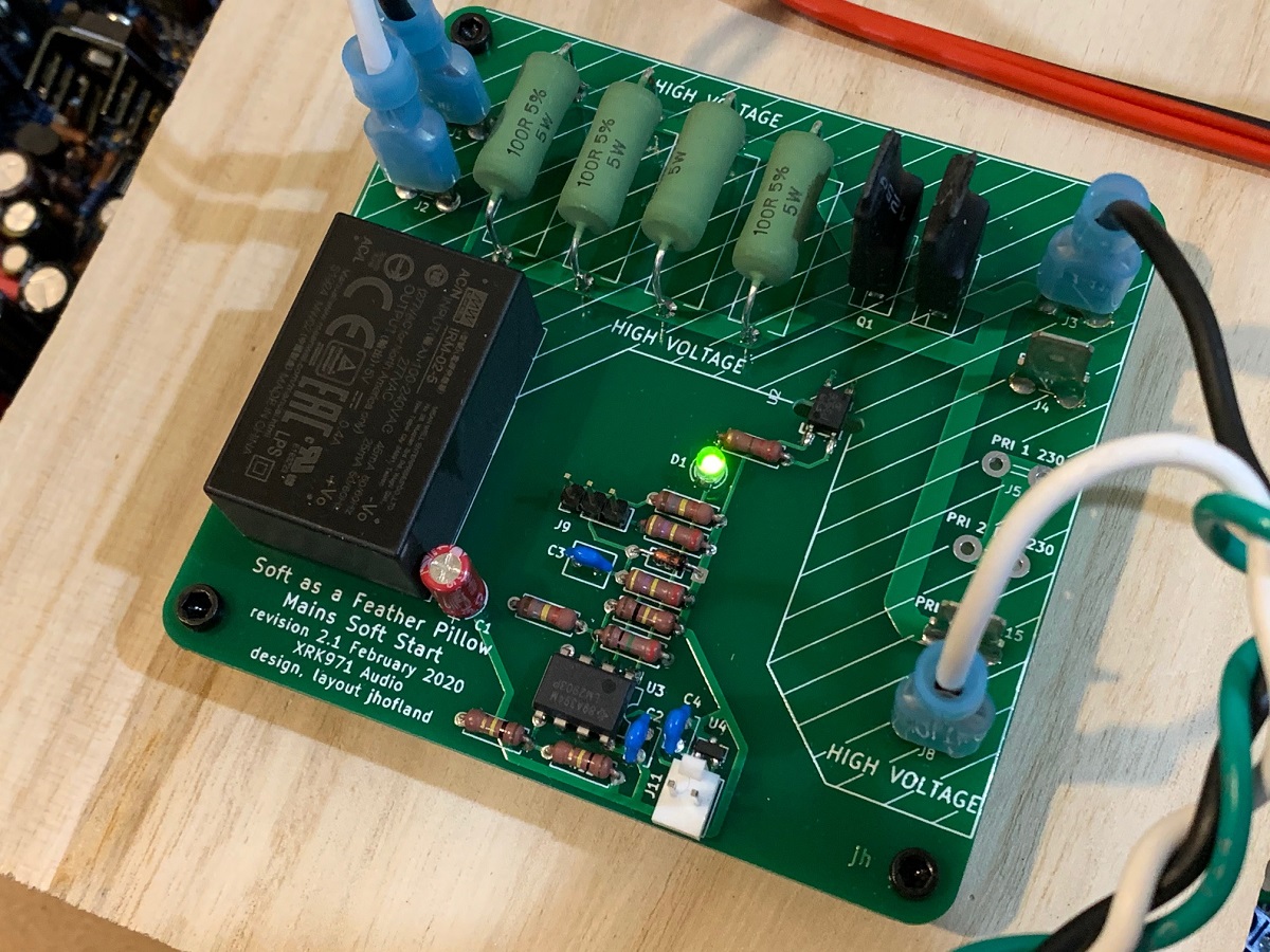

Here is a closeup of the board in action:
821060d1582964599-soft-feather-pillow-sfp-ssr-soft-start-circuit-gb-sfp-v2-1-closeup-jpg

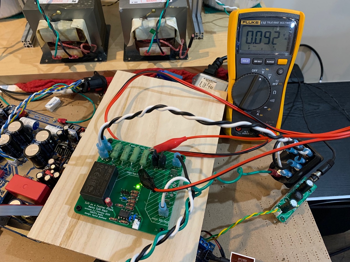

At turn-on, about 52Vac is registered across the four 100ohm (5w ea) wirewound resistors:
821061d1582964599-soft-feather-pillow-sfp-ssr-soft-start-circuit-gb-sfp-v2-1-test-52v-jpg
2 seconds later, the SSR kicks in and the voltage drops to about 92mVac:
821062d1582964599-soft-feather-pillow-sfp-ssr-soft-start-circuit-gb-sfp-v2-1-test-92mv-ssr-jpg
A clamp on current meter showed that the amp was drawing 1.62Arms at the wall plug. So the dissipation across the MOSFETs is only about 150mW. An earlier

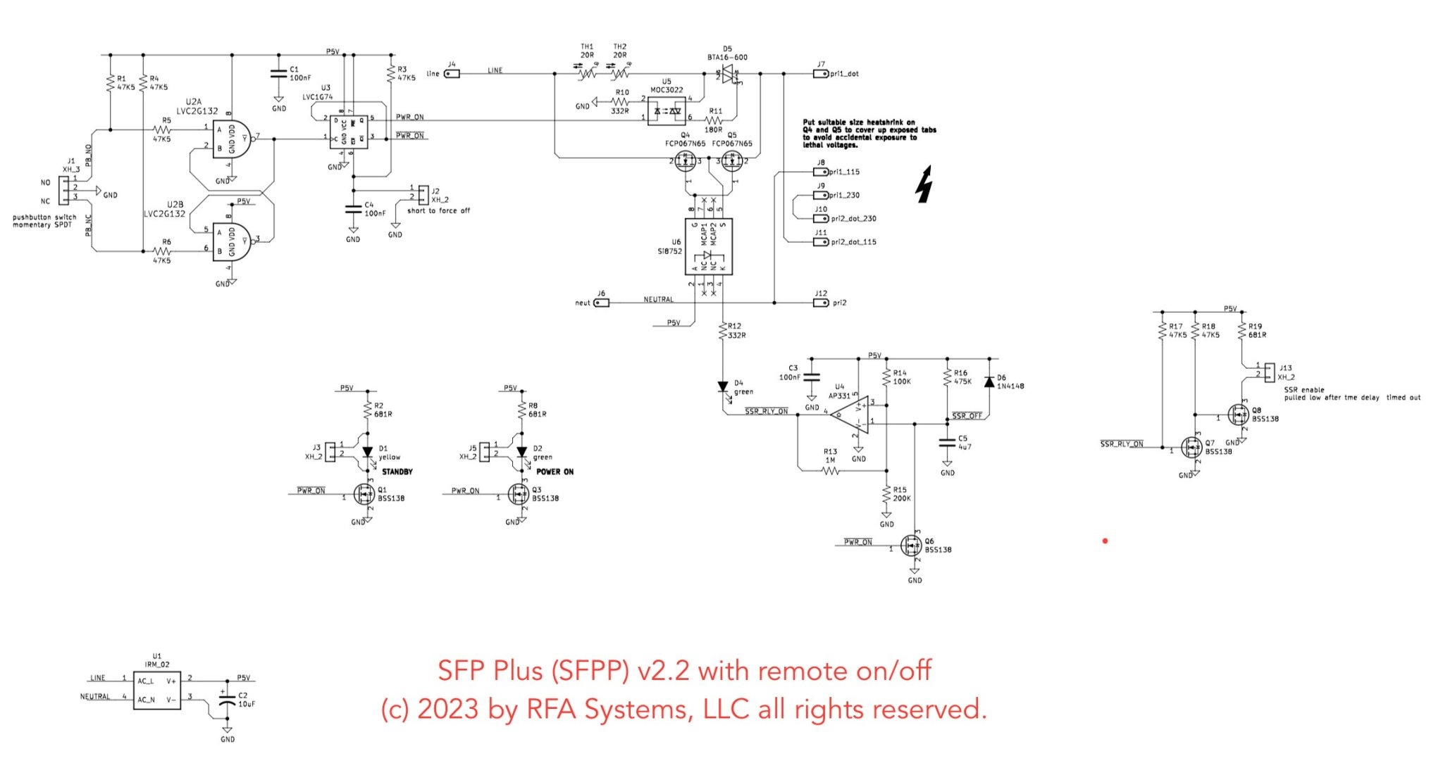

Edit Dec 17, 2023: including the schematic and BOM to the latest variant called the SFPP (SFP Plus) which includes remote turn on/off with a momentary SPDT switch with LED indicator. Great for low voltage front panel power switches with ring LED.
https://www.diyaudio.com/community/...ssr-soft-start-circuit-gb.350441/post-7538507

I just tested the remote speaker protection logic and it works as designed. There is a 2-pin Molex KK connector that is supposed to work as an open-collector output to a logic device. So a suitable external DC voltage (not the built in 5v SMPS), say the one from a separate logic circuit can be connected to the pin 1 logic output via a pullup resistor (10k for example). I used a 9v battery and a 12k resistor connected to Molex KK pin 1. When the AC mains power is applied to the SFP, the voltage below the pullup will go low until the SSR on the SFP switches on, after which it will show the 9v battery voltage. Upon turning off the AC mains to the SFP, the on-board 5v SMPS drops below a threashold (4.63v in this case) that is detected by voltage supervisor, and the output goes low. In this way, this can be used to effect a speaker protection SSR that has a built in quick turn-off logic. This is actually a feature that will be available on the Gen 2 RTR SSR speaker protection circuit. The idea is to disconnect the speakers from the amp output the moment mains is shut off, rather than wait for the large caps on the PSU to slowly drain away while letting the speakers stay connected.
So the SFP has been fully verified to work as designed now.

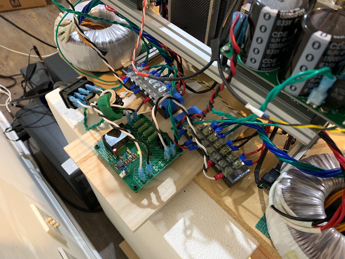

I just installed the SFP on my biggest Class A amp, the Glass Harmony, designed by Hugh Dean. It is a 50w SE Class A amp (truly single 37v rail at 4.7A bias current and uses a 67mH microwave oven transformer for the reactive load. It is a dual monobloc design and I had two separate wall plugs and IECs before. I have now consolidated the mains AC input to one SFP which then feeds two separate ANTEK AN-5434 trafos. It works like a charm now and I bought myself almost an extra volt of headroom because I don't have to suffer the voltage drop through the hot 8D-20 NTC. I might be closer to 52w now. The other bonus is no more turn on speaker thump!
attachment.php
