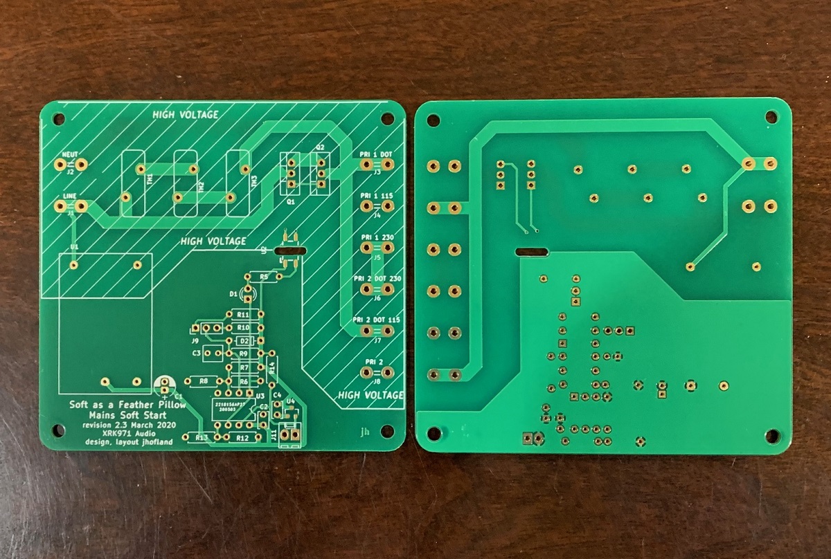

Just a heads up for members considering buying these pcb's from X, you might have to split your component order over both Mouser and Digikey, as Mouser has no stock of U2 and Digikey has no stock of U4 currently.

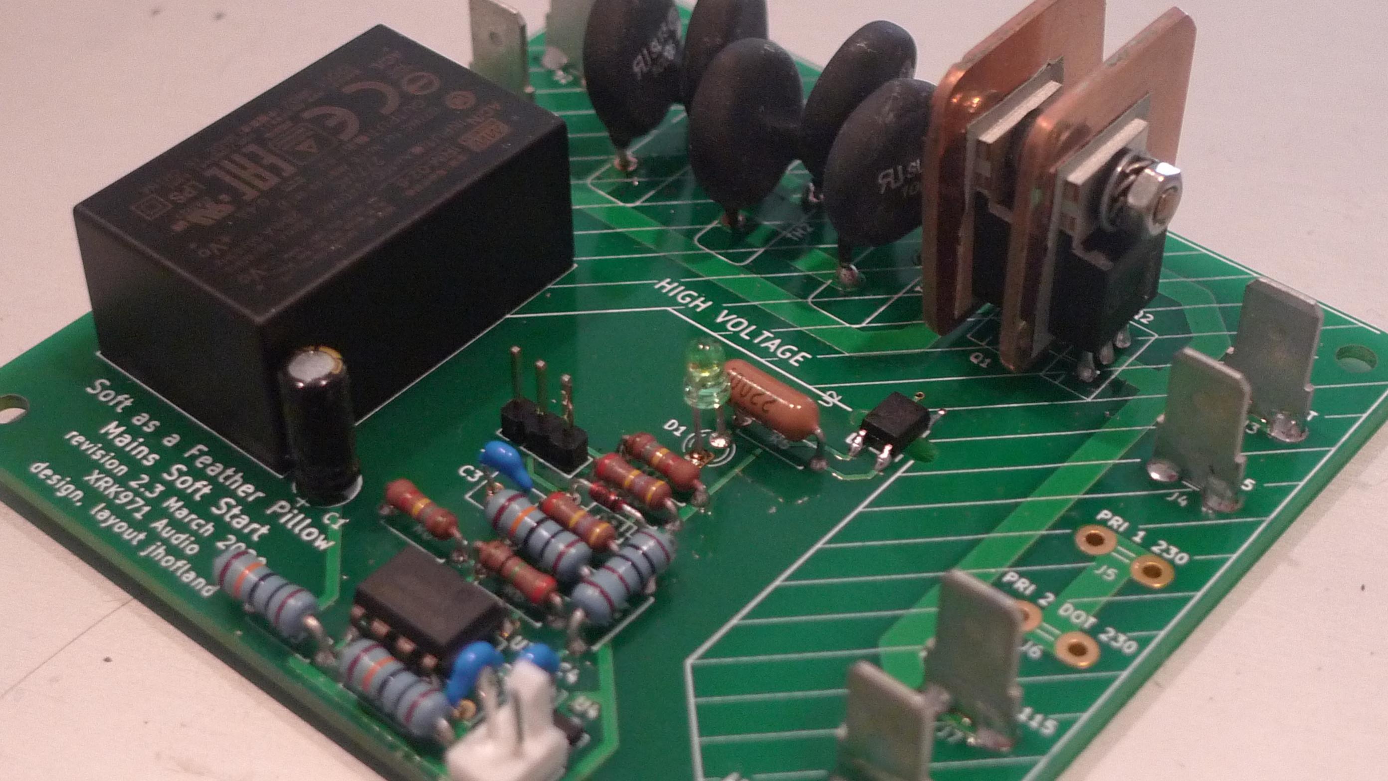

Since you're using SSR on the softstart, would they work like the Crydom zero crossing SSR relay? I've been having issues with the Crydom zero crossing, they caused many brands of Toroid to hum terribly with these relays and I had to remove them all from my builds.
Hopefully it is not the case with this design.
Do
Do
It is not a zero crossing relay - it is similar in topology to the SSR's used on the SSR DC protection relays that I have. It acts as a very low resistance piece of wire when it is on. It doesn't modulate or add distortion to the AC sinewave. Neither I nor Vunce have experienced any issue with increased hum on the trafos when using this.
@pinnocchio,
I believe the Crydom solid state relays are SCR based so they switch on/off every half cycle. This design uses a pair of high voltage high current MOSFETs so, as X noted, it looks like a fraction of an ohm when conducting.

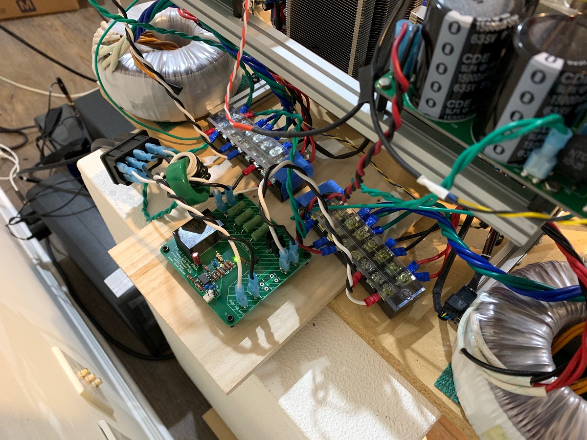

Green Toroid Inductor Core
What are the specs of the Toroid Inductor core and/or part number?
Thank You.
Thank You.
What toroid are you talking about?
You mean this?
That’s not part of the SFP circuit. I just wrap my mains from the wall through that 2-3 turns in opposite directions for the line and the neutral as a common mode filter choke. These are eBay/Ali-Express circa 25mm ferrite donuts. No spec other than diameter. Similar to this:
https://www.diyaudio.com/forums/att...soft-start-circuit-gb-sfp-v2-1-gh-testing-jpg
Anyhow, it’s not needed for the SFP to work. I just use it to reduce RFI from the walls reaching my amp.

Nice! You don’t need heatsinks on the MOSFETs. Make sure the sinks are not electrically live as that is mains voltage. I actually cover mine with shrink tube.
