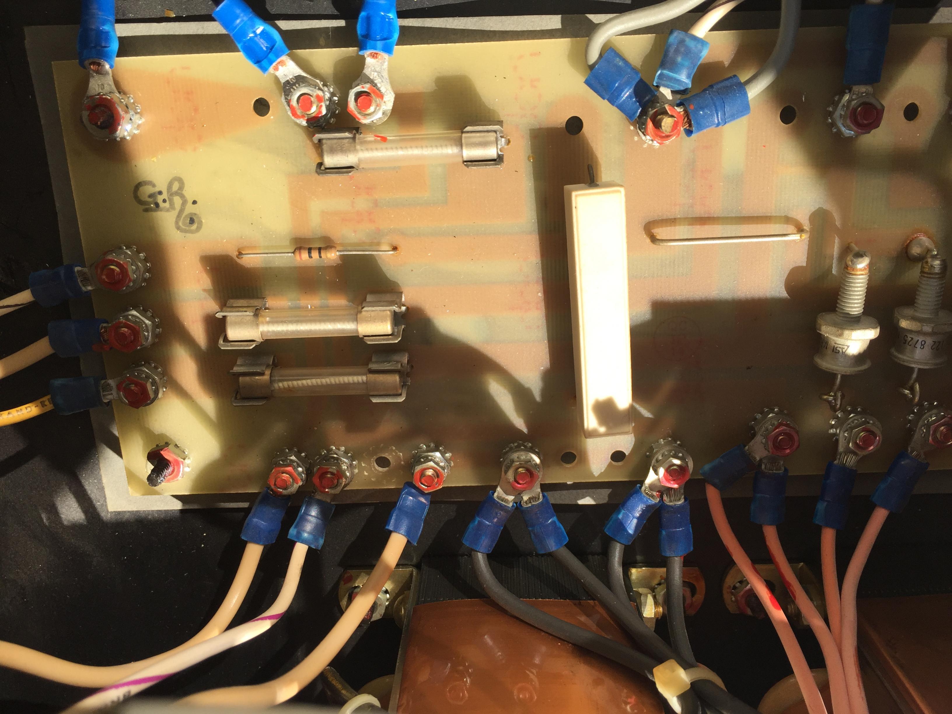

I am not sure these types of soft starts are as great as they are promised.
Over the last 10+ years have used thermister based soft starts for my Krell clone (class A 60WPC) and my 50 WPC Class A Extrema, and actually a number of my other DIY amps. Whether you bypass the thermisters after 2 seconds or 8 seconds there is always a "boooooing" from the large power transformers (physical noise not from speakers) when the thermisters are bypassed. I tried a bunch of CL60s/ 80s etc.. alone, in series, 2 3 etc...
I do not know if its the thermisters not heating up or what as its hard to measure without a scope but it does not seem to be as soft as I thought it would be. Just fyi.
