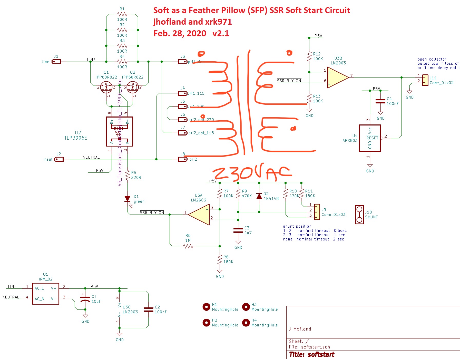

So, why not replace the resistors with the NTC, as suggested and then bypass it with the MOSFETs? Best of both worlds.

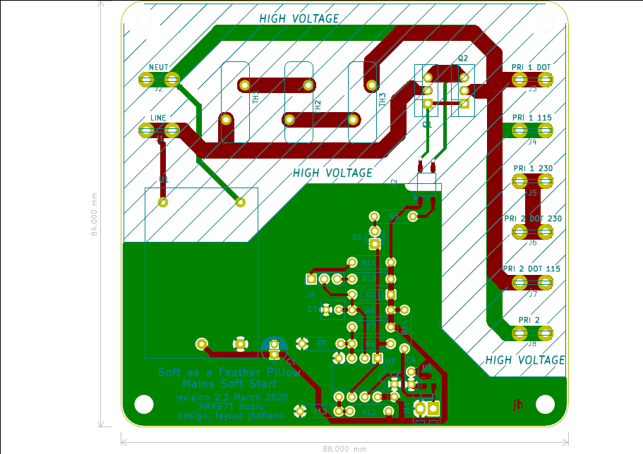

Hi X,
Can you advise the connection details around the connectors J3 to J8 for 230VAC supply. I think your photo's of the board are for 115VAC supply connections, thanks.
Also what is connector J11 used for? I also see you have opted for a 2 second timeout with no shunts connected to J9 in the photo's.

Hi Gary,
If you look at the designations on the connectors, for 230VAC mains, you want to connect your primaries in series. So Primary 1-dot goes to top pin and Primary 1 goes to the middle jumper that allows series connection of the primaries. The bottom of the middle jumper goes to Primary 2-dot and the very bottom pin goes to Primary 2 (no dot). Please see attached marked up diagram.
The other 2pin Molex is for future use with next gen speaker SSR that will have remotely controlled shutdown to disconnect speaker the instant mains is cut.
Indeed. This was going to be my followup question as I am aware of how NTC’s work in immediate turn off - turn on situations.

Those are 5w x 4 or 20w of dissipation. Not a large amount but fortunately, they only need to work for 2 seconds. In that amount of time, thermal issues are negligible.
For 230VAC max inrush current is 230VAC/25ohm = 9.3A. But this dissipates quickly, that is, not continuous for entire 2 second period and in fact drops to something like 50v across the resistors at steady state for a 2.5A load. That would be 100w continuous dissipation if the SSR failed to work. The resistors would probably overheat and burn up. But since the SSR conducts at 25milliOhm after 2 seconds, all is good.
Does that answer your question?

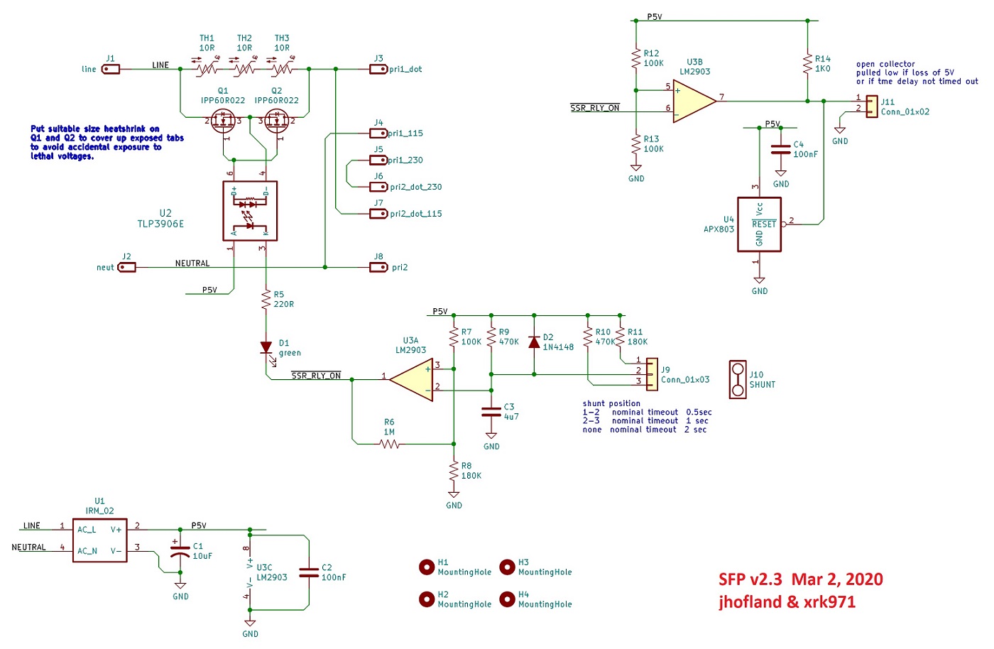

Hi BrianL and Anand,
I just rethought this whole scenario. I was wrong. You guys have a good suggestion, and here’s why.
I forgot that the SSR cuts in at 2 seconds and the NTC never heats up fully. So it retains its high R.
In the event that the SSR ever fails to conduct fully, we switchover back to operation like with an NTC. It will get hot and lower it’s R so it doesn’t burn up. We would be back to the old way of operating but it’s not a hazardous situation like having a resistor catch fire. Let me discuss with Jhofland and it may make sense to put two 8D-20 in series for 16ohms or two CL-60s in series for 20ohms. The two in series is just for extra soft start vs just one. It is a simple fix/change to the layout. I should test it out though.

You would only need to have the NTC on for a couple seconds as by then it's done its work. Then when shorted by the MOSFETs it would return to near ambient quite quickly. So, unless you're trying your best to cycle power very quickly, there's not any likely reasonable scenario where the NTC is not high-ish resistance. Also, if power is being cycled that quickly, your load (amp or whatever) is only partially discharging its supply.

BrianL,
Yes. I agree that NTCs here would be better since the SSR cuts in and they never get too hot.

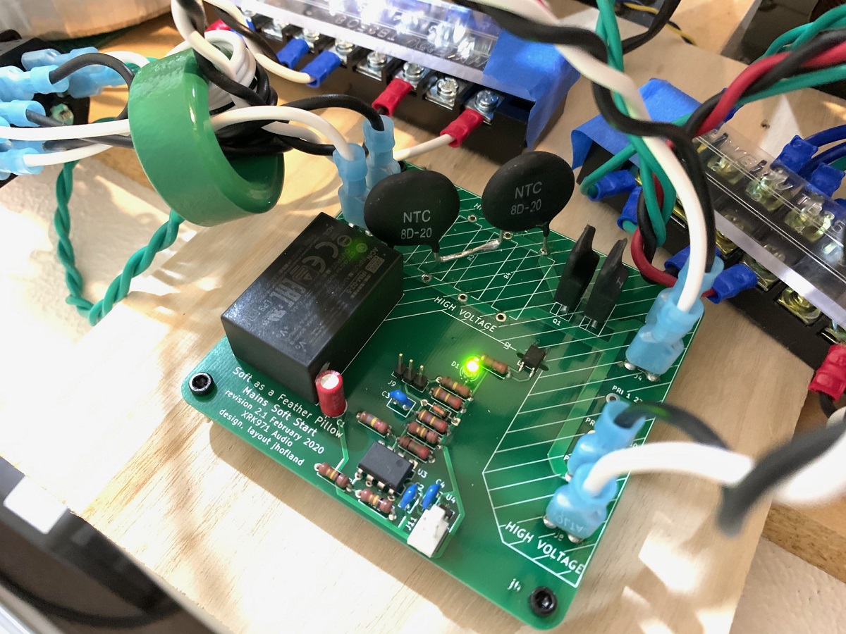

Tested SFP with 2x 8D-20 NTC
I just installed the two 8D-20 NTC's in series on the SFP. It works fine and although the warm up slightly at turn on, within a minute they are back to room tempertature, meaning that they will give 16ohms of turn on resistance the next time around. I could have used three in series and gotten back close to the original 25ohm value of the resistors. Even at 16ohms, there was absolute silence from the speakers at turn on - no thump detected.
I think we will make the design to go with 3 NTCs in series for a truly soft start board. The NTCs also provide insurance against burning resistors should the MOSFET ever fail.

Version 2.3 with NTCs
Here is the schematic and BOM for the new version with the NTC's. This will be the final version going to production and also in my Etsy shop.
