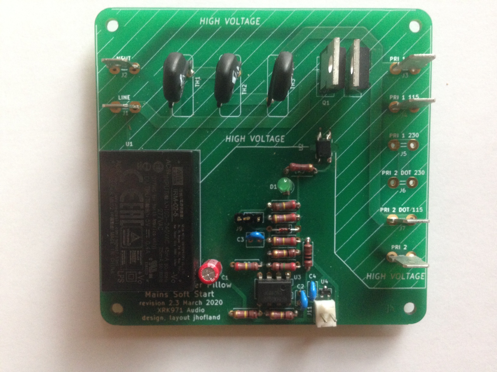

Thanks X, I will use J3,J4 as a pair and J7,J8 as the other pair. Also I built 4 of these for future projects, and on one of them the LED does not light. Thinking that I may have it backwards, I changed it out and wired cathode to the direction of U3 (comparator and square pad ). The led still would not light up.
I will do some continuity checks, and try to find the problem. Any idea's you can help with?

If the LED doesn’t light, it means current is not running through the optoisolator. Is the on board 5vdc supply making 5v? Next is to check if the (looks like opamp) comparator is getting power. Check the pins to see if working.
Please post a nice closeup photo of the SFP that’s not working.

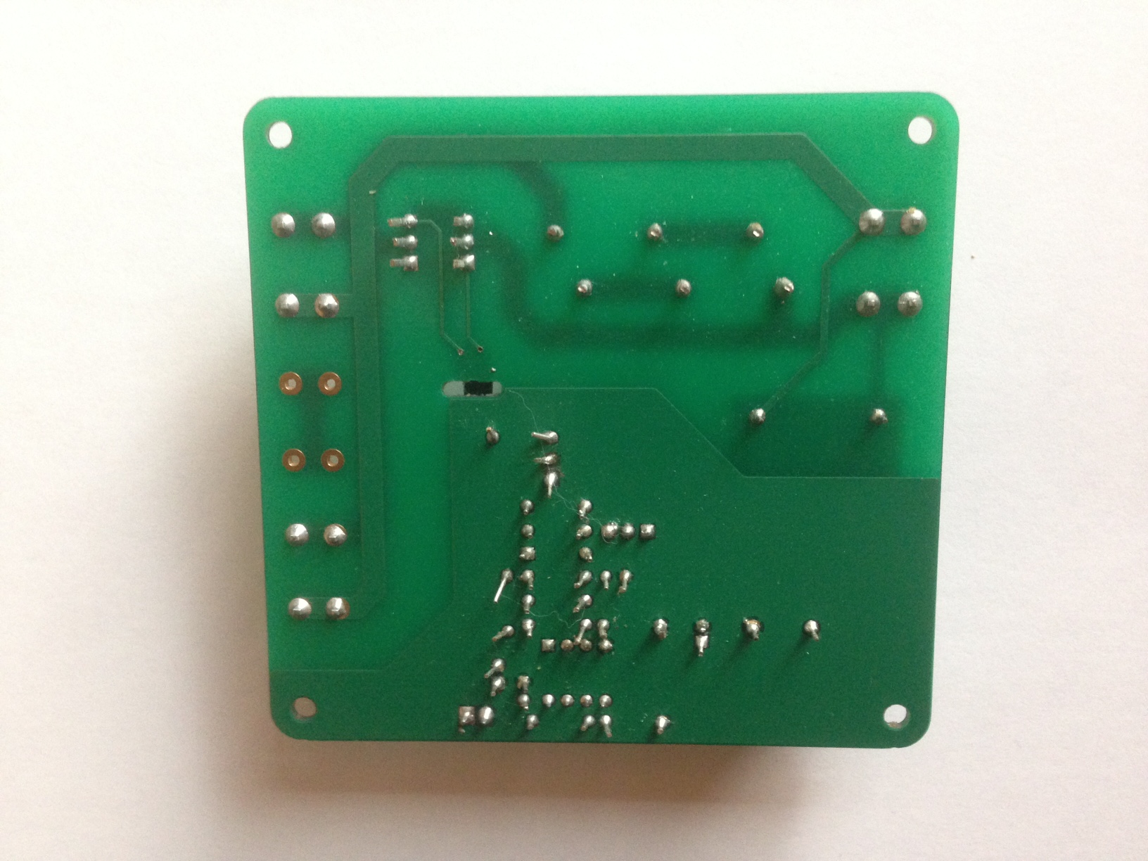

Hi X,
Here are 2 pics
I measured 5VDC on the meanwell irm-02-5 supply.
I have continuity from Line to J3 & J7 and from neutral to J4 and J8.
I have continuity from Mfets to U2 the opto coupler.
I have continuity from the optocoupler to the LED cathode, the light goes on.
From top of C2 I have continuity to the GND of Comparator.
From bottom of C2 I have continuity to the Vcc pin of the comparator.
What I do not have is any continuity from the Line to the LED cathode (no light) using DMM, and, when I hook up mains power The led does not light either.
My R7, R12, R13 values are 64.7k, 50k, 50k rather than 100k ohms, not sure if this would cause the problem I am having.
Let me know your thoughts,

Hi Myles,
I am not sure why you changed the resistor values? All I can say is build it exactly like the ones that work and see if it helps. The 67k you changed will cause the threshold level for the comparator to switch on at a higher voltage. It may not get there.
When you say voltage at TH3 is not 50v, I am not sure what you mean. When the SFP is first powered, all the current passes through the three thermistors (NTC). After about 2 seconds, the MOSFETs conduct thereby bypassing the NTCs. At that point there will not be a voltage drop across them anymore.

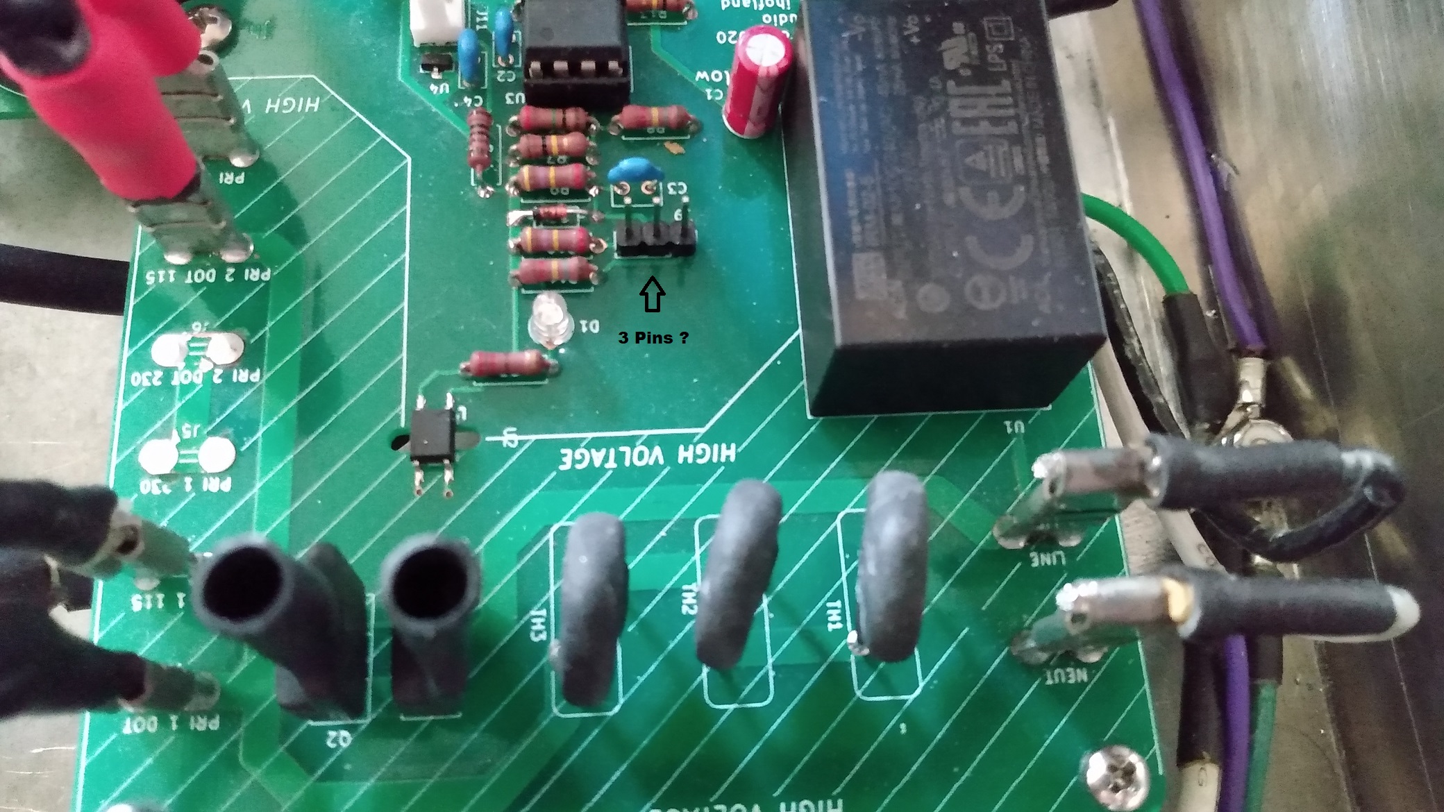

Hi jhofland,
When building the SFP, I soldered all 3 pins of J9 in place. Should I remove it and only solder pin 3 lets say to get a 2 second delay. With all pins soldered, maybe it interferes with the logics?

Hi Myles,
I don’t understand what you mean by “soldering all the pins” of J9? Do you mean they were hard wire jumpered all 3 together? These are 3 separate header pins. Don’t connect them for 2 second delay. Connect per the notes for 1 second or 0.5sec delay.
Hi X,
Have a look at post#103, it shows the underside of the board and how I have soldered pins 1,2,3 of J9. They are soldered independently as if soldering a transistor. No bridges between pins and no jumpers.
