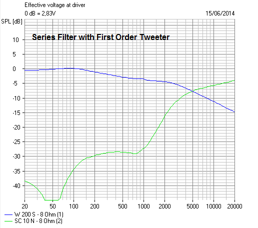

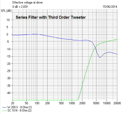

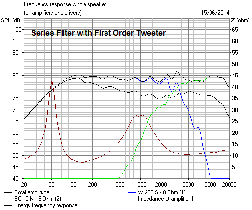

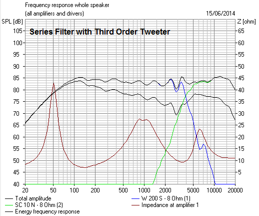

I think we should get back on-topic with a look at what a simple filter does well, and what it does badly. This seems relevant to the Epos M12i.
Firstly, as Robin Marshall said, adding inductance to a polycone to lose the need for an input BSC coil is straightforward. I think he did a very nice job on that bass unit. A slightly difficult frequency response, but not an issue IMO. Off axis, things often look a lot better.
Where it gets more controversial is the use of a first order tweeter filter. This has a more even power delivery and phase and amplitude are not bad at all, especially off axis or with a degree of time alignment. So there is a lot to like. But whilst the tweeter frequency response looks OK, it hides the dreadful loss of power handling. The electrical response makes clear why the tweeter is struggling.
Some tweeters (like woofers) can handle low frequency excursion better than others, but this Epos is not a speaker that can go loud without distortion. A two way is a variously compromised design. You'll get more out of a three way. That's it really. 🙂

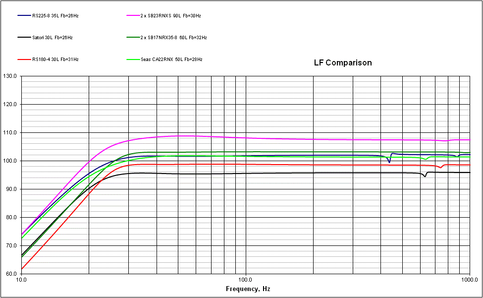

Steve you just made me realize that I forgot to include the Seas woofer. New chart is below. The Seas looks very similar to the Dayton RS225 but my box volume is fairly different that what Troels used, so I'm wondering how different the specs are from what Seas lists.
Fwiw, at this point my top 3 suggestions would be the following, although I am having a tough time with the ranking order:
1 - Amaroso
2 - Finalist
3a - Kairos (if SPL is satisfactory)
3b - SB 3-way with 2 x 17NRXC-8 (that Steve linked to, altho I am not familiar with these designers so I would want to double check the the implementation via simulation first)

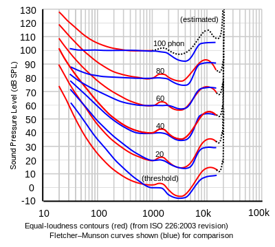

I am afraid you ears and everyone else ears are non-linear with respect to sound level
Yes this is correct. You are referring to what are commonly called the Fletcher-Munsen curves.
....meaning there is only ever going to be one level where music will "come alive" and sound tonally as intended....
But this is a false conclusion to draw from them. In fact if you look at the curves below, there is really not that much of a difference in the shape of the curves (ie. in individual perception) between 80 and 100dB. Between 40 and 80db - yes, definitely. But regardless, this is diy. It's easy to tune the speaker so that the treble and bass get a little more emphasis if you only intend to listen at lower SPL levels. And perhaps this is where a 3-way has a little bit of an advantage over a 2-way for Karl. The adjustments can be done just by changing the resistors for the mid and/or the tweeter depending I guess on where the xo points are. Plus the LF tuning can also be altered to satisfy.
You can choose to ignore it but those with an interest in hearing what was intended have little option but to listen at the assumed sound level.
And this simply incorrect. You can use a receiver's loudness button or the bass and treble controls as well as the methods I just mentioned above.

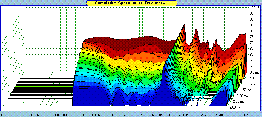

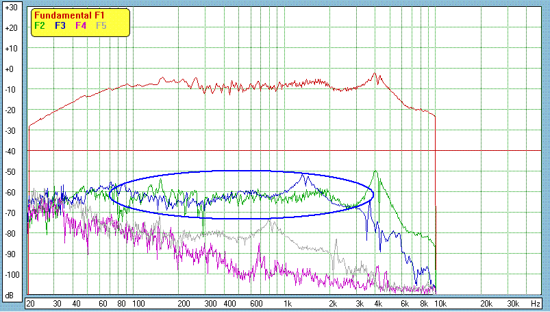

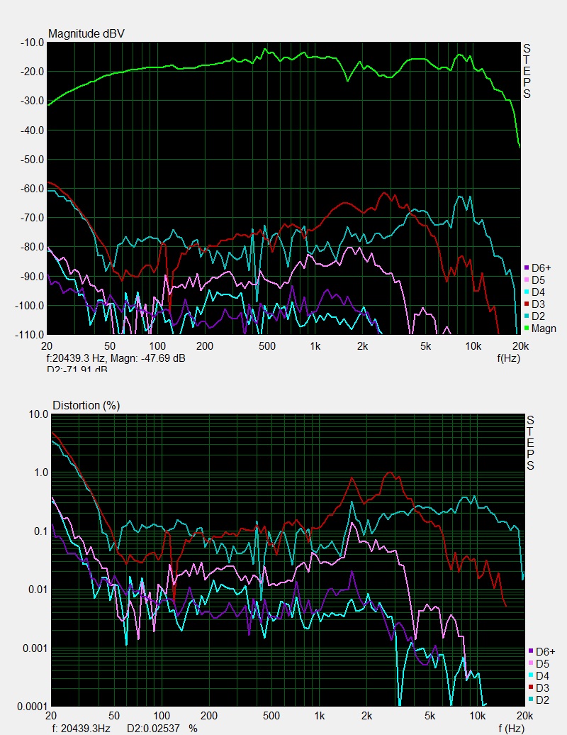

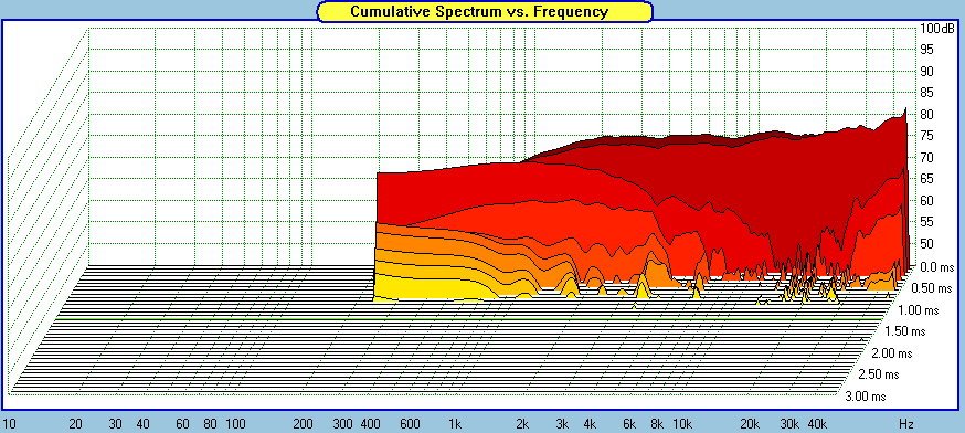

So first something in the way of very simple explanations.
In terms of harmonic distortion, less is better. To simplify, let's just look for the worst offender, the dissonant 3rd harmonic. In the 1st graph below, the red trace is the original FR and the blue line (circled) is the level of the 3rd order harmonic distortion. Pretty much just under the -60dB mark below the original which isn't too bad.
In terms of cone resonances, every cone tends to ring in some manner and for a certain period of time after the signal is stopped. Think of it like ringing a bell. Or perhaps like reverb. Obviously again, less is better. So with these CSD graphs, steep red cliffs (like the 2nd graph) are exceptional and colorful gradual hills or peaky ridges (3rd graph) are not so good - one is very crisp and clean while the other is smeared and out of focus. Notice where the time axis is in these graphs.
Now if that makes sense to you I'll continue. Otherwise subjective opinions will have to do.
