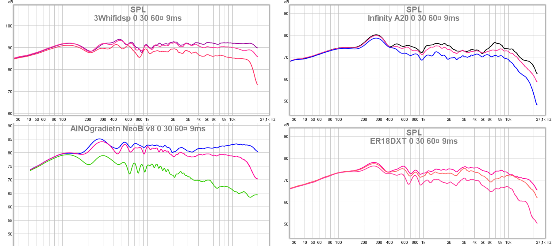

One thing that has been discussed here is directivity. The room and the speaker always interact, and power response of a speaker or horizontal directivity as the most important factor of it, is very important. Large or well treated rooms are not so critical for for it, but as a general rule of thumb, a speaker with smooth response and smooth/controlled directivity will sound best.
Different types of speakers have different types of radiation. We can generalize:
1. 3-4way - low directivity, response dropping at highs above 6-8kHz (1"dome tweeter)
2. 2-3way with waveguide tweeter - low or moderate smooth directivity, dropping above 1-2kHz
3. 2-way with large waveguide midtweeter - moderate and smooth directivity, dropping above 800-1200Hz
4. 2-way without waveguide - moderate and ragged directivity, response dropping 1,5-3kHz and above 6kHz
5. dipole well done 4-way - strong and smooth directivity, dropping above 2-300Hz
6.dipole 2-3way - strong directivity below 1,5KHz, no directivity 2-6kHz, dropping above 6kHz
Here are my measurements of 4 different speakers, response to 04 30¤ and 60¤ horizontally, 9ms gating:
3whifidsp - 3-way with 4" mid and Fountek Neo tweeter crossed 3kHz
AINOgradient - 4way dipole with Neo8 mid and Fountek CD3.5H tweeter crossed at 3,2kHz (smoothest dipole that I know of)
ER18DXT - 2-way with 6½"midwoofer and 1" DXT-tweeter crossed at 1,8kHz
Infinity Alpha20 - 2-way with 6½"midwoofer and 1" tweeter crossed at 3kH
z

Karl, the RS28/RS225 design by MarkK is another well executed design. The beauty of this design is that you can reuse the tweeter and the woofer in the Finalists if you want (the RS28A and RS28F are pretty much interchangeable), all you need to do is add the Vifa NE mid. So if you build it, you've still got options to build something else too.
This design is crossing an 8" metal woofer to a 1" tweeter without a waveguide. The severe breakup of a metal driver will be driven by the low order harmonics within the operating range of the 8" driver. It can be addressed to a fair extent by using an expensive crossover with steep slopes and notches. Using a midrange would avoids this.On the HT forum I came across this...
The breakup in the metal woofer and it's diameter will force too low a crossover point for the tweeter. This means the tweeter will limit SPL with distortion in the range most sensitive to the ear. Asking too much of a tweeter at the low end seems quite common in DIY designs.
The directivity of a 1" driver and an 8" driver are significantly different. A waveguide should really be used to help with the match if high fidelity is a concern.
Getting a configuration like this to work reasonably looks like a fun challenge but I would not have high expectations. Normally a 2 way with a large woofer is going to be better off using a driver that has a controlled breakup and not the severe breakup of a metal woofer.
What proportion of those peers have a vested interest? What proportion have unbalanced enthusiasms?op, you should only buy a speaker you have heard or build something that was reviewed by many many many peers. Now people recommend speakers they havent heard and think they sound good based on measurments!
If measurements show a design to be less than competent from an engineering perspective should it be passed over? That is, can a design measure poorly and yet be a good speaker worthy of high praise and good reviews.
What do designs that measure well sound like to you?
What is making these designers renowned to you? I am not disagreeing with your choice just asking what you are picking up on.If you are going with a kit, go with the most renown diyers designers like jeff bagby, paul K. ect.
I think that andy19191 is too critical now - you will end up with empty hands that way! There is no such thing as the ultimate/best speaker or best choice!
MarkK's Dayton 8+1 is by my estimate a fine speaker (for a 2-way) with popular high-value drivers. an excellent "first diy-speaker".
Karld, you must make your choice now and start building! If you choose a well documented speaker and listen to it at home and make your own measurements you will learn much more than reading this thread! Personal experience will give you confidence and you have more solid base for your next project! The grass is always greener on the other side of the fence!
