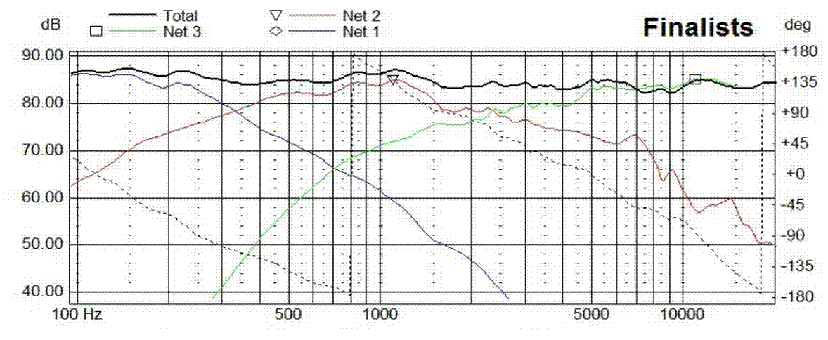

Like the finalists seem pretty much what I am looking for in terms of drivers and budget. It's a bit of a box. Could it become a floor stander?
Absolutely.
Could the mid and the woofer live slightly further apart with the 8 in its own box on the bottom and the 5+1 have a box of their own that sits on top maybe on some cool looking short steel posts?

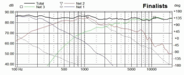

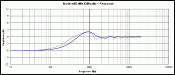

Partially yes. The rule of thumb is that 2 drivers should be spaced within 1/2 the wavelength of their xo frequency. In reality, this often gets stretched to 1 wavelength. The Finalist's low xo point is at 320Hz, which has a 1/2 wavelength of about 21" so you have lots of room to play with there but I would still suggest trying to keep them reasonably close together. So yes you can move them further apart.
However, putting an inch or 2 of space in between the 2 cabs will also change the baffle diffraction in a potentially negative way for this design. The 1st chart below shows the change in baffle diffraction between the original cab (grey) and a new one about 12" high (blue) and the 2nd is the Finalists' FR. Notice how the changes are going to further accentuate the Finalists' peak that already exists at about 1200Hz and then going to also reduce the response further just below the peak. That's probably not going to work well. But separate cabs without much space between them should be fine.
For context, the higher xo point is at about 2300Hz which has a 1/2 wavelength just under 3". Notice that the tweeter/mid spacing is actually closer to 6", so the 1 wavelength distance in this case.
Could I curve the side panels?
Yes, but the open back mid tube length and diameter need to remain the same. So that means on the mid cabinet, the depth has to stay the same and the curve of the panels can't be so extreme as to result in a back panel width that is less than the tube diameter which is 6". You also do not want the maximum width between the 2 curved side panels to be about 10% larger than the existing cabinet width.
Yeah I could facet the front but how much before I ruin the design?
Around the woofer won't matter very much at all but around the mid and the tweeter you are best off asking the designer personally. What I'm seeing is that large edge treatment is actually reducing that 1200Hz peaking on the mid so that would be a good thing but I haven't looked to see how that would affect the tweeter response.
You said you wanted to work with some software so if you want to see for yourself what some of these changes will do try the following:
If you have Excel: Baffle Diffraction Simulator
Or if you don't: The Edge
Or try both, each one does something that the other can't do.
