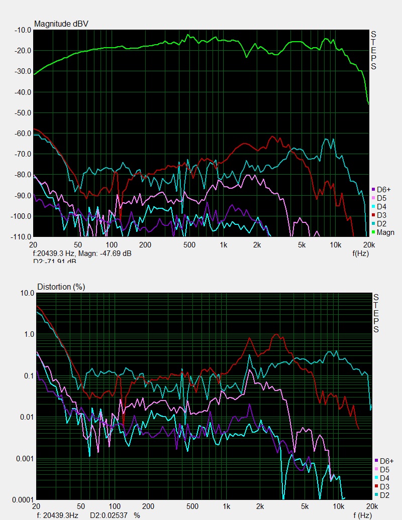

I'm probably going to upset somebody here, but this MarkK Dayton metal woofer RS225 is IMO absolutely dreadful in implementation:
Dayton Reference RS225
That crossover is way too complex and expensive. Dissi knocked up a much simpler way of doing it: http://www.diyaudio.com/forums/multi-way/220465-new-drivers-my-2-way-boxes.html#post3181822
Another piece of audiophoolery IMO is Zaph's ZD5: Zaph|Audio - ZD5 - Scan Speak 15W8530K00 and Vifa XT25. This speaker will work just as well with a simpler 4th order tweeter filter.
I suppose it proves that if you baffle people with enough complex nonsense, they will buy it! 😀
FWIW, I still think I could do something with that Epos M12i crossover to get away from the daft first order tweeter filter. 😎
This design is crossing an 8" metal woofer to a 1" tweeter without a waveguide. The severe breakup of a metal driver will be driven by the low order harmonics within the operating range of the 8" driver. It can be addressed to a fair extent by using an expensive crossover with steep slopes and notches. Using a midrange would avoids this.
The breakup in the metal woofer and it's diameter will force too low a crossover point for the tweeter. This means the tweeter will limit SPL with distortion in the range most sensitive to the ear. Asking too much of a tweeter at the low end seems quite common in DIY designs.
The directivity of a 1" driver and an 8" driver are significantly different. A waveguide should really be used to help with the match if high fidelity is a concern.
Getting a configuration like this to work reasonably looks like a fun challenge but I would not have high expectations. Normally a 2 way with a large woofer is going to be better off using a driver that has a controlled breakup and not the severe breakup of a metal woofer.
Linkwitz would claim otherwise, as would the many hundreds of people who praise the Orion so highly.
attachment.php
The RS225s distortion issues hit around 1.8kHz, one needing to cross a little before this, and steeply, to make them a non issue. MarkK handles this with the unusual quasi 8th order xover @ 1.2kHz in one of his xovers and ~1.5kHz is in his revised version, that uses notches to push the xover into 8th order slopes around the xover frequency and then transitions to 4th order once significantly within the stop band.
These both provide more than 10dB attenuation before the 3rd order uglies from the RS225 hit, keeping them well out of the picture.
Mark is no idiot and knows that the design pushes the tweeter extremely hard. There's a reason why he posts punishing 3 tone non linear distortion tests for the completed loudspeaker at the end of the design page. These were done on purpose to make sure that the tweeter could cope. The measurements show that it can.
While you wont get any argument from me about the use of a wave guide, having the xover frequency at around 1.5kHz does limit the off axis issues of such a design. Mark shows some lateral off axis measurements and they are as flat as a pancake, the low xover making these far less of an issue than they would otherwise be.

Btw you might be interested to know about this. 😀
