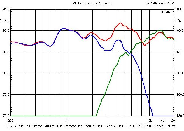

You've got to be careful in criticising a speaker, as Fatmarley points out. The Snell and Audio Note 8" plus 1" speakers were very competent designs with decent second order filters, and low crossovers in their case. They deal with the problems of this combination:
8" bass has a first breakup at 3.5kHz, and a third serious one at 7kHz. This is a matter of cone geometry, and regardless of material. There is also a surround dip around 1kHz. It's how it works.
The Epos M12i and MM 3A De Capo have what I call MIckey Mouse filters, that make for a speaker that can't go loud without distortion from the tweeter, and particularly with the fibreglass De Capo bass, a lot of cone breakup.
Reference MM de Capo i loudspeaker Measurements | Stereophile.com
Both have a filterless bass and a single capacitor crossover. This sounds loud and immediate, but turn the wick up and your ears will bleed with the harsh distortion. A LGWAG speaker, as Lynn Olson calls them. You can see the De Capo has worse bass cone breakup than the polycone Epos. Both need proper tweeter filters. The De Capo needs more work than the Epos on the bass filter. Both designs have extremely good drivers, and for that reason I think they are both worth fixing.

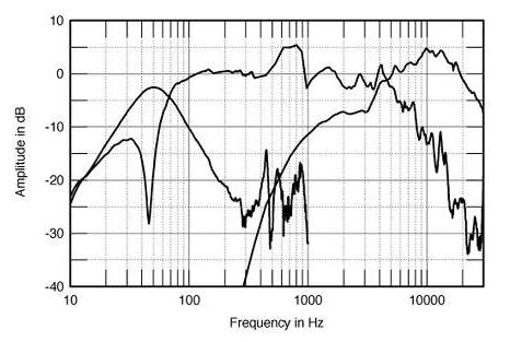

Here are some measurements of an expensive Audio Note speaker. Why do you think the reviewer said it measured better than he expected given the measurements are poor? Might it be that his expectations were based on having heard a strongly coloured (if that is a more acceptable word than distorted) speaker?How can 5th element be taken seriously when he recommend a speaker he never heard? and he blast audio note speaker and ref 3 a, both speakers who have huge following and sounds amazing but he never heard.
