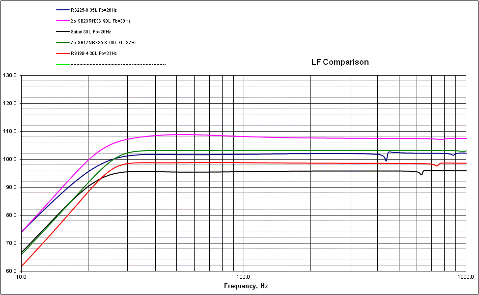

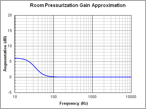

Let's try to flesh out how some of the speakers are going to meet some of your criteria now.
Let's start with the LF response.
The 1st graph below is a simulation of the LF gain in your 14' room this time with 70% losses.
The 2nd graph shows the combination of this room gain with the LF responses of the woofers that are in what would seem to be the top choices for speakers so far. The SPL levels are the maximums for each driver (or set of drivers) before xmax is exceeded when they are playing content above about 30Hz. Each one gives you a flat response down to about 30Hz although some go a bit lower. The obvious take-away is that the 2 x 8" drivers will play the loudest and that the single 6.5" driver plays at the lowest SPL's.
Note what xmax refers to - this is the limit at which the coil stays within its magnetic gap or in other words the point at which the signal starts to get distorted when played louder. And each driver will play a little louder than shown, the coils can physically move beyond xmax, just not as cleanly anymore.
Also note that the SPL levels are for 1 speaker at 1m. For 2 speakers add 6dB but for sitting about 9' back subtract another 6-9dB. (In room, especially a small one, the SPL's don't drop off with distance quite as much as theory might suggest, but I don't want to get into that, so 6-9dB should cover it). So the maximum SPL's at your listening position for each driver are going to be at about the levels the graphs show or perhaps just a little bit less.
Now it's up to you to decide what is going to be adequate for you. Clearly, andy has his own personal preferences and so do I but this is about what is going to work for you. Also, try not to confuse quantity with quality here at this point.
Box volumes and tunings are also listed btw. And when I can I like to use real measured TS parameters as apposed to the manufacturers' specs - there is usually at least a small difference. So the Satori and SB drivers all use Zaph's measured data while the Daytons are just the standard ones (but which are usually very reliable).
Another note about room gain. When a woofer has been tuned to be anechoically flat and then it's put into a room like yours, the room gain is likely to produce a "boomy" result, which is what you describe in your current speaker. Just for fun, you might want to try re-tuning it. One method is to fill the vent with straws and then pull them out so they they stick out of the tube. No reason for the tube to be completely inside the speaker for it to work properly. You might try anywhere from 2 to 5" of extra length and see if any of the boominess goes away.
Oh, just in case you didn't know this - you need an increase of 10dB for a sound to be perceived as twice as loud.
The single RS225 seems like a no brainer given the situation. 🙂
Very flat, goes the deepest and works in, what is comparatively, a small box. Also looks like it goes the loudest out of all the single driver systems and probably has the lowest distortion in the bass too.
Wow. I'm feeling a bit overwhelmed with the level of response I'm getting here. It really puts into perspective for me just the level of thought and design that goes into a system.
I am keen to give the port tuning idea a go as you suggest. Interesting that you say it doesn't matter if the port sticks out the box - are there any commercial designs that have an adjustable port?
