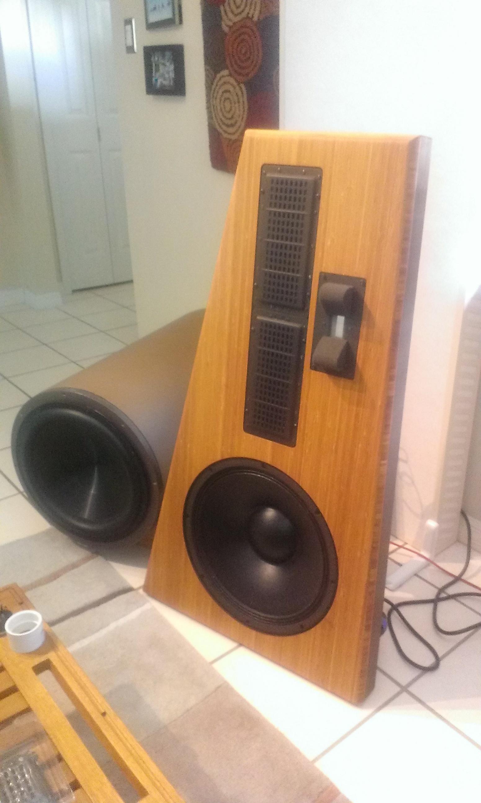

studiotech (member here) has used it in an OB as well (see pics)
http://www.diyaudio.com/forums/atta...idbass-18-subwoofer-large-box-ob-imag0080.jpg
http://www.diyaudio.com/forums/atta...1d1402241147-ultimate-ob-gallery-imag1237.jpg

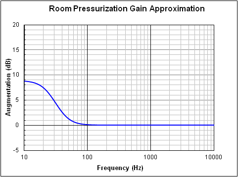

5db/octave over the octave from 40Hz down to 20Hz, is not possible unless the room is sealed AND rigid.
This can be the speaker but it can also be the room or source and receiver location if one or both are near a wall. Moving the speaker and listening position around should help gather information on the likely culprit/s.The issue with my current speakers is not so much the lack of bass as such (though it is lacking) but more the quality of the bass. It lacks control and 'definition'.

Now there is room gain but there are also cancellations due to the room modes. How best to account for those?
