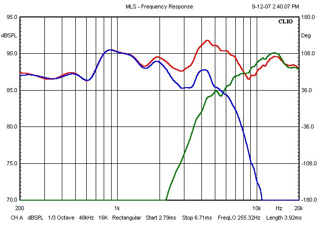

We had a look at the frequency response, and I do see the typical 4kHz cone resonance bump you would expect on a 6 or 8 inch polycone unit. But mainly I think a second or third order filter on the tweet would work much better. Not inconceivable you do a serial crossover either. Just indulge me and get some measurements here. 🙂

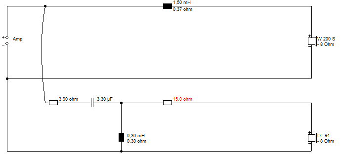

I'm listening to my old 8" bass Monitor Audio R300 with a mylar Visaton DT94 94mm tweeter at the moment. Thought I'd take a break from the cone tweeters.
Very simple filter, but very smooth indeed. Nice closed box bass. It's fun because you can fit almost any tweeter you like and it still works. 😎
I throw in some data for the similar Epos M12.2 which has unfiltered polycone bass and a 4.7uF cap on the metal tweeter, which is like what Karl his listening to right now.
