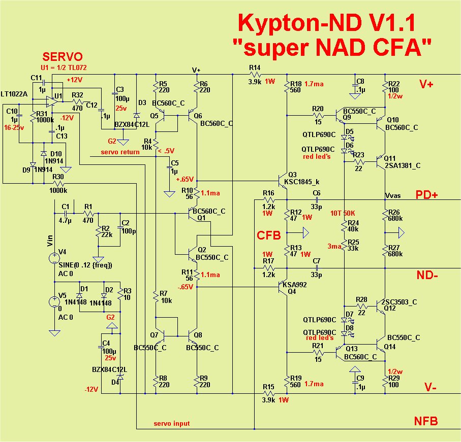

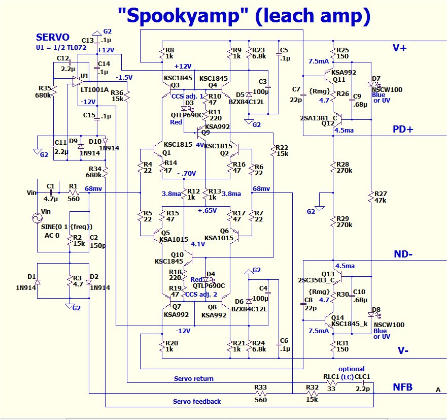

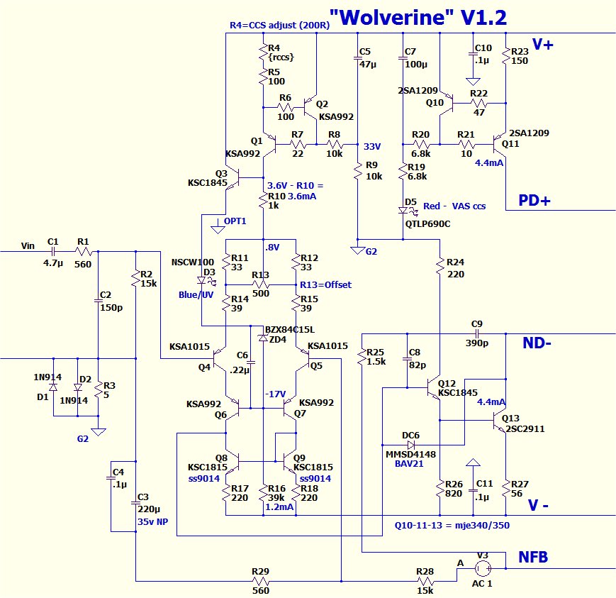

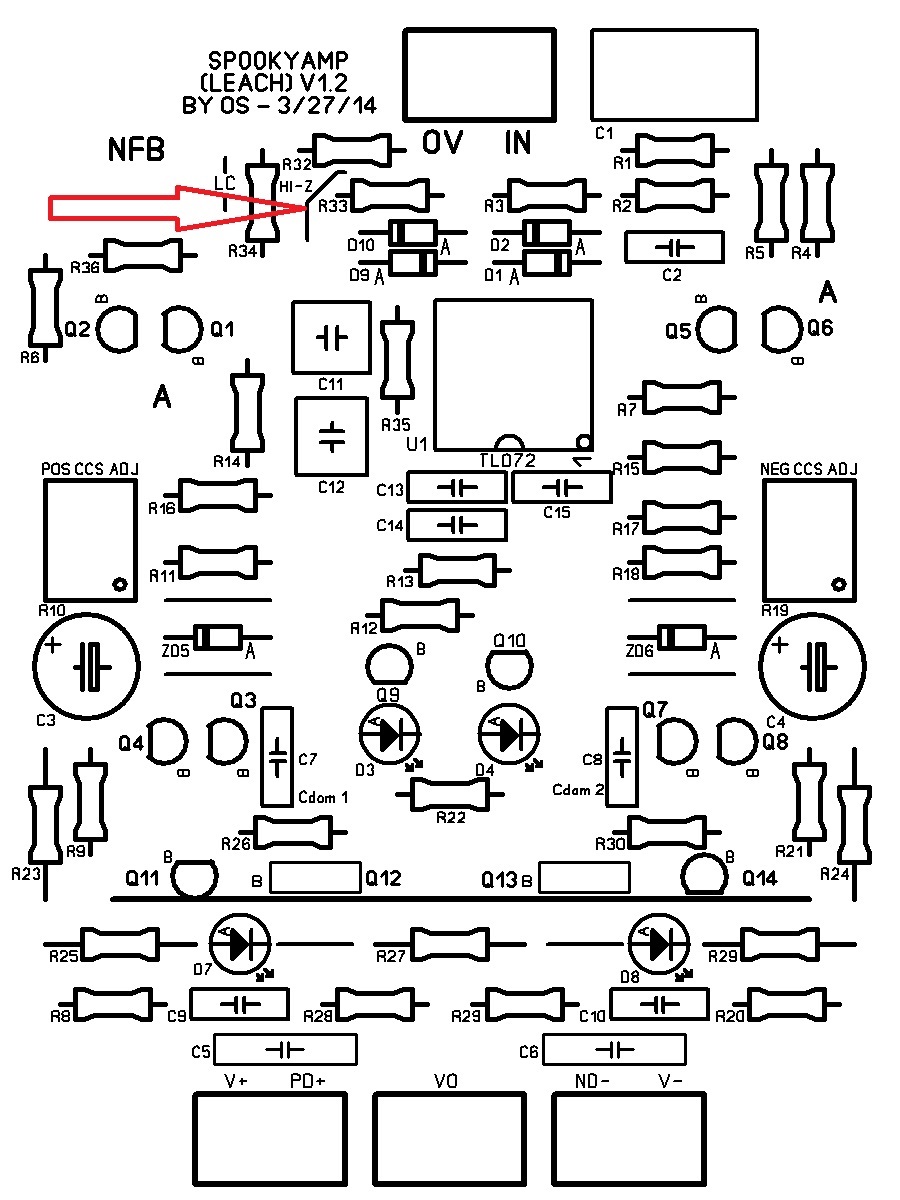

Here are the PDF files for the Spooky version that I built. Please note that it is a double sided board.
Hari
Here are the iron transfer files that I used to build the Wolverine, Spooky and Kypton ND.
On the Spooky/Leach there is one jumper that is not used. I have added the silk showing which jumper to leave off.
Good luck, Terry
Good luck, Terry

Thank you Hari and Terry for sharing the files.
Hope the spookyamp layout shared by both of you refers to V1.2.

Yes it is the V1.2.
Hari

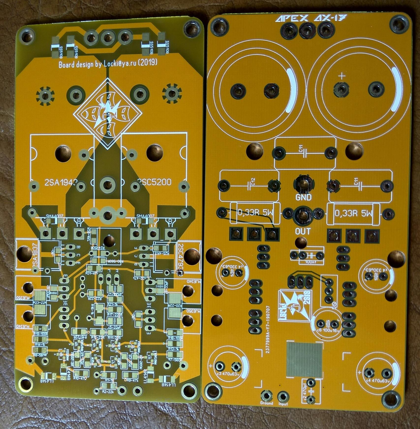

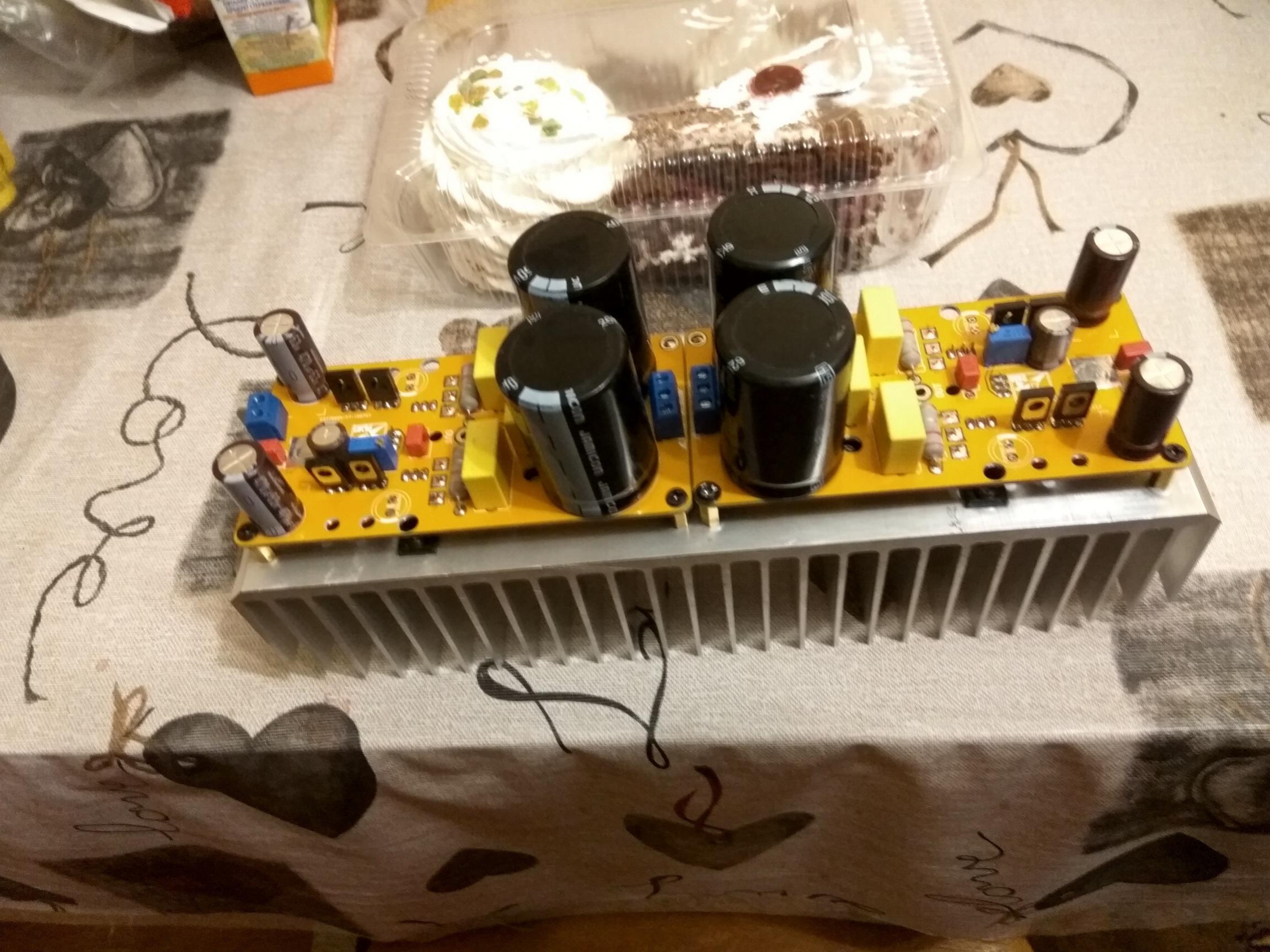

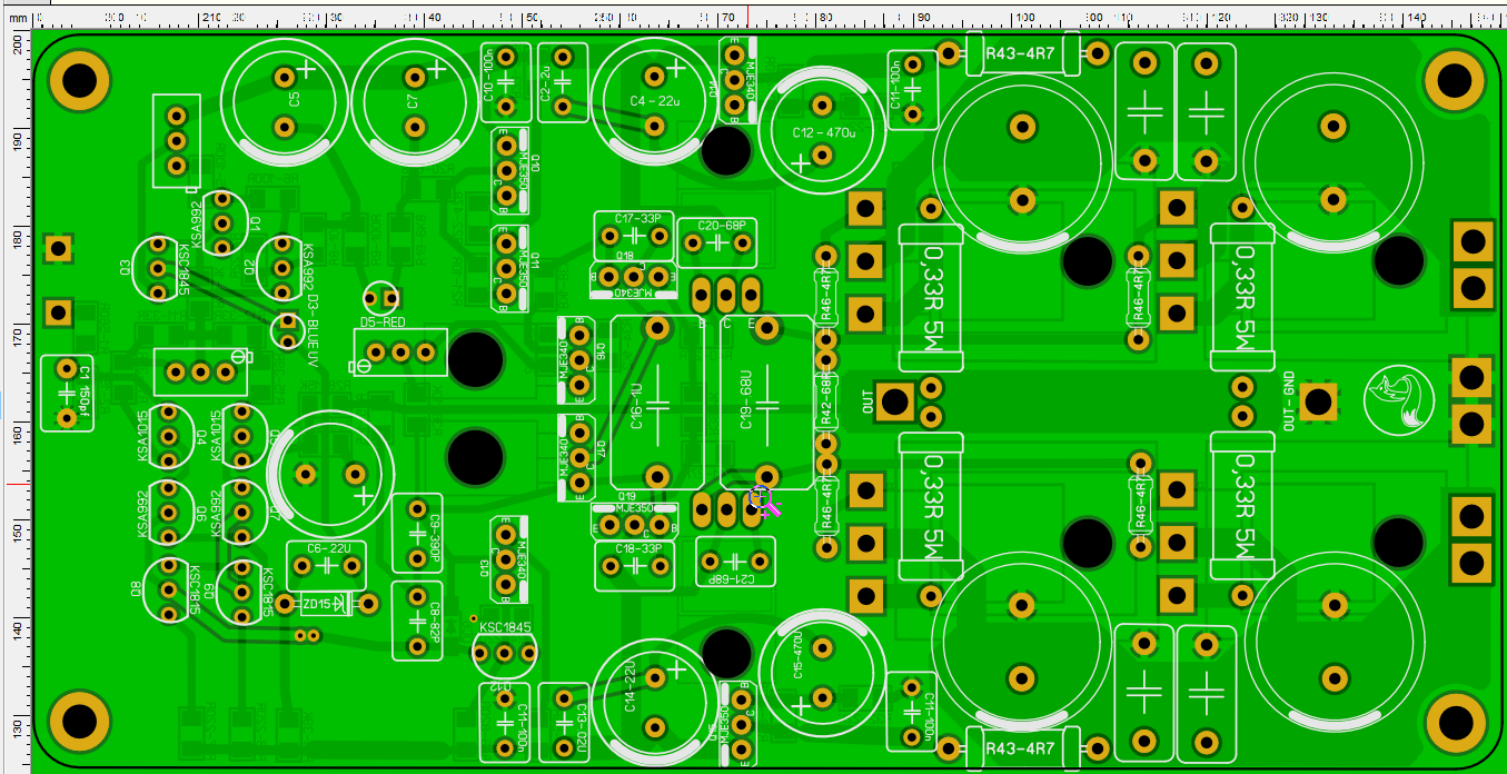

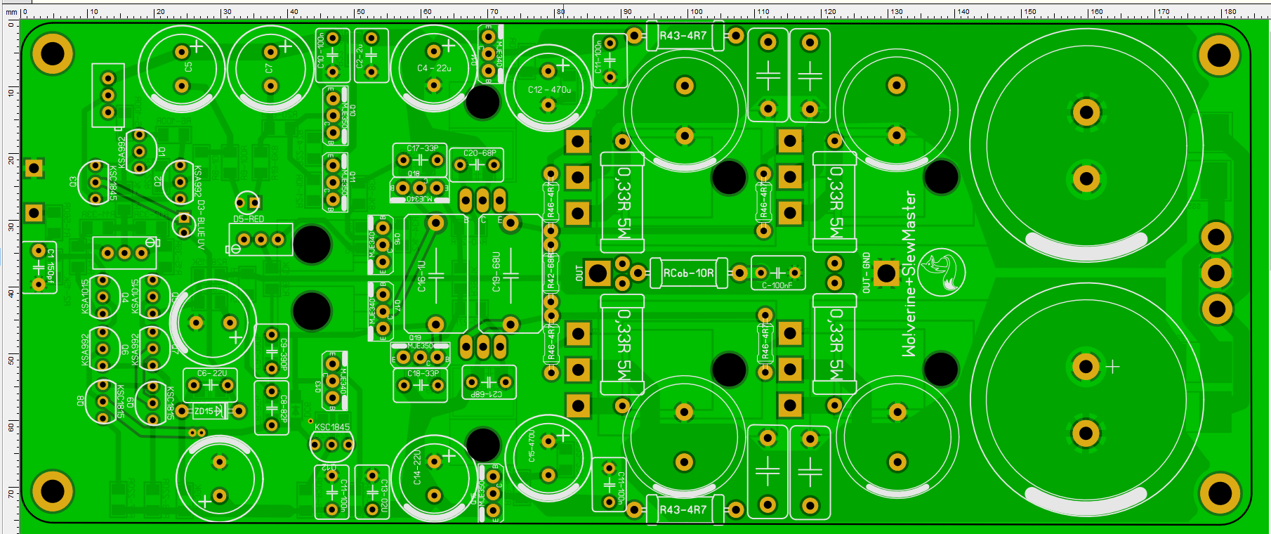

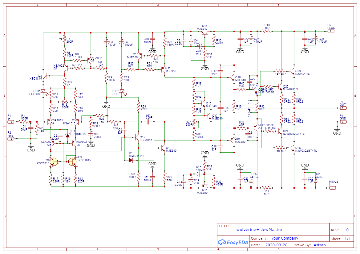

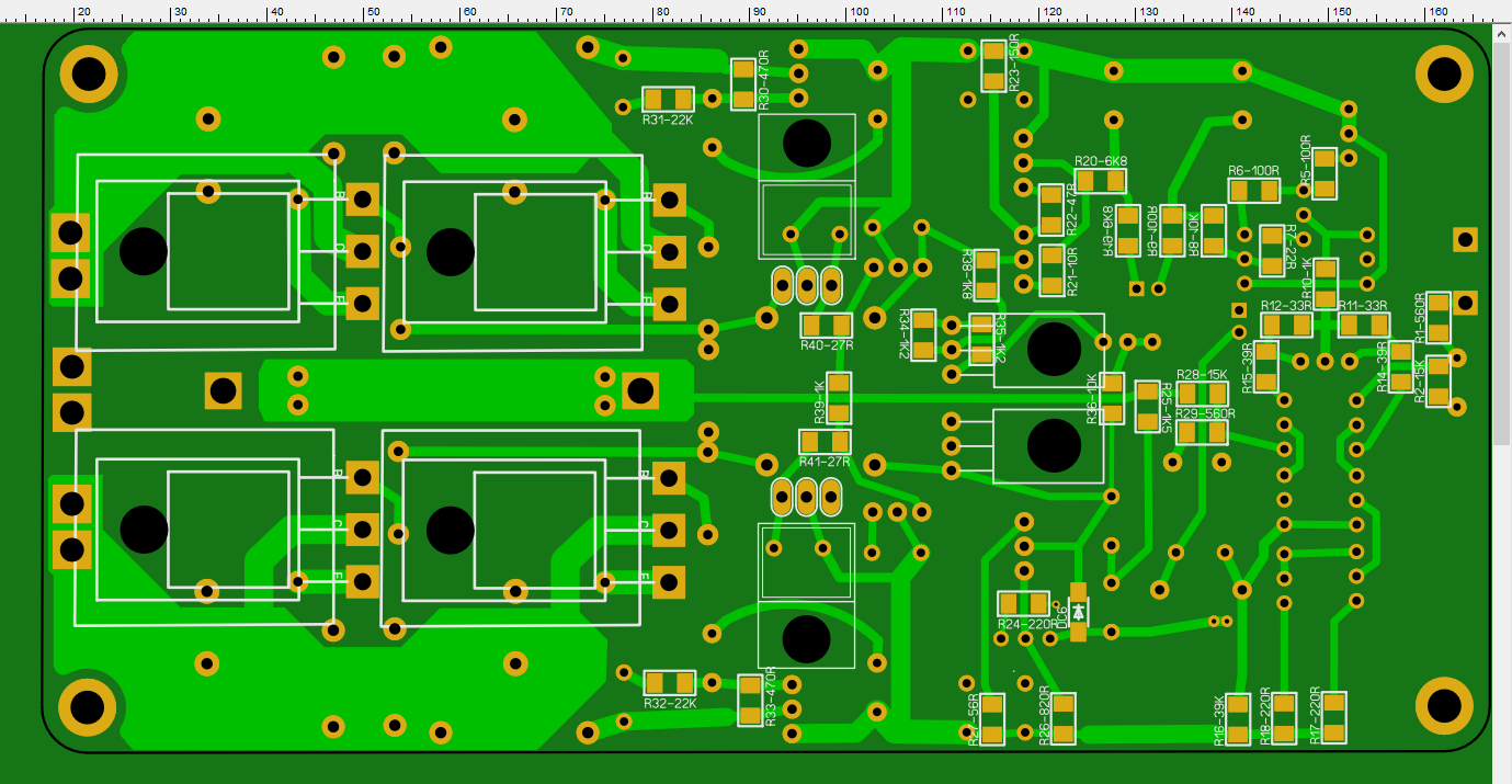

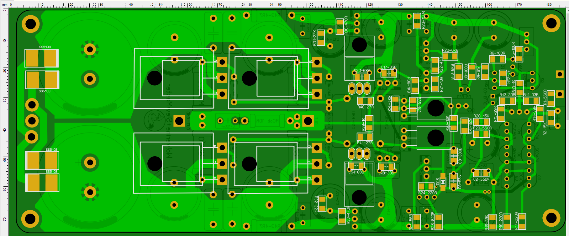

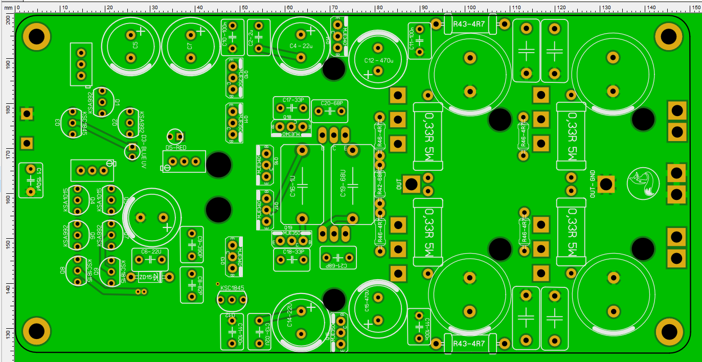

this is a good enough wiring wolverine+Sewmaster or I need to twist the details
On one Board made because of one transformer, I'm afraid that otherwise there will be a low-frequency background hum
what ultimately the better amplifier - The "Honey Badger" or Wolverine+SlewМaster
why, if the earth is the whole layer and everything on the board is wired correctlyNo lifted ground on the input?
It's uses are:
To prevent possible ground loops from the source.
To prevent possible ground loops within the amp.
It may lower the ground noise.
Unless you have a prototype board you will not know if you will have the above problems.
Hope that helps.
PS you can always put in a wire link, later, instead of the resistor.
Most preamps or other sources will use a common ground for both channels. If you are building a stereo amplifier that has the power supply grounds connected together it will set you up for ground loop issues. The diodes and resistor of the ground loop will stop current flow through the interconnect cable screens. The few ohms resistance added to the input impedance are really irrelevant. Cheap insurance.

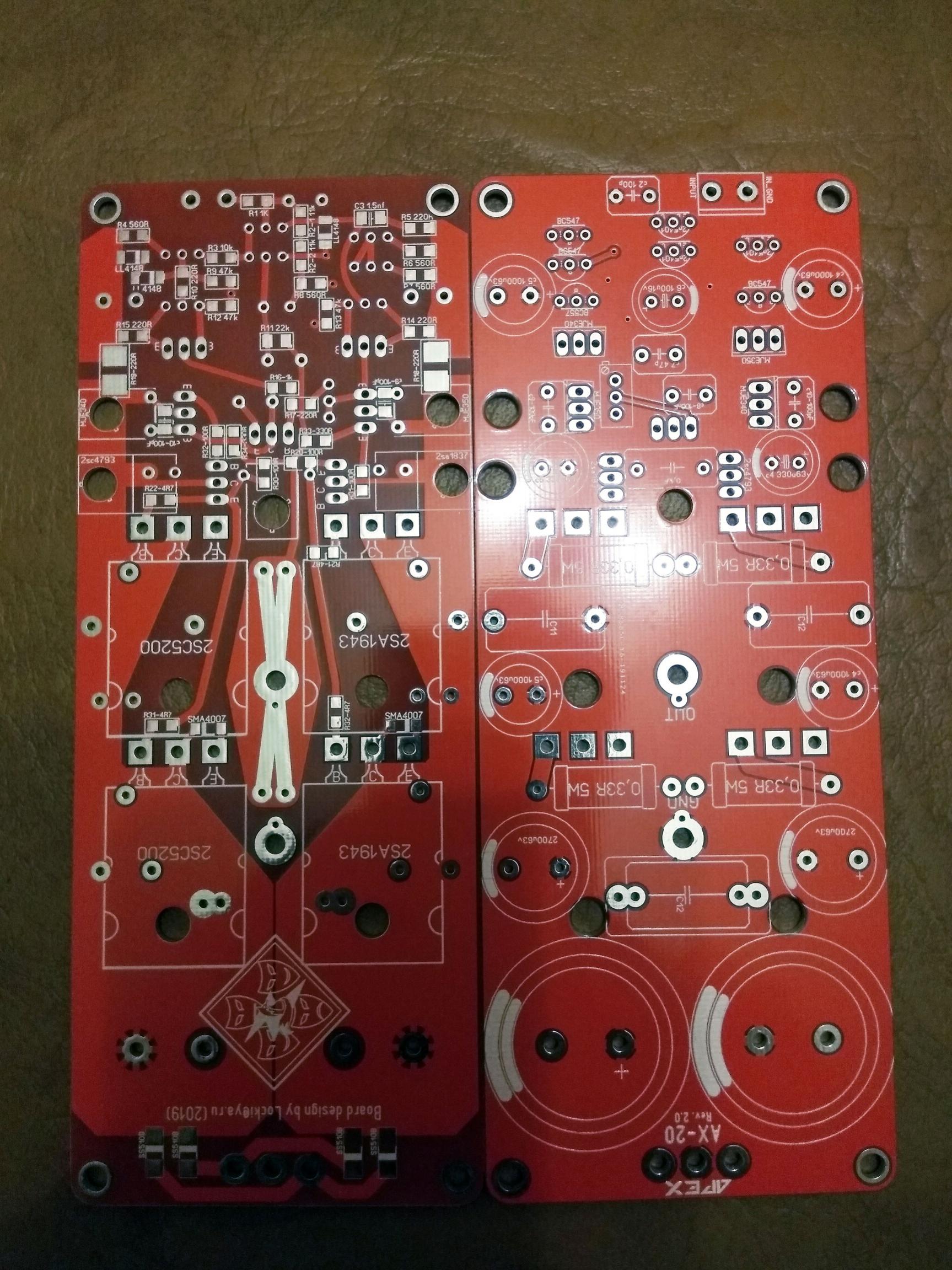

well, i can always connect the ground of this Board (which is laid out earlier) to the power supply Board by resistors in 5-10 ohms
But on the boards apex-14,17 and 20, that already collected and listened to it was not necessary.
