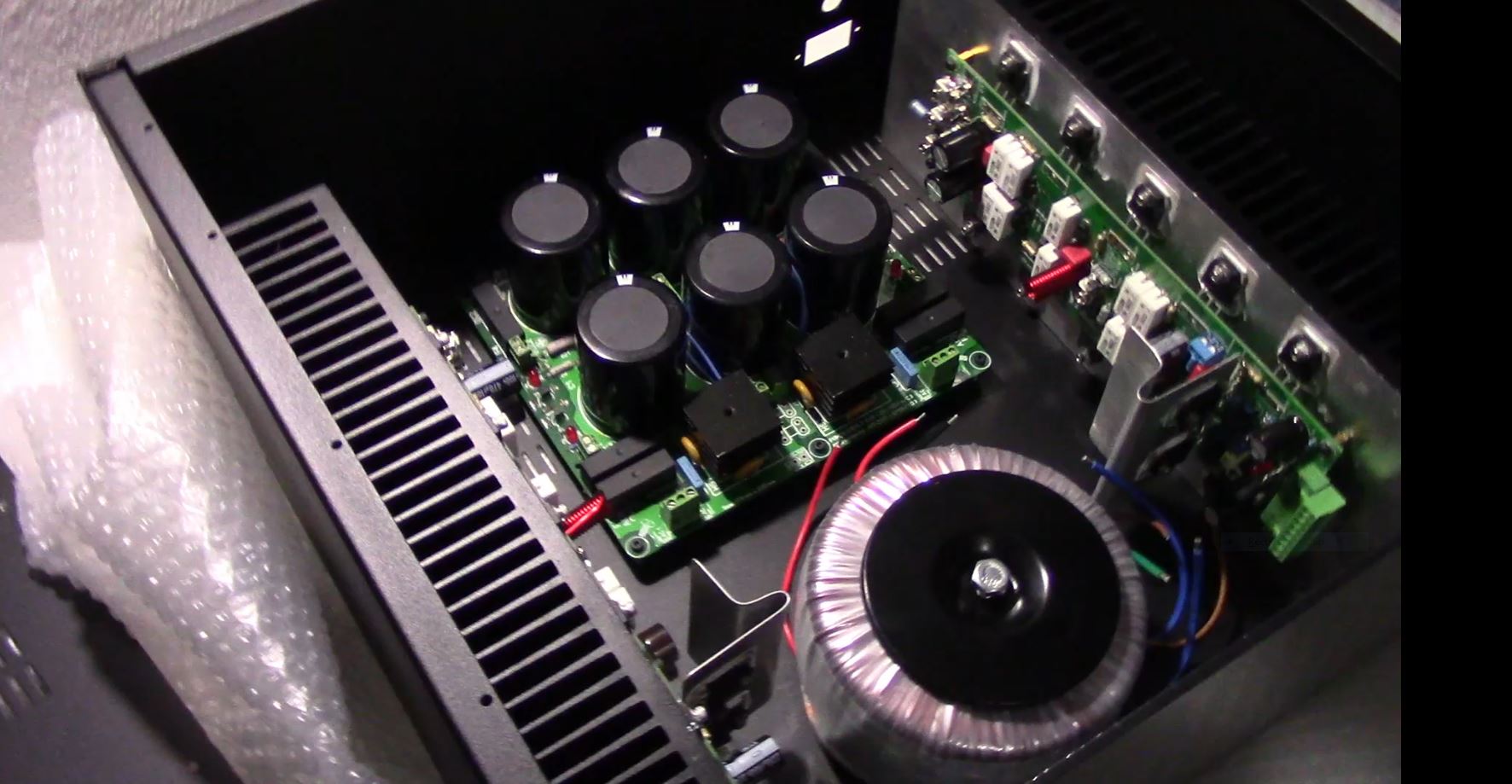

hi thimios hey you saw my build of the slewmaster? I still got a few more thing to go so it be completed after so many years now I can say I got something 😛
Beautiful work
thank you sadly I can not order the control board but at least I got must of the parts I can wait no problem 🙂

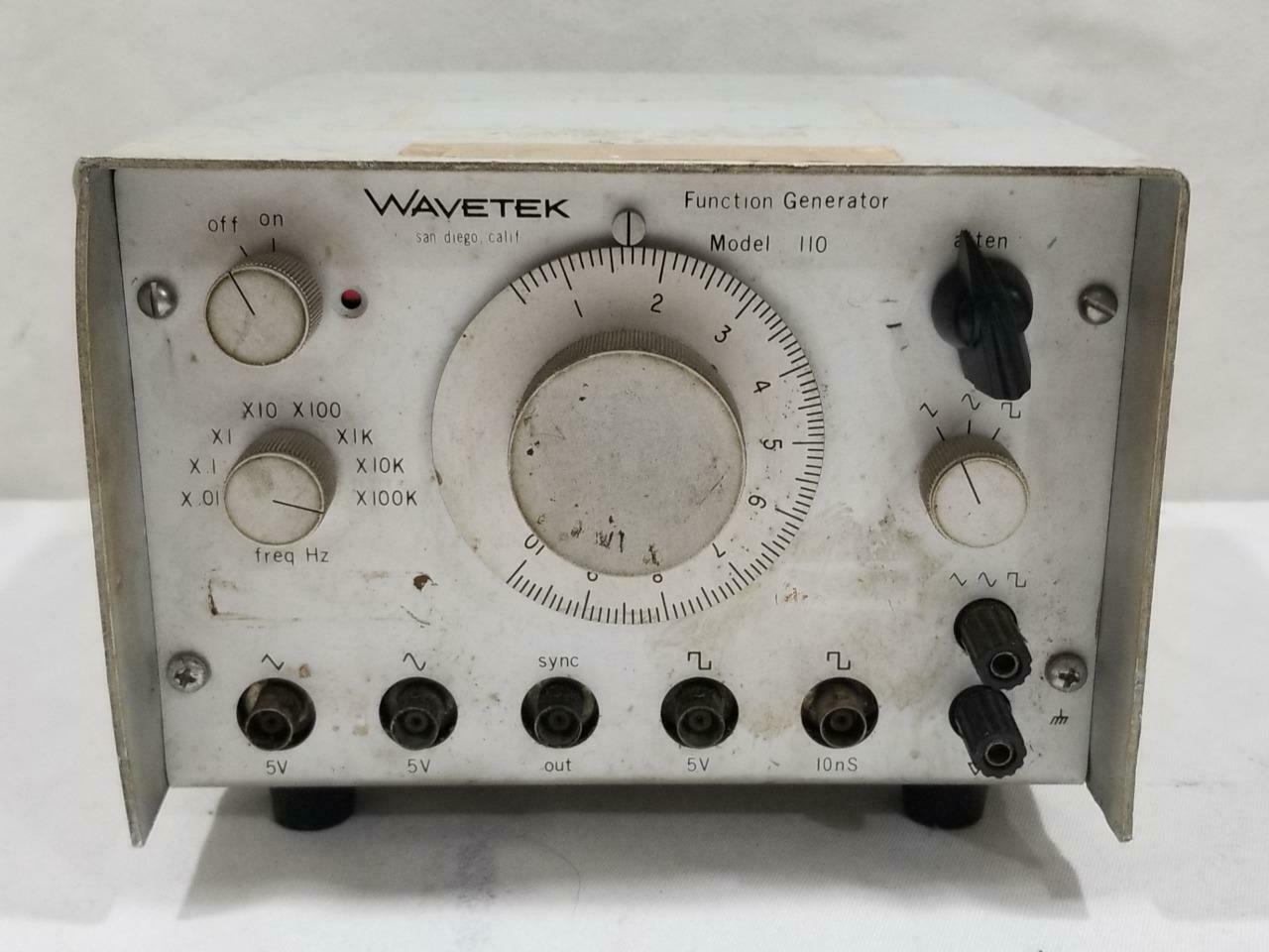

Wavetek Function Generator Model 110

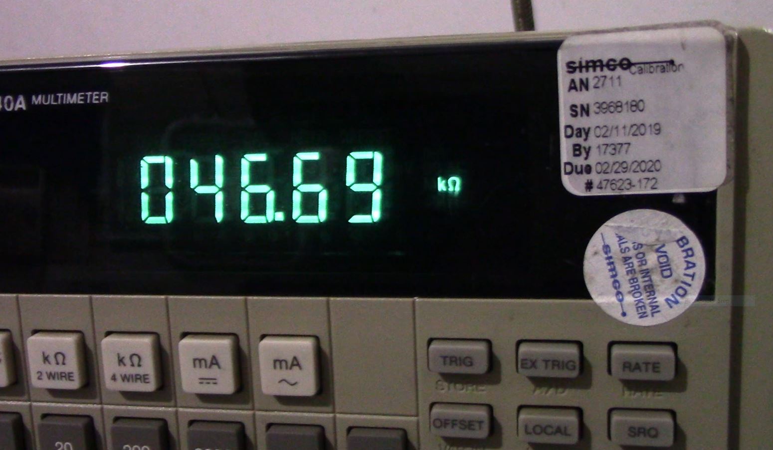

hi guys I already begin to purchase better test tools for my hobbies and I thinking to get me a vintage function generator will this be okay to just do simple 1KHz some wave test? I already purchase a DMM Fluke 8840A 5.5 digits to just get better reading on my resistors
okay back to the function generator this is the one I know that it might not work but I'm more interested in something rugged that I can use for many years or let me know what is the best choice here is the unit picture Stuart told me about those cheap ones from EBay but they have some distortions I saw many videos about them
I ask first before I made a mistake here

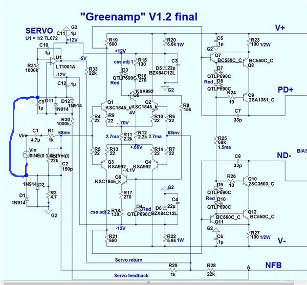

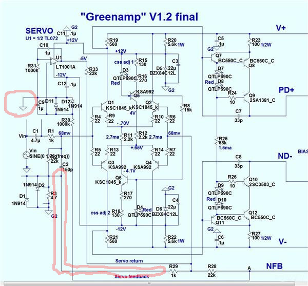

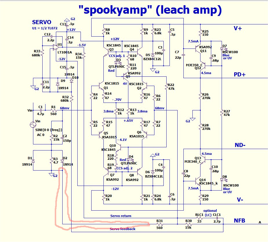

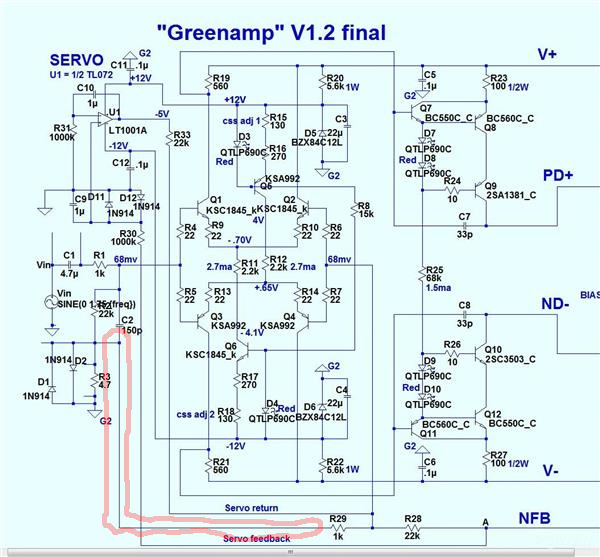

reference for feedback
I'am not sure at which position I should connect the reference for the feedback. There are two versions in different schematics:
1. In the Greenamp at ground of the Input (above the anti humm resistor R3)
2. In the Spooky at ground of the whole amp (G2)
Which one is right and why?
regards, Chris

Hi Ampi,
I believe there is a mistake int the Spooky schematic.
The right reference point for the feedback network is the "signal ground" above the "anti-hum" resistor - as shown in the Greenamp schematic.
Valery

Servo setup is the following - as you need to keep zero DC across the speaker, and the speaker is connected to the "main" ground - you connect the servo's input reference to the main groung.
Now, if you've got a simple RC filter at the output of the servo (good practice, some 100R in series and 0.1uF to ground), then you connect the "bottom" side of this filter capacitor to the "signal ground".

That's correct. That's how the Spooky amp measured best.

Hi valery and jwilhelm,
I made a simple grafik with your advice. Is this right now?
Wat is the background of the RC-Filter, is it against HF-oscillation?
We have a low pass filter R31, C9
C10 makes U1 an integrator stage.
The servo therefore only works at or near DC to correct long term drift.
If the servo received audio it would be akin to a dog chasing its tail!
Keith

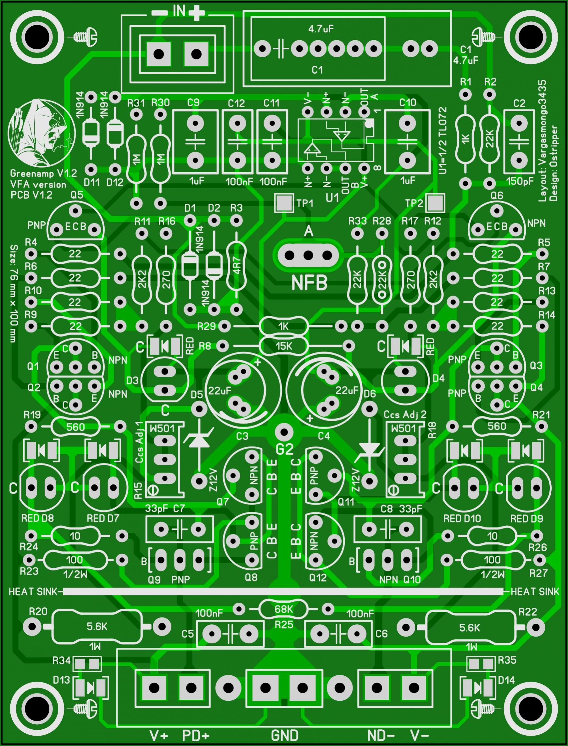

I'm not expert PCB designer but the Greenamp I made it just like the schematic said and I didn't have any problems at all I got the gerber files if you want it to try out the sounds is really good
they are two options of LED regular ones or SMD LED
