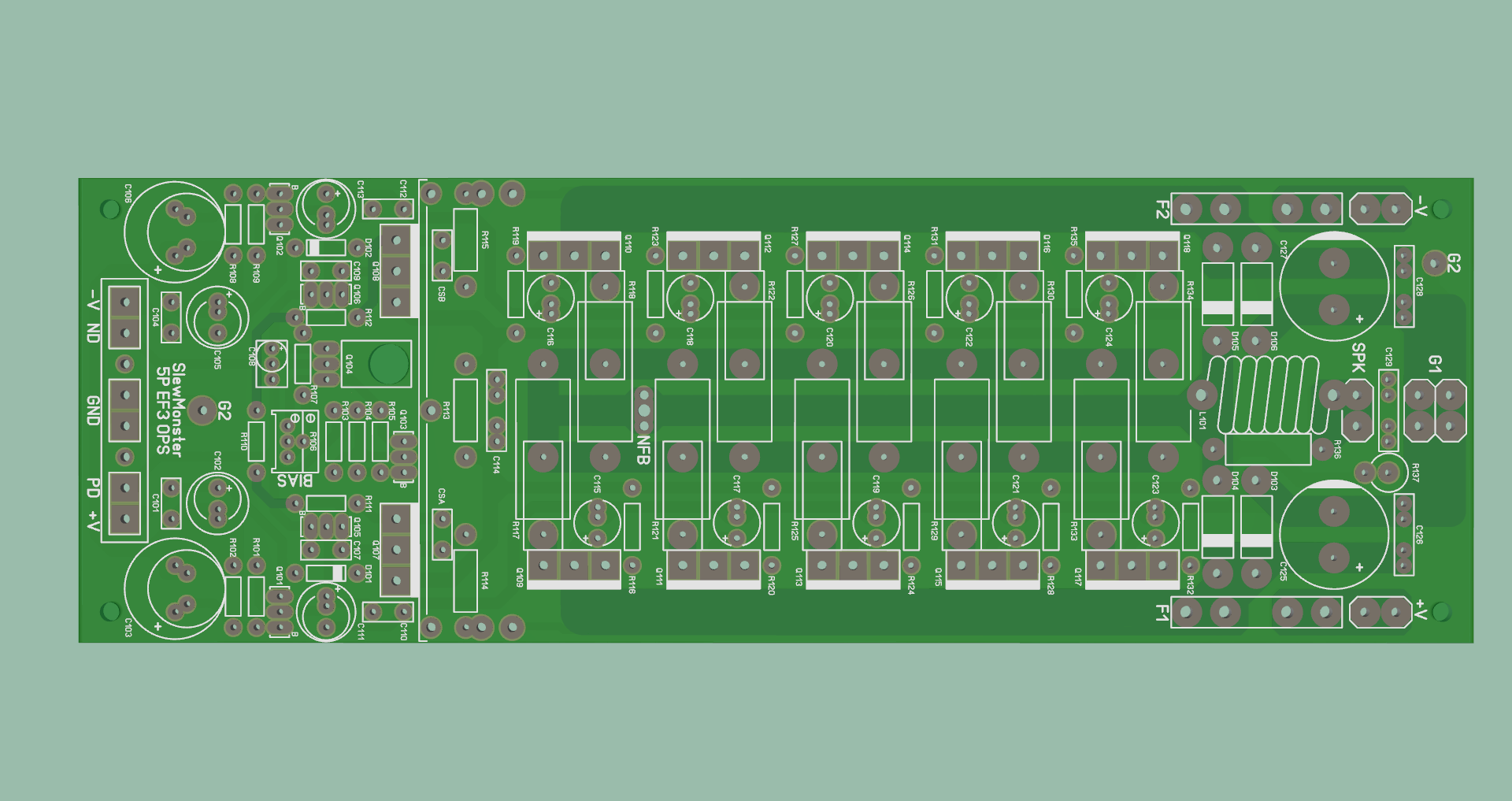

hi Thimios is 125mm x 300mm I just posted here just in case I might lose the file or anything can happen, I spend many hours on this and here is a best save place if I need it is here on diyaudio.com
hello friend, would you have the gerber of this board with 5 pairs? can I use NJW21193 / NJW21194 transistors IN THE PLACE OF MJL / IRFP?

I would not use those power transistors. If you search back through the thread you will see where I tried to use MJL21193/21194 resistors. For some reason the slower transistors don't play nice in this EF3 circuit.
they are slow devices Terry? I didn't know that ok ok edu on must of my build I use this one https://www.onsemi.com/pub/Collateral/MJL3281A-D.PDF
I will test, because I have several pairs here. What problems did you have?
I am just trying to save you trouble. I tried several things to try and make them work. All ended in burned devices. You are welcome to travel down the same rabbit hole if you like or save yourself the trouble and use devices that are proven.
Blessings, Terry
