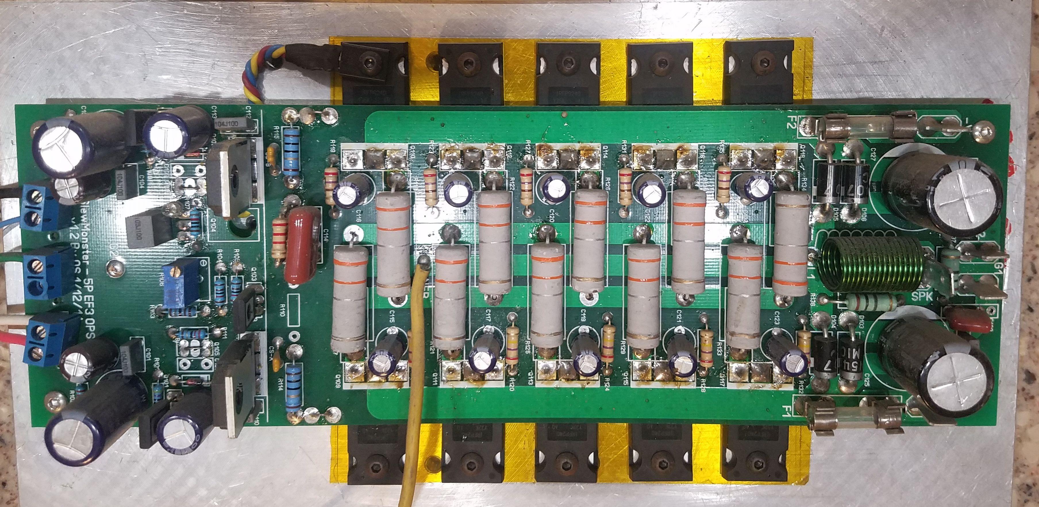

Here is a picture of mine. It is not the Arcwelder but the parts are the same.
congratulations on the assembly, know how to inform me if I can use NJW0281G (NPN)
NJW0302G (PNP) both 30mhz
in place of mjl / irfp?
Yes you can, i had used this combination too.

You can use two pairs only, if you will use lower power supply.
Even one pair per chanel it's enough for +/-35V if 8 ohm speaker will be used.
Some resistors need trimming for lower voltage.

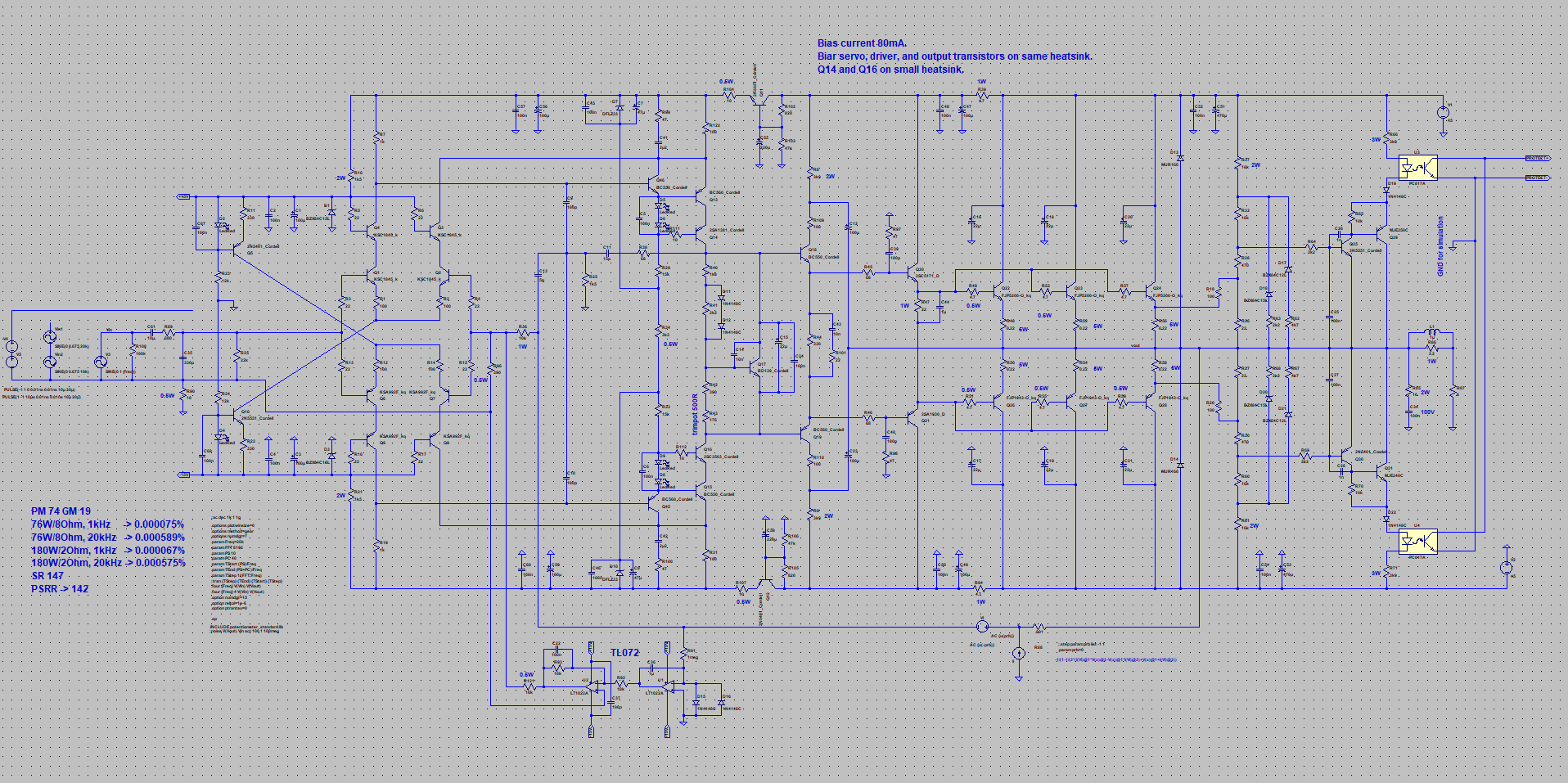

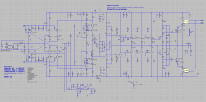

I have many design which I share to local audio community, but design usually simple with easy to find transistors. PCB layout made by others.
I also made design for a friend with high slew rate and low distortion. Usually, the main problem is PCB layout. One of my amplifier used in a house close to 2 radio transceiver and have RF interference. But it solved now. Recently, I made small class A, and it have small oscillation around 20MHz.
I think it already many design here. But I will consider your request.
After I designed Pelatuk OITPC VMOS which tested by Thimios, now I design symmetric topology with OITPC compensation.
Target of this design is:
- high enough slew rate
- low enough distortion
- high PSRR
- simple as possible
This amplifier can drive 2 ohm load impedance and have SOA protection which it can seen it one my picture. SOA protection is active low (activated when saturated).
