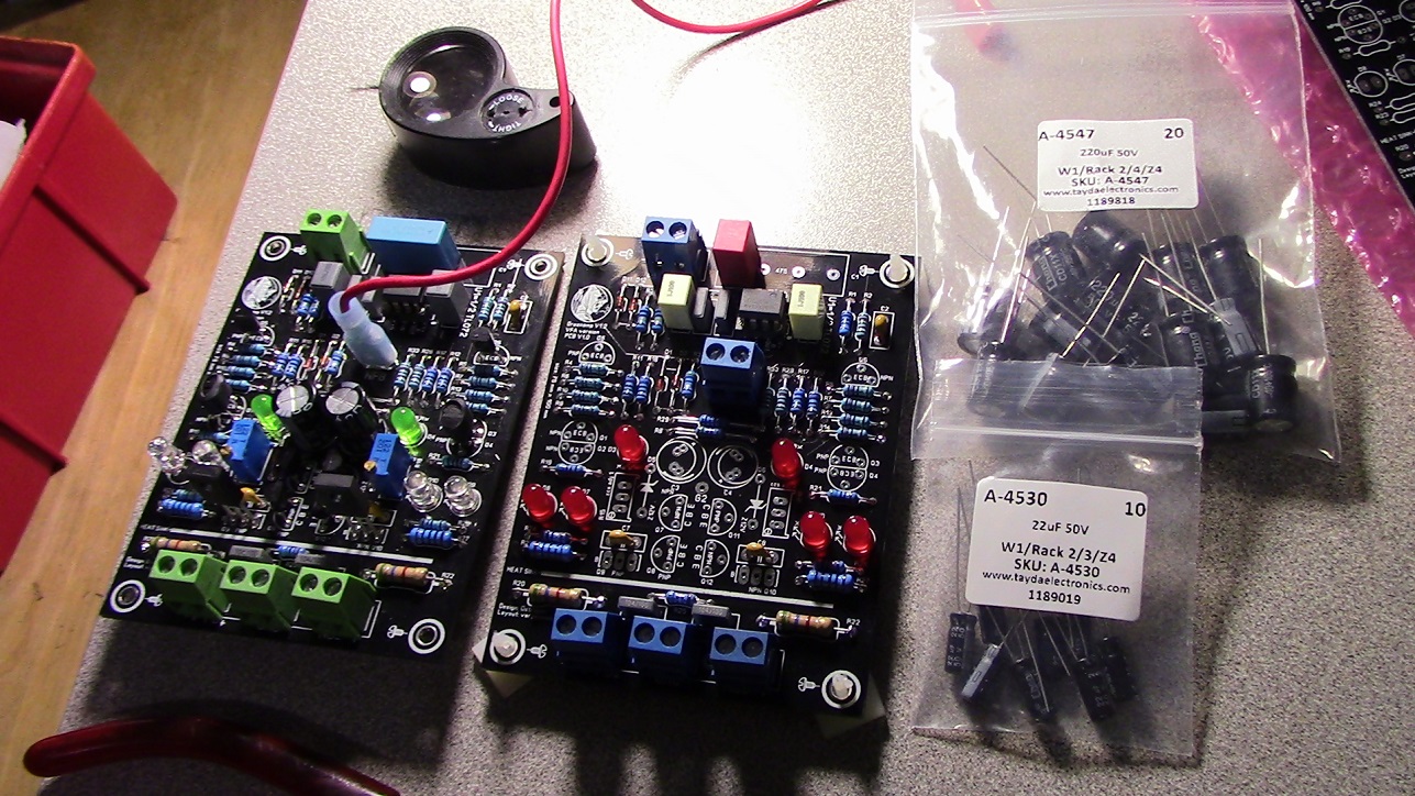

Hi vargas,I'm not expert PCB designer but the Greenamp I made it just like the schematic said and I didn't have any problems at all I got the gerber files if you want it to try out the sounds is really good
they are two options of LED regular ones or SMD LED

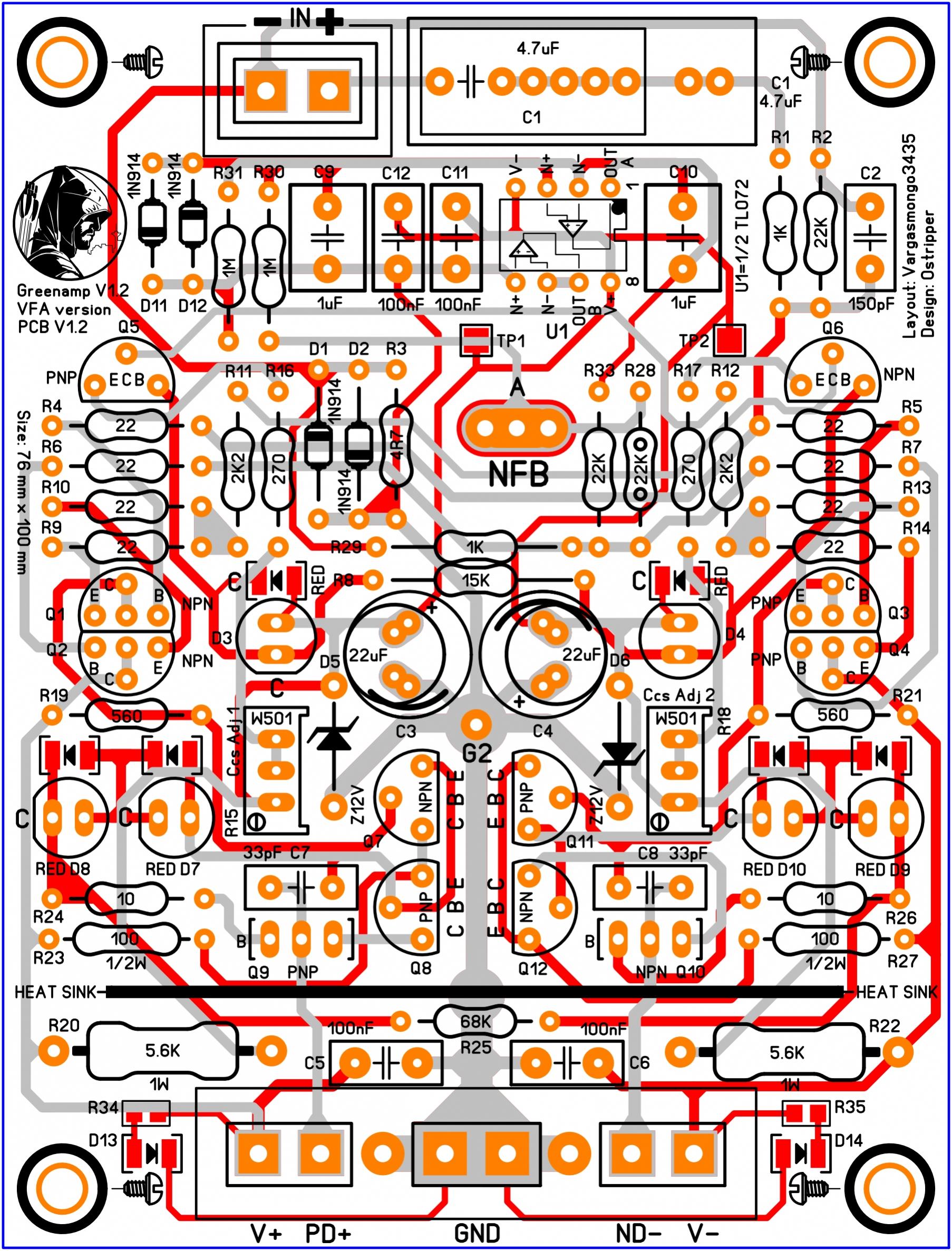

I'am on the way to design my own layout, more compact, with SMD but also THT. Goal is to put the IPS on a 50mmx100mm Board. The CFA is almost finished. But I get inspired of your board. The next one will be the greanamp. So I'am able to compare VFA/CFA. The IPS is connected to the OPS by a pin header. Similar to Valerys NS board, but my board is fixed in 90° and not parallel. I use KiCad for design - because it is open source. Hope my plan will lead to a functioning Amp 😉.

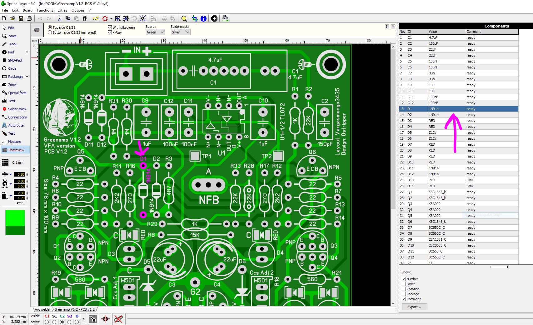

awesome Ampi oh with pin headers? cool of course is gonna work just take your time and do re-check over and over what I do I play American 80's music and look at the layout and schematic till I don't see any bugs so far works well for me 🙂 but I also learn to identified all components on Sprint Layout 6 and that does help a lot ok bro good luck with your project

.lay for sprint , some of the IPS coppers , prints.
With sprint 6 , spooky V1.2 can be sent to a printer.

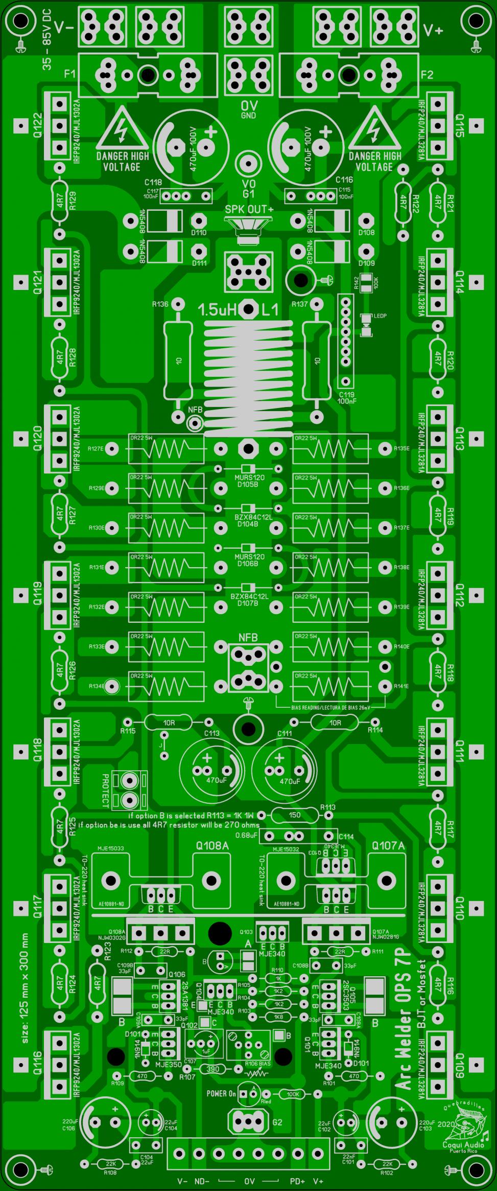

One zip is ALL the simulations + models.
The second is ALL the layout files for OPS/IPS.

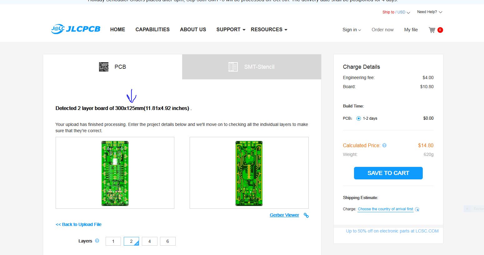

hi Thimios is 125mm x 300mm I just posted here just in case I might lose the file or anything can happen, I spend many hours on this and here is a best save place if I need it is here on diyaudio.com 🙂

Greenamp PCB V1.2
sure bro here 🙂
Greenamp zip has the gerbers
the LED's you can use regular ones or SMD type 😉

Did you do the OPS also? With dual transformers or single? Excellent work from you as per usual. Outstanding, Thanks
I think it depends, a single one 800VA or more VA's I do not know any toroidal transformer online store but this one Antek AN-8445 - 800VA 45V Transformer - AnTek Products Corp
