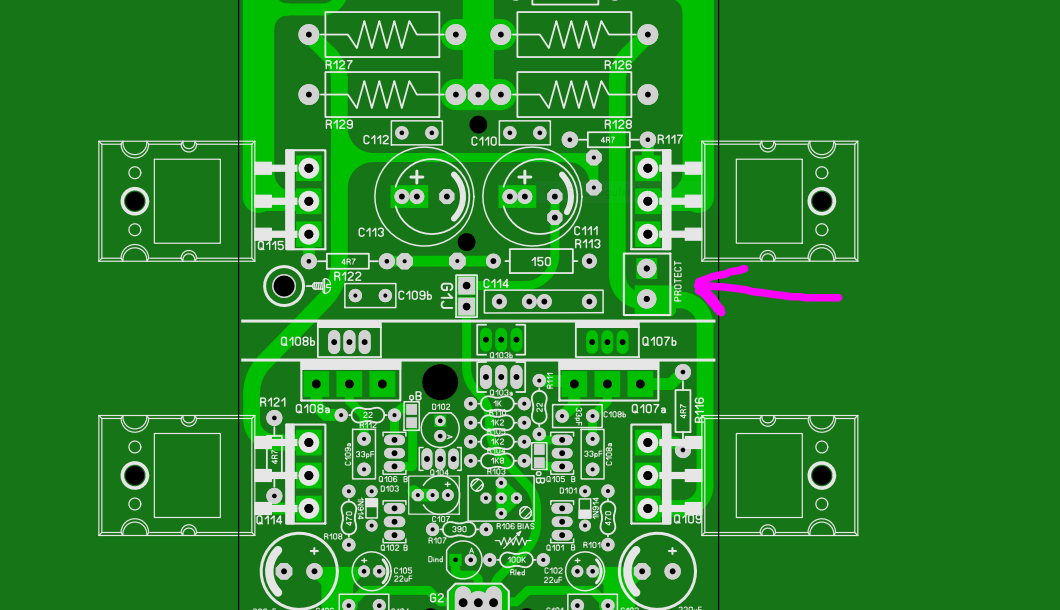

That was to interface with the 21st century protection system. How to build a 21st century protection boardhi guys I can not find a section thread about the protect that goes on latest version of the Arc welder V2 the circuit that goes here connected on this illustration
thank you I'll check that it was a long time ago I forgot 😛
