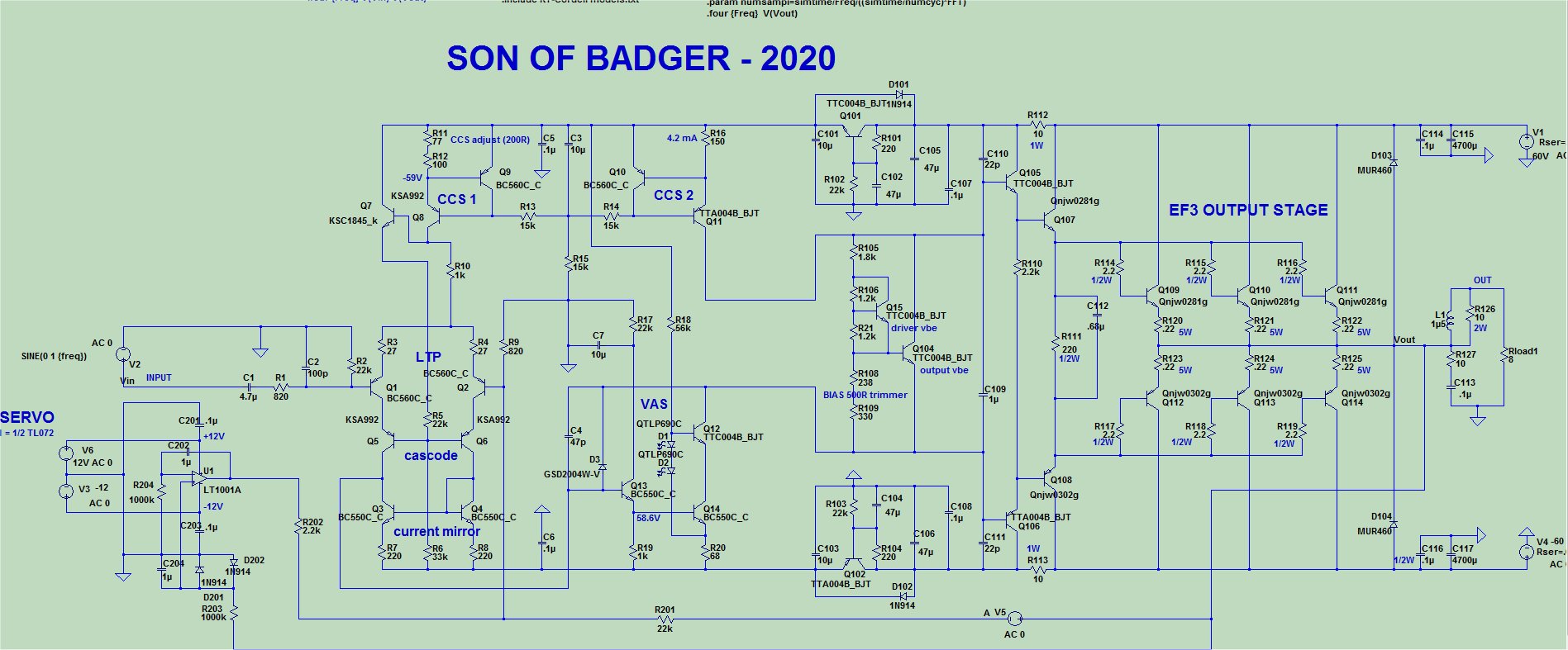

Which version of the slewmaster is better distortion wise the EF3 or the Arc Welder edition? What is the difference?
All are EF3.
The smaller 2/3 pair versions would most likely have more distortion with
2/4R loads because of current limitations.
The "arc welder" had massive 20A traces/5 pair , hence the name. At >10A+,
just the layout could increase/decrease THD.
Otherwise , all versions are identical.

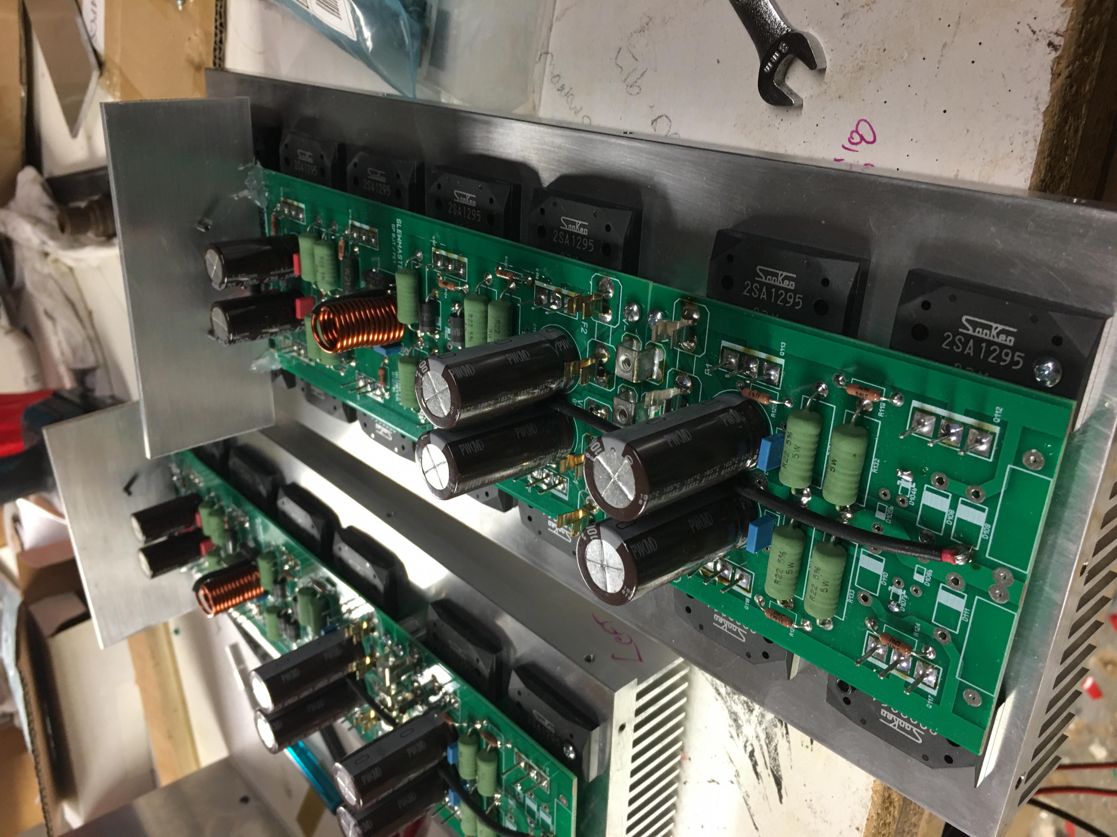

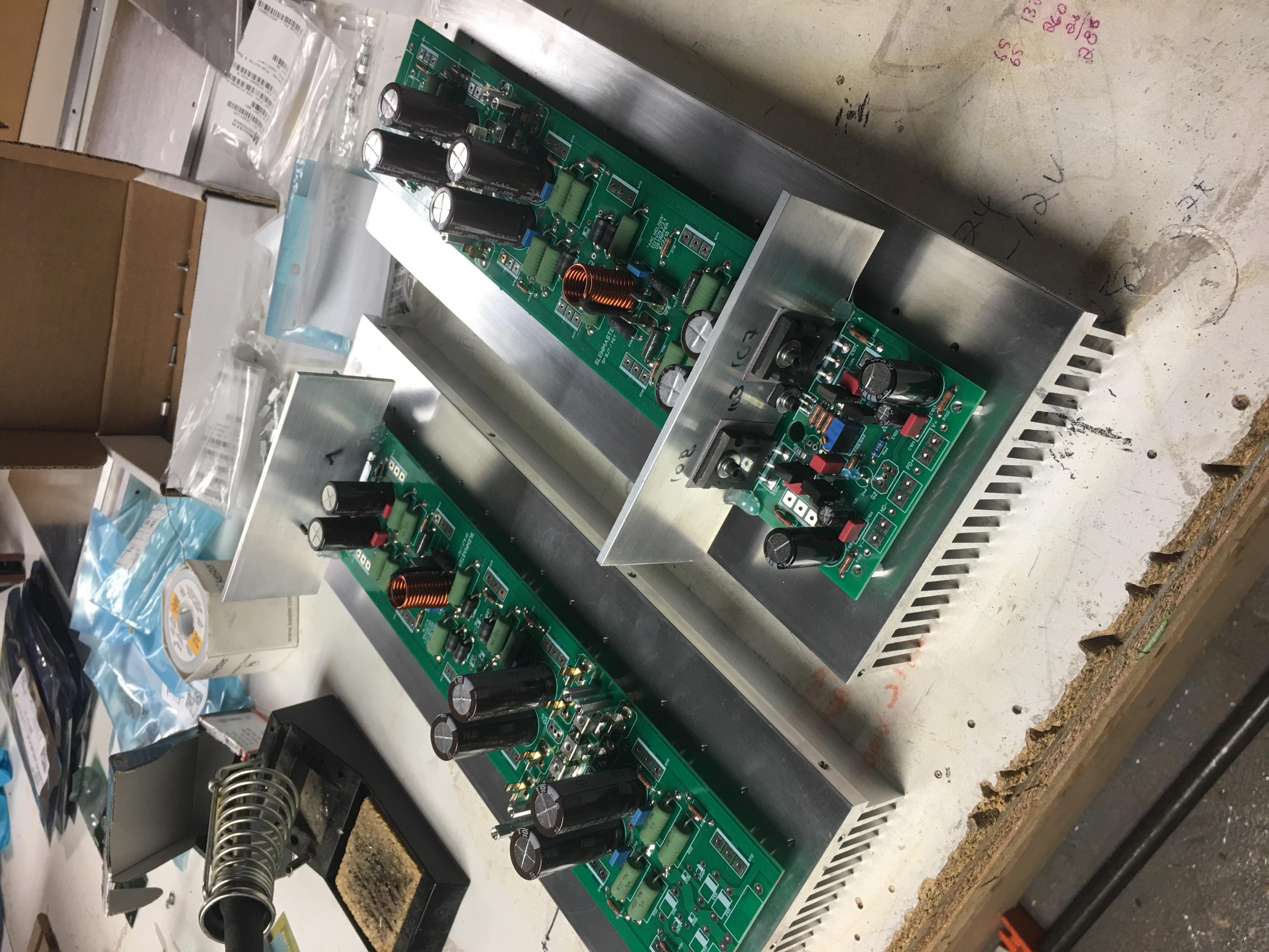

Van I use 7 pairs? I have a big 5U case from modushop and I want to make more use of those big heatsinks. I already have NJW0281 and 0302
You could use 10 pairs !
I did a 7 pair version recently +\- 86 vdc rails.
Wow, Holy Smokes!! What IPS did you use?
Spooky. The only smoke was from the 200 watt dummy load resistor.
i dip my dummy loads in a tub full of water, steam can be seen rising...
Nice work evanc!
Can you share gerbers for this Monster?
Thanks.
Thimios
Thimios,

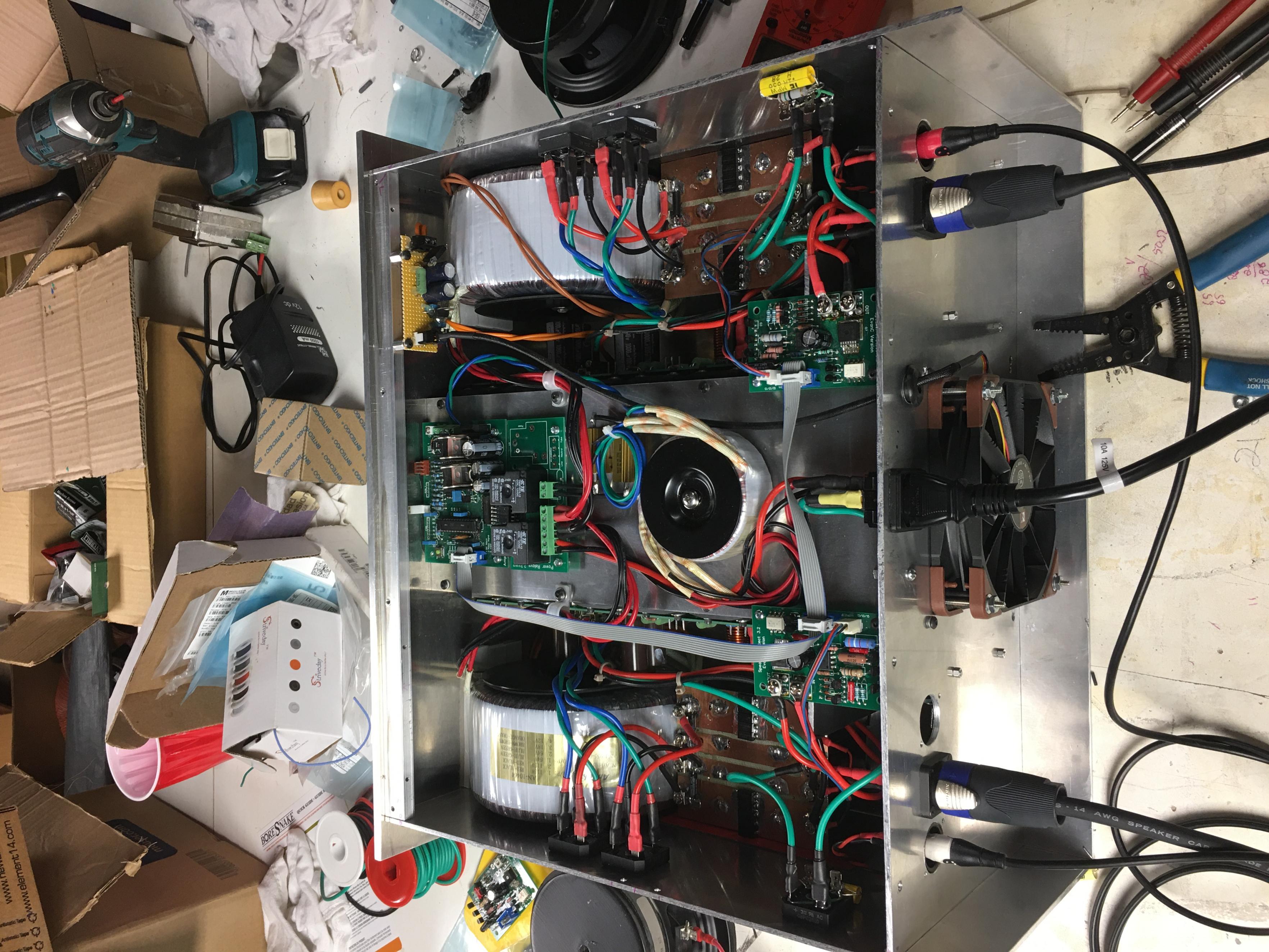

Hello my friend. For this amp I used two arc welder boards per channel. I cut one off to add two more pair of outputs to the standard five pair board.
Harry,
Yes, the two heat sinks make a tunnel with the fan in the back and the vent in the front.
Harry,
