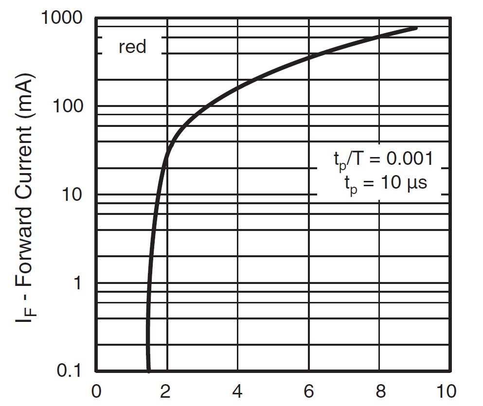

Q5/7 CCS's - depending on what RED LED you have and the real world properties of the semi's , the target
is 1.5ma current. This will set the IPS to optimum so that you can trim VAS I (R17) to 4.25ma.
Newer RED LED's have as much as 1.8 - 1.9 Vf old dim red's GaAs have 1.6 - 1.7 Vf , CCS Re has to increase
for newer red's.

I found a nice red LED, with very low internal impedance, even with low current. It has approx. 1,7V Vf at 2mA, and approx.1,65V at 0,5mA.

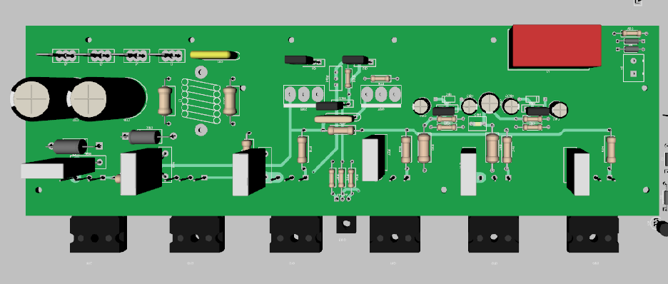

I have a couple versions of the new Honeybadger half done. The UMS layout isn't great for layouts on larger amps! It looks like it'll need a plug in input board just to allow enough space to fit everything. A two row output stage like the Slewmaster used looks a lot better than the previous single row layout.

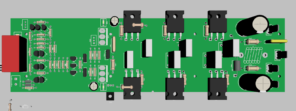

I just emailed Jason , could we have something to show ? Please include
all (of us) in the layout.
That is surprising about space , the current Badger PCB is so spread out.
I also needs a VAS HS. This design could be much more dense. 3 pair
outputs could even be driven by a pair of to3p drivers face to face with
the driver Vbe in-between to-3p's or to-220's (below - HK680).
A small plate or PCB mounted HS with Q103/107/108 would be nice.
The reason for the Slewmaster large driver plate is overkill factor (for EvanC
"manly" monster amps.

I don't have all of the right 3D models loaded yet. The Slewmaster style layout still needs the servo, servo regulators and the cap multipliers placed. It might fit but it'll be ugly! The screw holes limit the board to around 2 3/4" wide so it's pretty slim.
The screw hole locations aren't playing out well in the Badger version. If we want to screw off the driver heat sink they need to be in the middle of the board killing a lot of space.

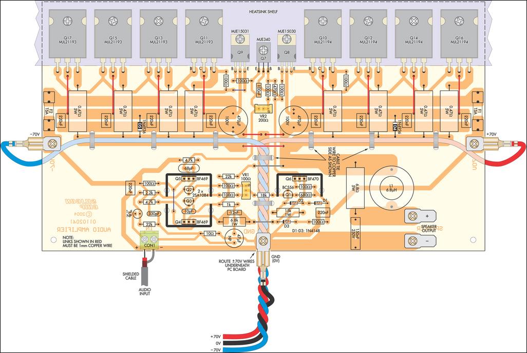

Here is a good template for power layout. One could do what they do with
the wires by using fat traces on the double sided board (below). Onboard
decoupling caps just have to be 470u/ 80V. Most use the DIYA store big cap bank PCB.
Caps and power traces in the middle.
Actually , twisting those wires together under the board is a killer idea .
Rail ripple would be totally cancelled.

The wire routing is a great idea! Having power connections at opposite sides of the boards is begging to have the wires all over the place. The tie wrap holes fix that here though.
I try to bring both power leads to the board close together forcing the builder to run the power leads fairly close together. I like to run the two power planes on top of each other so they cancel their emissions too.

I’m trying to visualise and understand this. Sorry if I don’t get it.
The twisted wires will cancel the ripple…. OK I see that.
However since the audio signal is asymmetrical, not a sine wave, the power demand on one wire could be more than the other (using positive and negative rails).
Can the transient demand in one wire cause induced “interference” into the other wire or am I looking at it in the wrong way?
Ripple voltage on the supplies will be almost totally unaffected. The main thing is reducing the physical loop area of the supply currents. The area of the current loop determines the amount of magnetic coupling to other traces.
On some boards the loop area is practically the whole size of the PCB because the rails are routed on the outer edge of the board.
