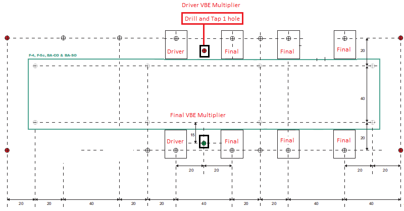

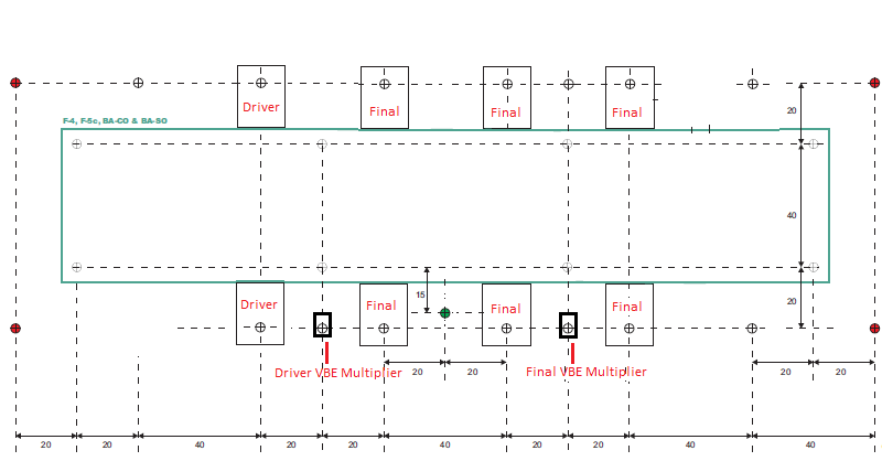

Is the plan to use the UMS Heatsink drill pattern for mounting pcb/transistors in the diyAudio store?
One could swap boards between the two designs on the same heatsink quickly without having to re-drill/re-tap a bunch of holes.
I'm trying to fit it into the UMS pattern.

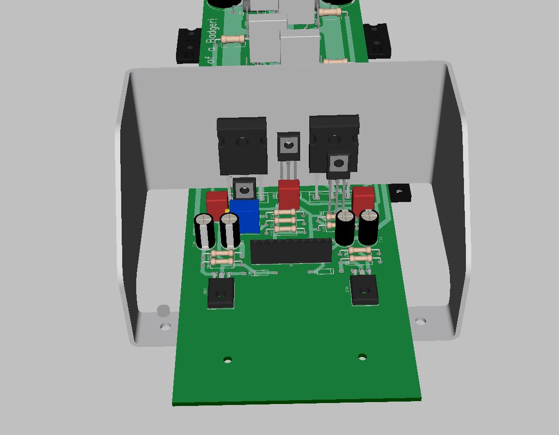

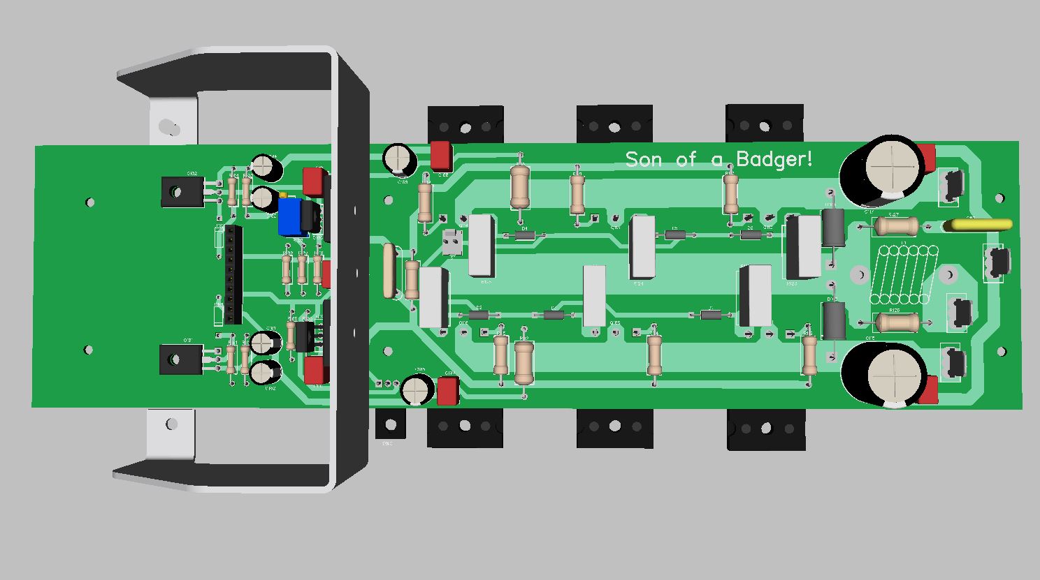

I don't have all of the right 3D models loaded yet. The Slewmaster style layout still needs the servo, servo regulators and the cap multipliers placed. It might fit but it'll be ugly! The screw holes limit the board to around 2 3/4" wide so it's pretty slim.
The screw hole locations aren't playing out well in the Badger version. If we want to screw off the driver heat sink they need to be in the middle of the board killing a lot of space.
Now that you have some final designs published I'll dig a little deeper and see what I can come up with.
This might help with layout but it would definitely eliminate the need to manufacture a custom heatsink for the driver transistors.

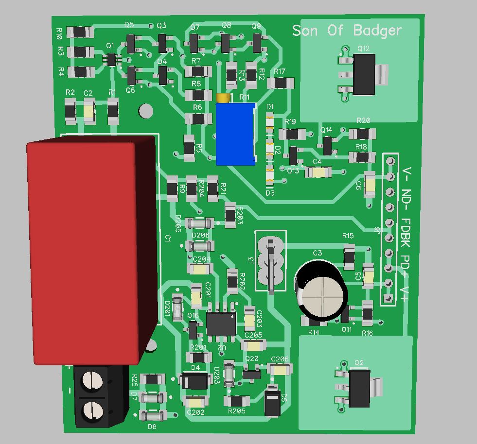

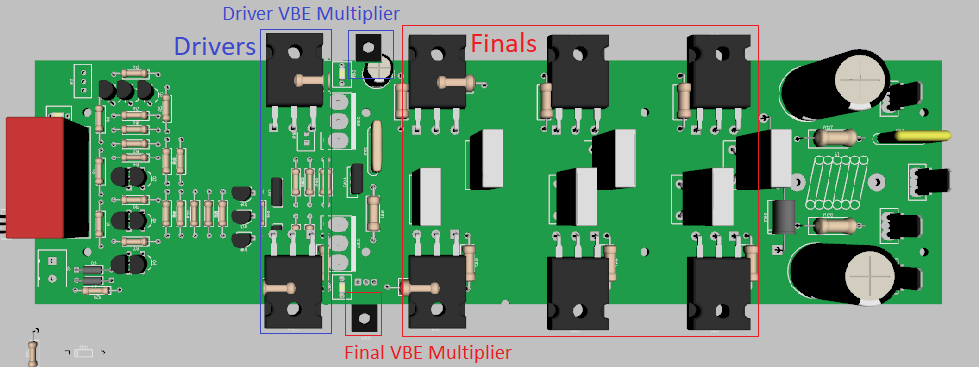

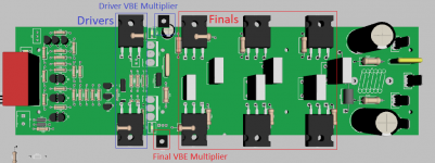

I've got the preliminary output stage layout done. I opted for a small plug-in input board and added some over-current sensing connections. I'm going to do a SMT input stage first, then see if I can squeeze in a through hole version

I might do a 5 pair layout in the UMS configuration just to see what it looks like. I'm not sure if the UMS pre-drilled heat-sinks are up to the task though. The placement isn't optimal for two row cooling.
Layout looks nice. I definitely like the plug-in front end board.
I would think a three pair output stage would be more than adequate for almost every builder.

Yes , I just (almost) got the go-ahead to make the Slewmaster DIYA store
amp.
Single row like the store UMS is better themally. When I had a slew , I noticed
my bottom row was cooler and bias was several mV offset on either P/N rows.
This might not affect the amp in normal operation. At the limit , one row or the
other could hit SOA first.
I'm into speakers now. Most sub - 500$ OEM pairs would really be pushed to the limits by a 6 device OPS. The amp would laugh at most of them.
So , the two row OPS issue most likely be of no concern.😴
