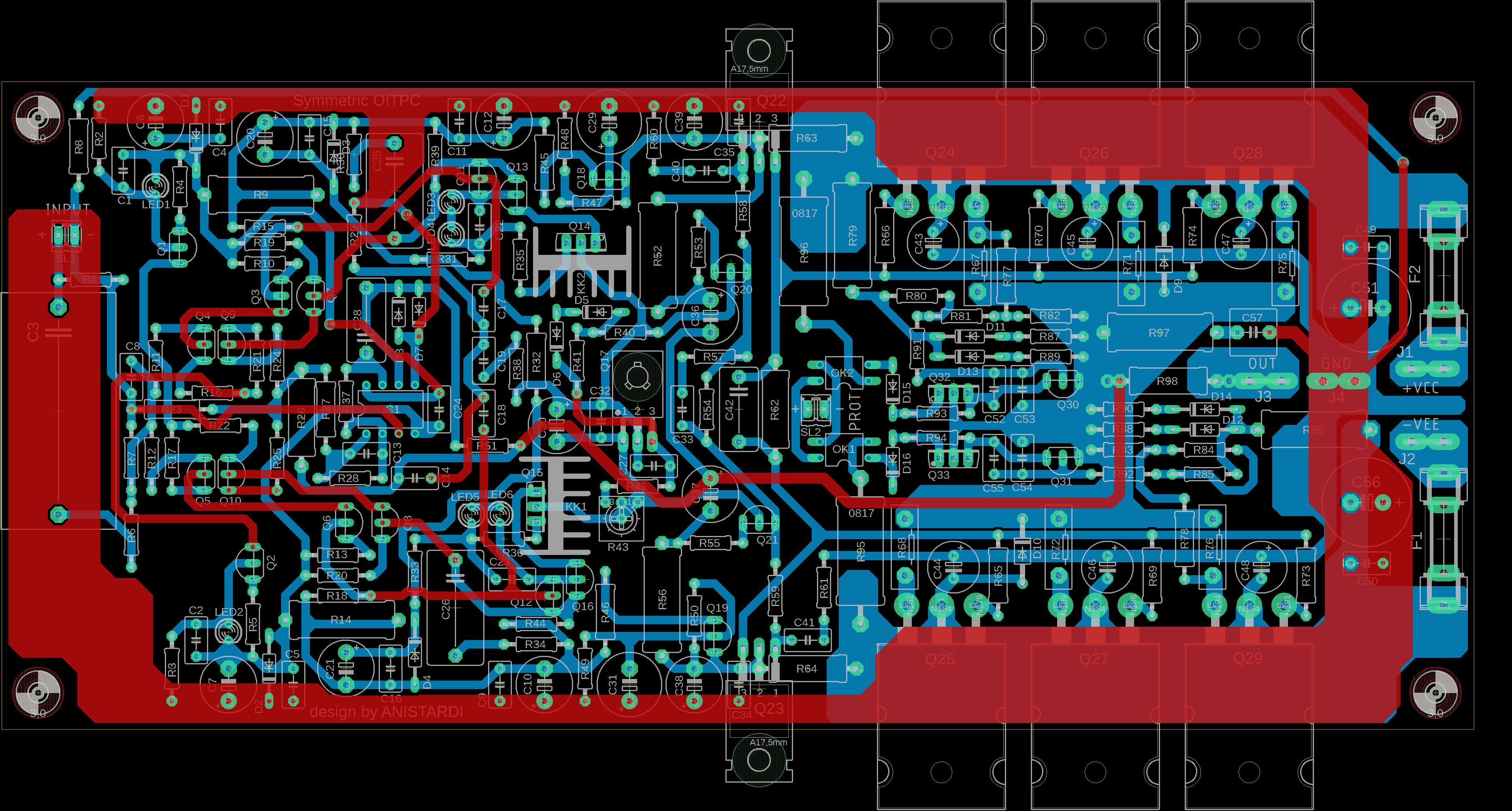

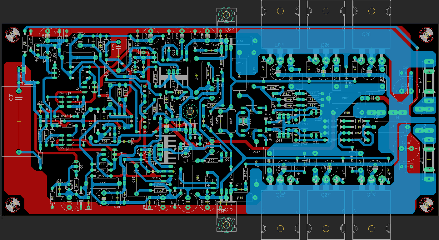

PCB style
bimo what about this style PCB I think you can do it with more pairs I've saving this for later, I attached the image as reference maybe this can give you ideas 🙂

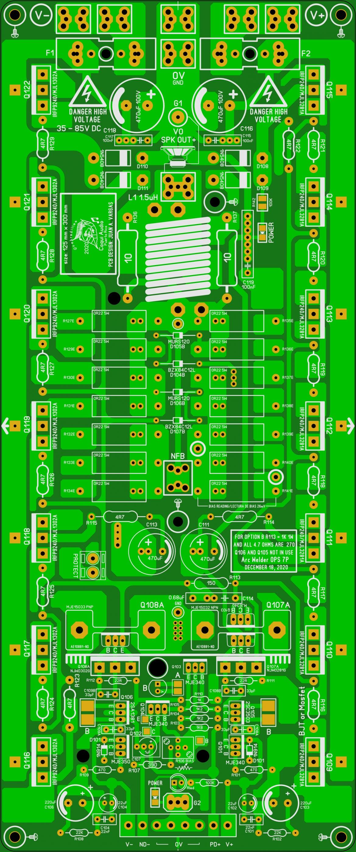

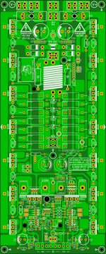

You can make the pcb layout. The schematic and simulation in my previous post.
bimo I generate the schematic can this work on Slewmaster OPS boards?
No. Because the pre-driver is bootstraped. The value of OITPC compensation is depend on phase shift of the output stage. If you want to use OITPC compensation with slewmaster's OPS, the value shoud be changed.
