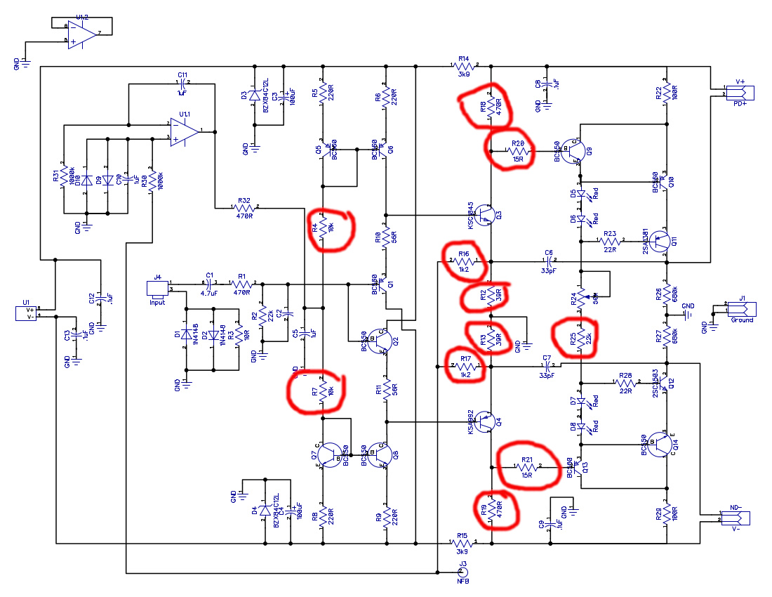

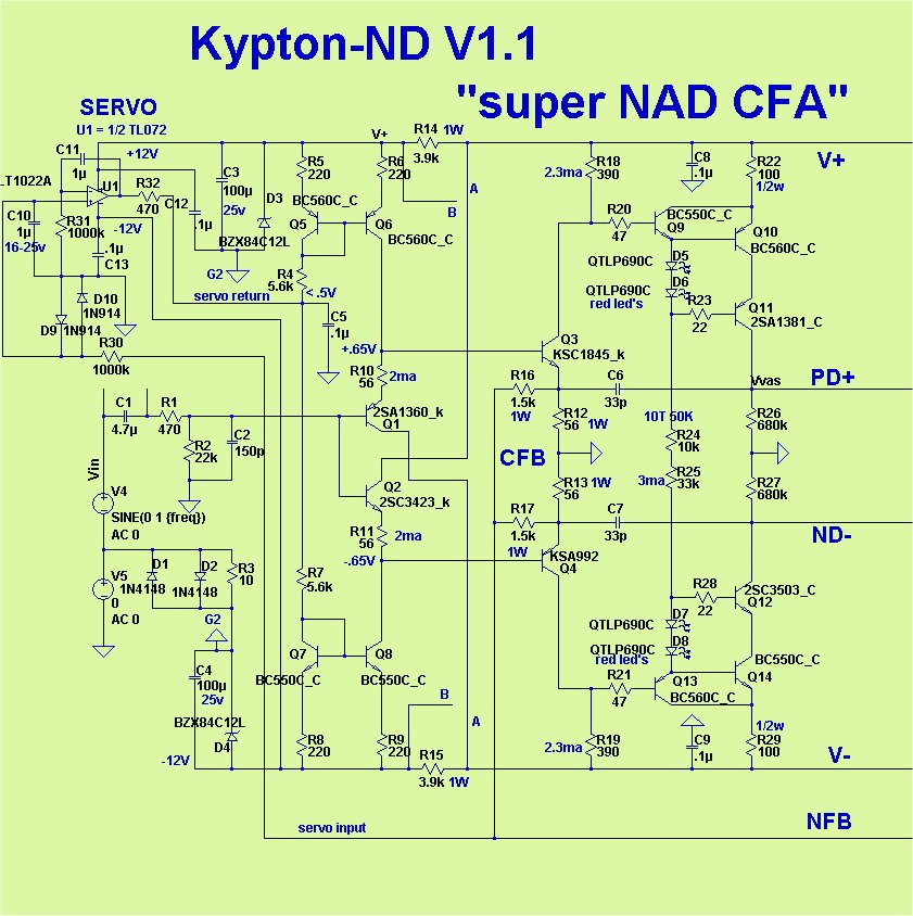

resistor values for Kypton-nd
I realized, that there are differences in some values of the resistors between the schematic of the kypton-nd in this thread and the thread of the group buy?
Why are these changes made, because of the different transistor types used?

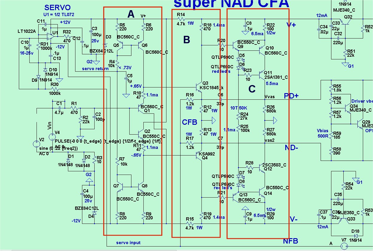

Here's the what I found for a starting point for resistors. There are some current flow readings that may need adjustment. These are measured after the input stage is completely warmed up.
R14, R15, R24, R25 require adjustment if you change the rails voltage.
You need to the current through R14, R15 unchanged - as soon as you increase the rails voltage, you need to increase the values of the resistors accordingly.
The same thing with R24, R25 - you need to have the VAS current at 5.5mA, higher rails voltage -> higher R24, R25 values.
This one was a little different, R18/19 needed to be changed as well to control VAS current. There were also some changes to R10/11 with extreme rail voltages to keep parts in the B section of the schematic cool.
