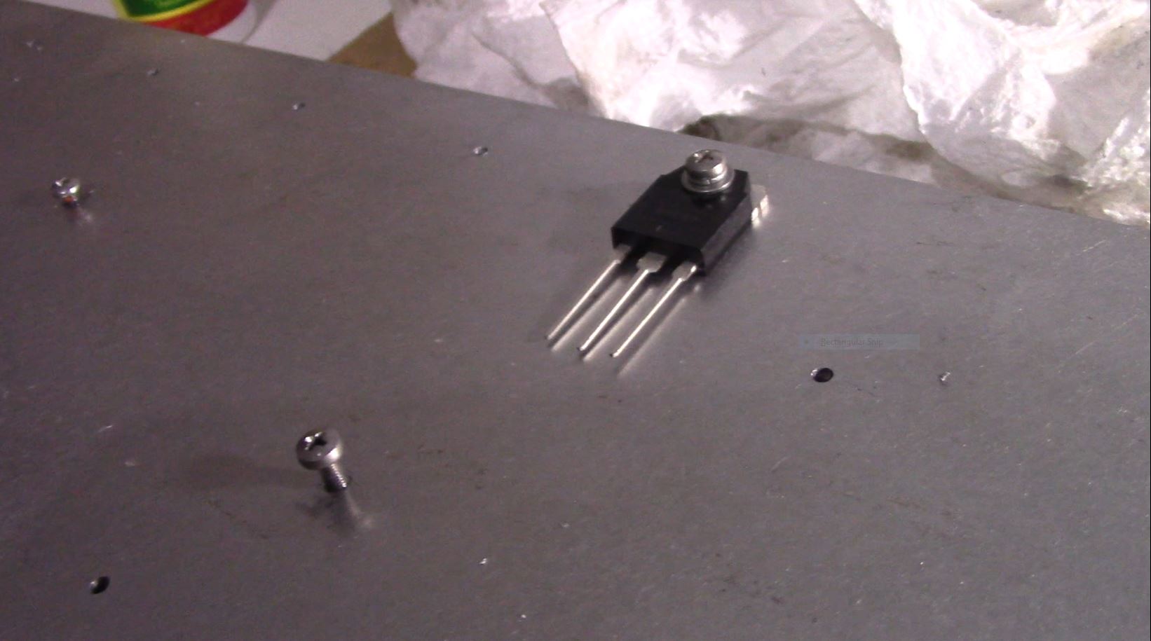

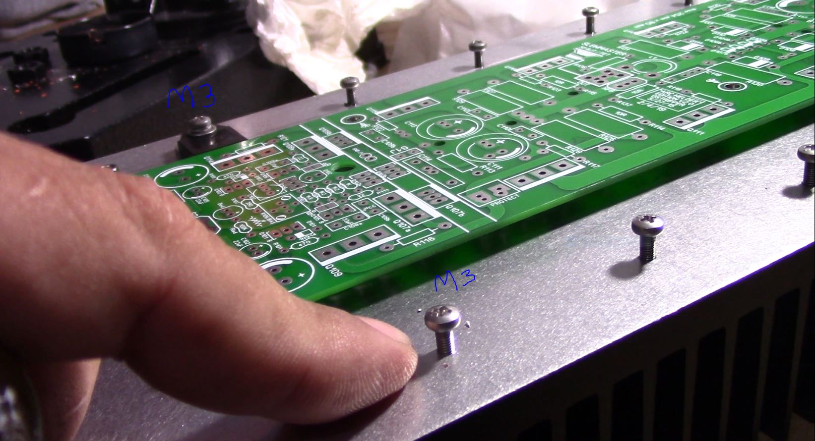

I never had a problem with it. This is one of my prototype heatsink, during board replacement.
Sajti

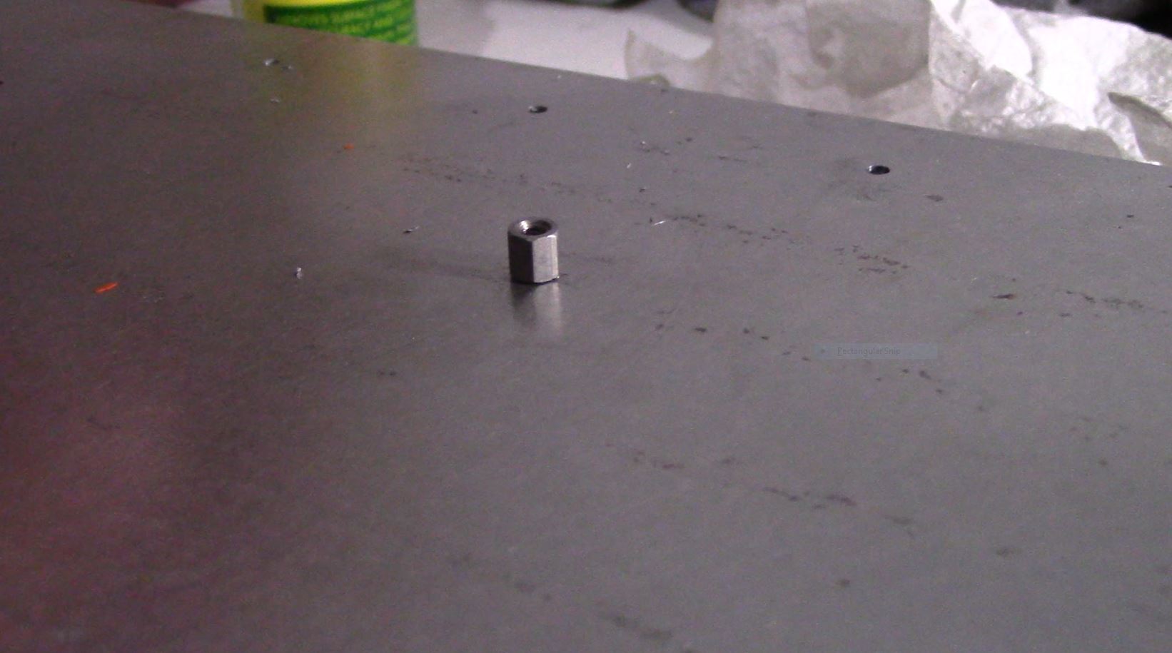

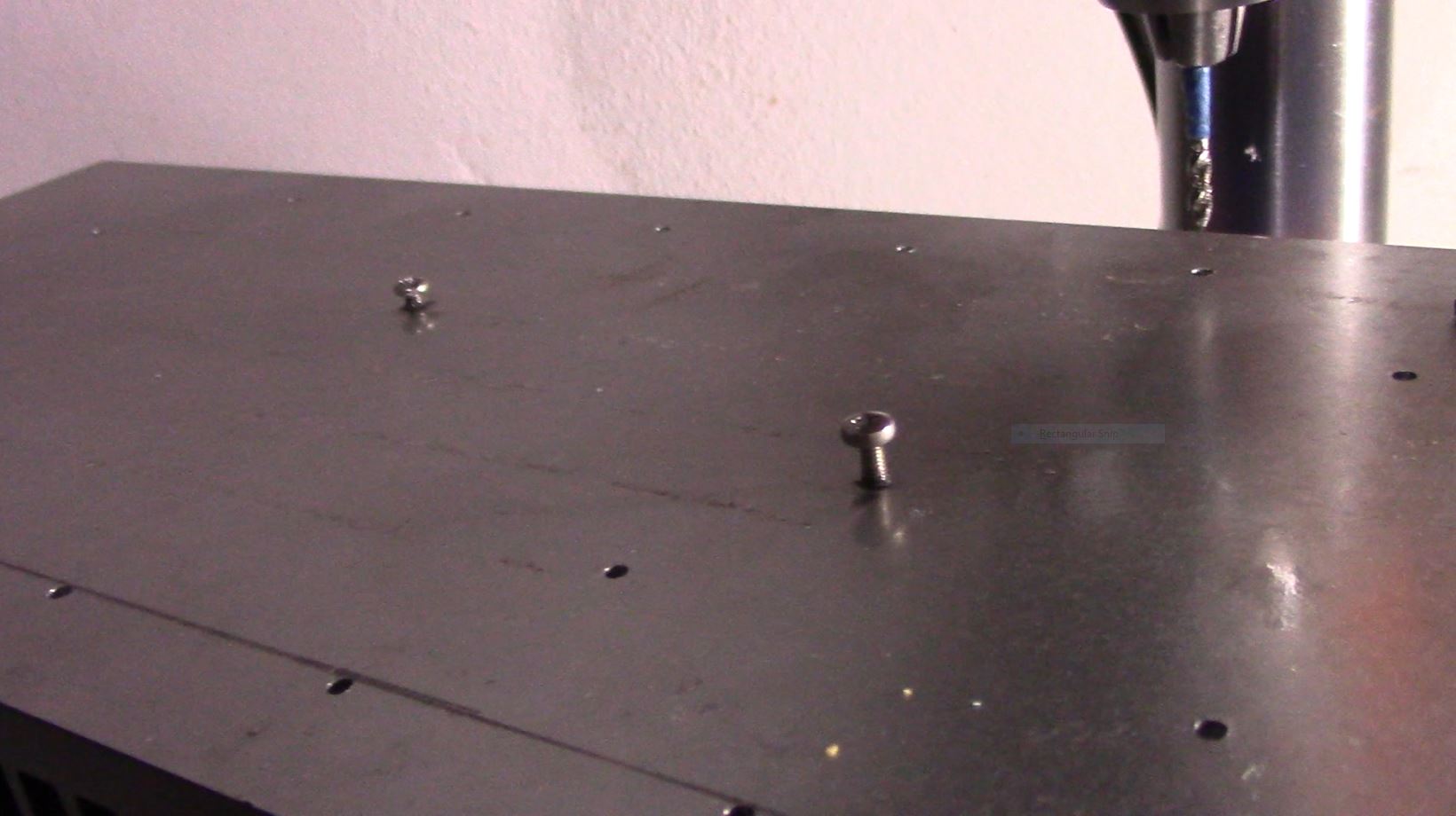

M3 drilling success

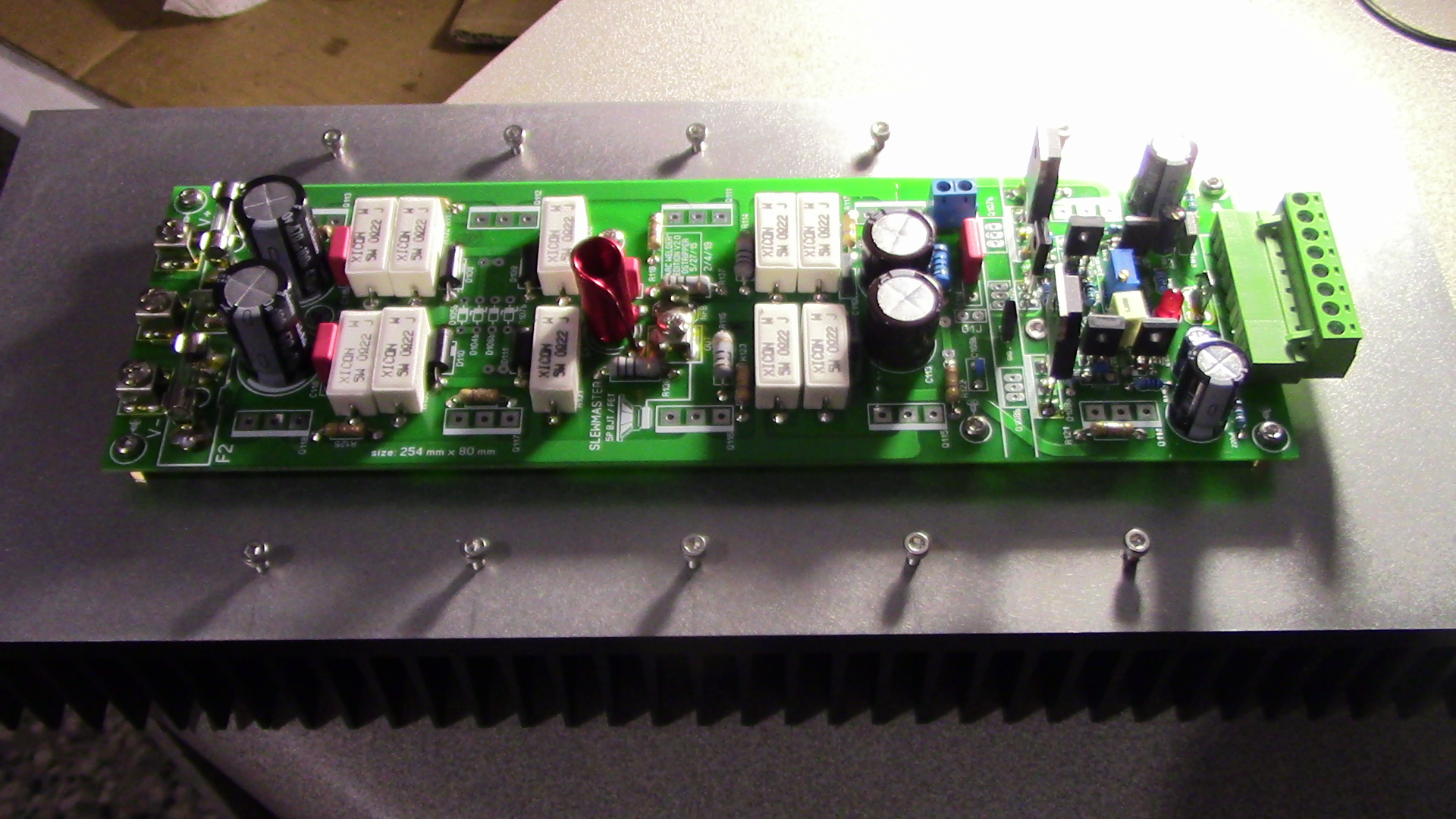

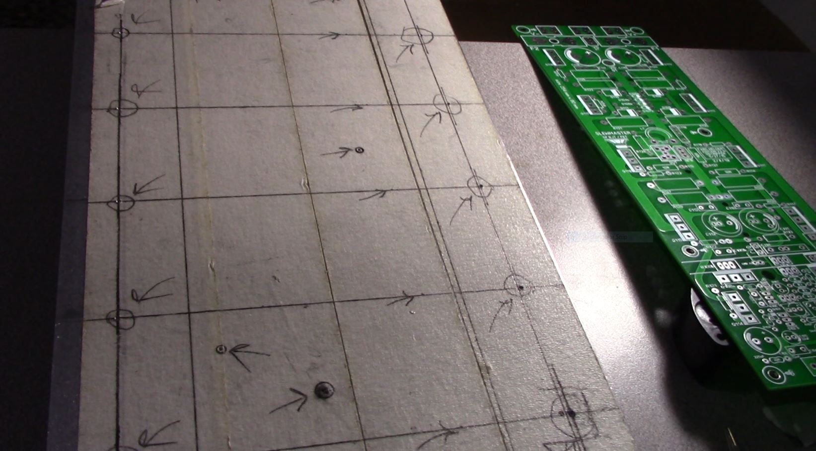

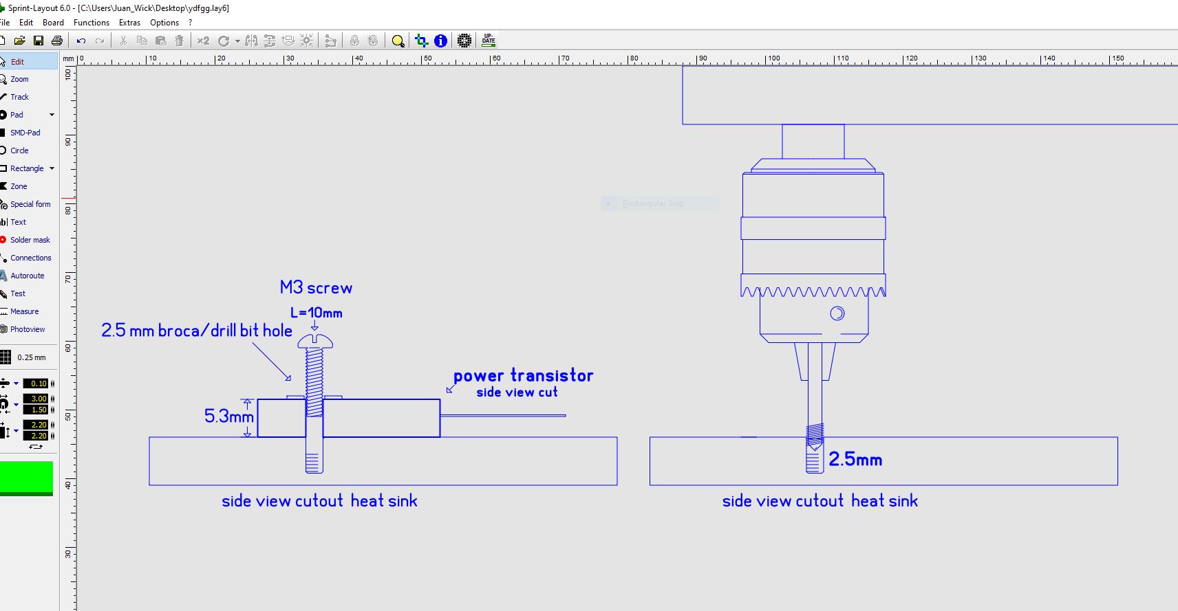

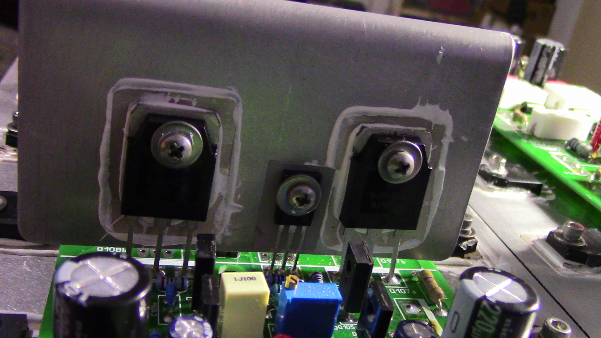

hello guys good news for me doing this for the first time I was able to do the drilling also Mr. ST gave me good advice and does work really well I mark the drilling with an automatic puncher then I use a 2mm drill bit after the drill bit holes are done then I use the 2.5mm all using the special oil for this purpose the speed of my cheap drill press was set to 3200 rpm after all holes are redone to 2.5mm then I remove the belt from the drill press also the spring tension that kept the handles with pressure off and I again use tapping oil place the tap drill bit then I begin giving a few turn slowly and I was able to get good results on tapping them
I'm really surprise that I was able to do that now I can finally continue with Arc welder that PCB I used as template for the drilling

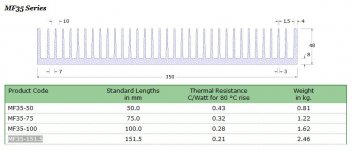

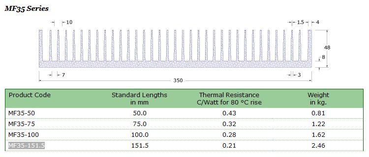

not to promote anything but the heat sink I got them from Conrad Heatsinks the ones I have are part number MF35-151.5 and to describe when I was drilling with no problem I think is because the special oil that I use "Rapid Tap" cutting fluid
oh I mention the website because in Puerto Rico where I live is difficult to get heat sink and usually they are really expensive to get but from this website the price was about right
Conrad Heatsinks
Conrad Heatsinks
Don't forget the heatsink on the driver transistors.
All the best to everyone for Christmas
yes of course I got that not installed yet Merry Christmas

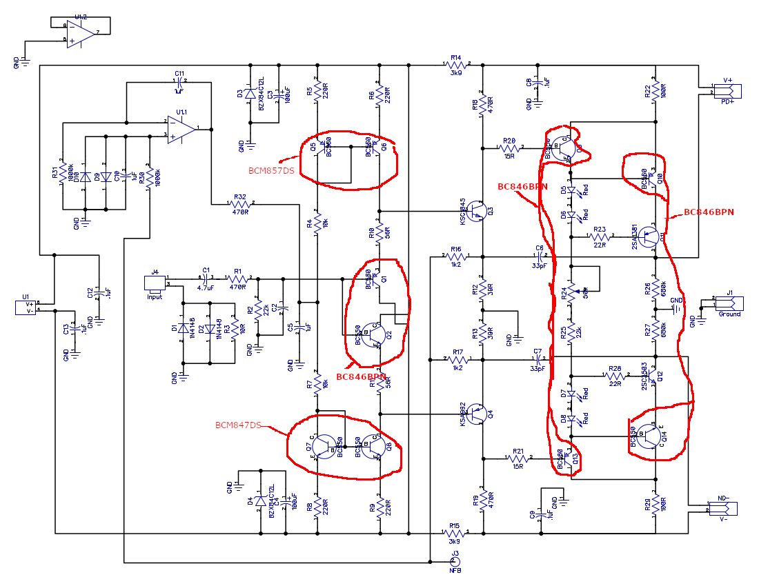

SMD Transistors for Kypton-ND
I’am thinking about making a small Kypton-ND SMD PCB.
So I was looking for SMD PNP/NPN Pairs. I found following:
1. BC846BPN -> matched, but tiny
2. HN1B01F -> large, but no Info about matching
3. BC817DPN -> large, but no Info about matching
All transistors seem to be no low noise types, like the BC850/60.
What Transistor should I prefer?
Or do you have any other suggestions?
