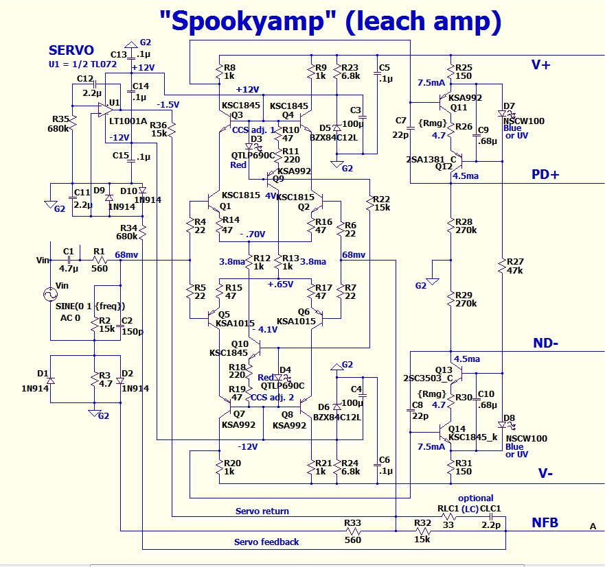

last and best Spooky and Kypton-ND schematic
I get lost in the long thread.
I'm looking for the last, well tested version of the Spooky and Kypton-ND input stages.
The Spooky here his V1.1, but OS also made a version V1.3 here. Anywere there should be a version 1.2. Which one is the best?
And for the Kypton-ND I have the similar problem 😀.

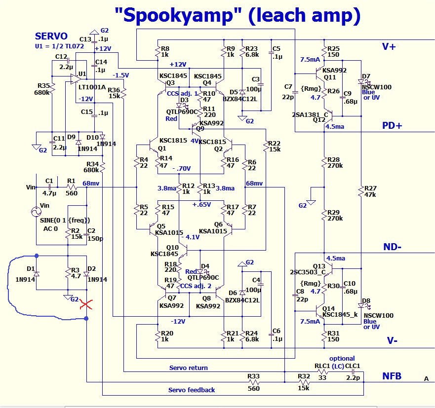

Here is the Spooky 1.2 schematic. I have made this and found it excellent (though I've not made any of the others for comparison).
Hi Thimios,
the schematic you posted is very similar to that linked in the first post of this thread (only two transitor types are different and 2 resistors).
But one thing seems to me is wrong.
The feedback basis should not be connected directly to ground, but in that way I have drawn, if R3 is the anti hum resistor. Do you agree?

I can only confirm that this 560R is connected to <<dirty>> gnd, not at the lifted.Hi Thimios,

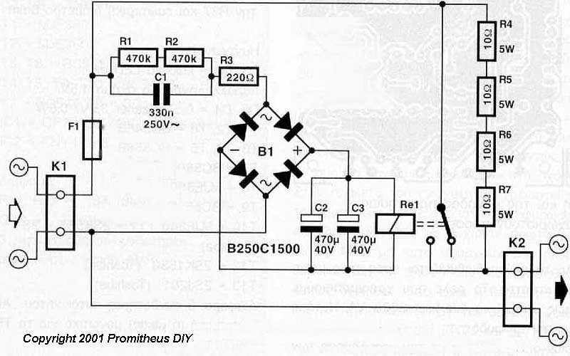

HI,
this is the last version ?
I will have a lot of capacitor in my amp and I would like to limit the current as much time as possible
thanks
Hallo Ultimate,
I have build that circuit and it works, but I prefer this circuit with the relay bypassing the softstart part.
This is a good solution, the only idea comes into my mind, to replace R4-R7 with NTC, such SL22-10008, to avoid fire, if the relay, or relay driver circuit fails.
Sajti
Sajti
Yes, that's many commercial products have been using, space saving too
I have made a few of these and they work. You can also buy them on eBay cheap.
I added a 24V Zener across the coil to protect it and to suppress transients.
R1 and R2 should be 1W or more. Especially if your mains voltage is 240V.
Some 1/4W and 1/2W resistors have a low working voltage spec. That is why these two resistors are in series.
I also used two NTC's in series instead of R4 to R7.
The circuit is at mains voltage so don't touch it.😱
Hope that helps.
Hope that helps.
