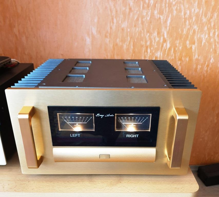

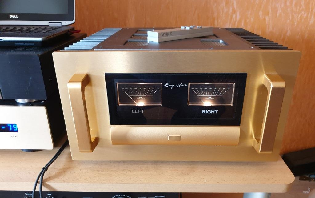

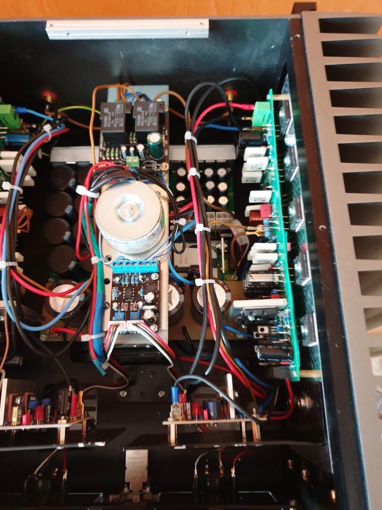

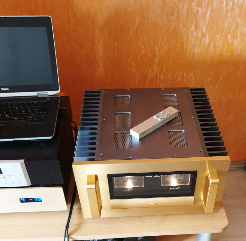

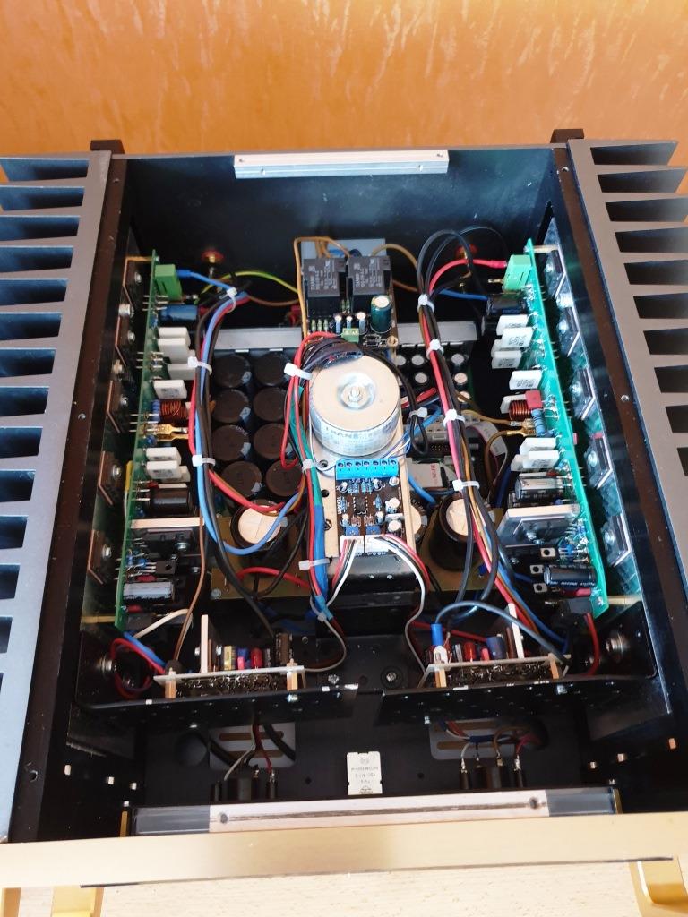

My Slewmaster power amp. Each amplifier module is equipped with 5 MJL4302 and 5 MJL 4281. The power supply is a 3000 watt SMPS from Hypex. The power amp has SOAR protection.
The temperature and the offset are monitored. The preamp board is Bimo's Symetri.
The output power pro Chanel is 190 watts at 8 ohms and 330 watts at 4 ohms. The upper limit frequency is 800 kHz with an output voltage of 10Vss to 4 ohms. The rectangular behavior is perfect.
Thanks to Ostripper and Bimo for this wonderful sounding amp. Keep it up.🙂
