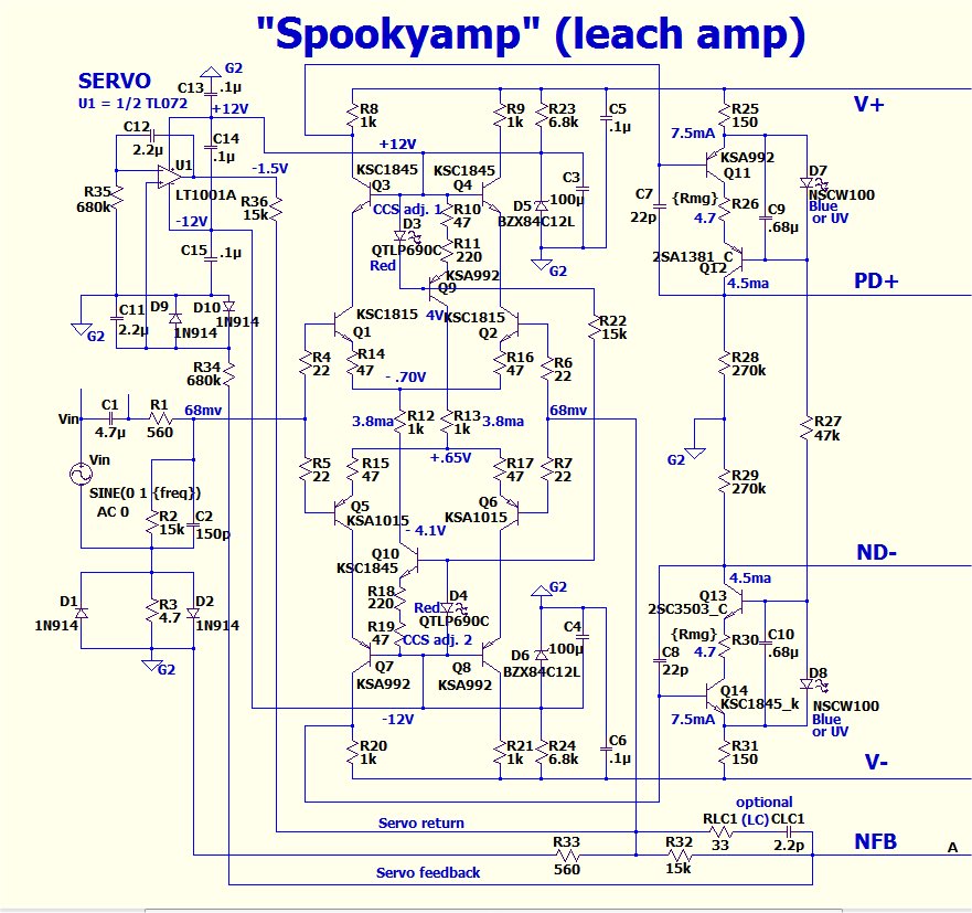

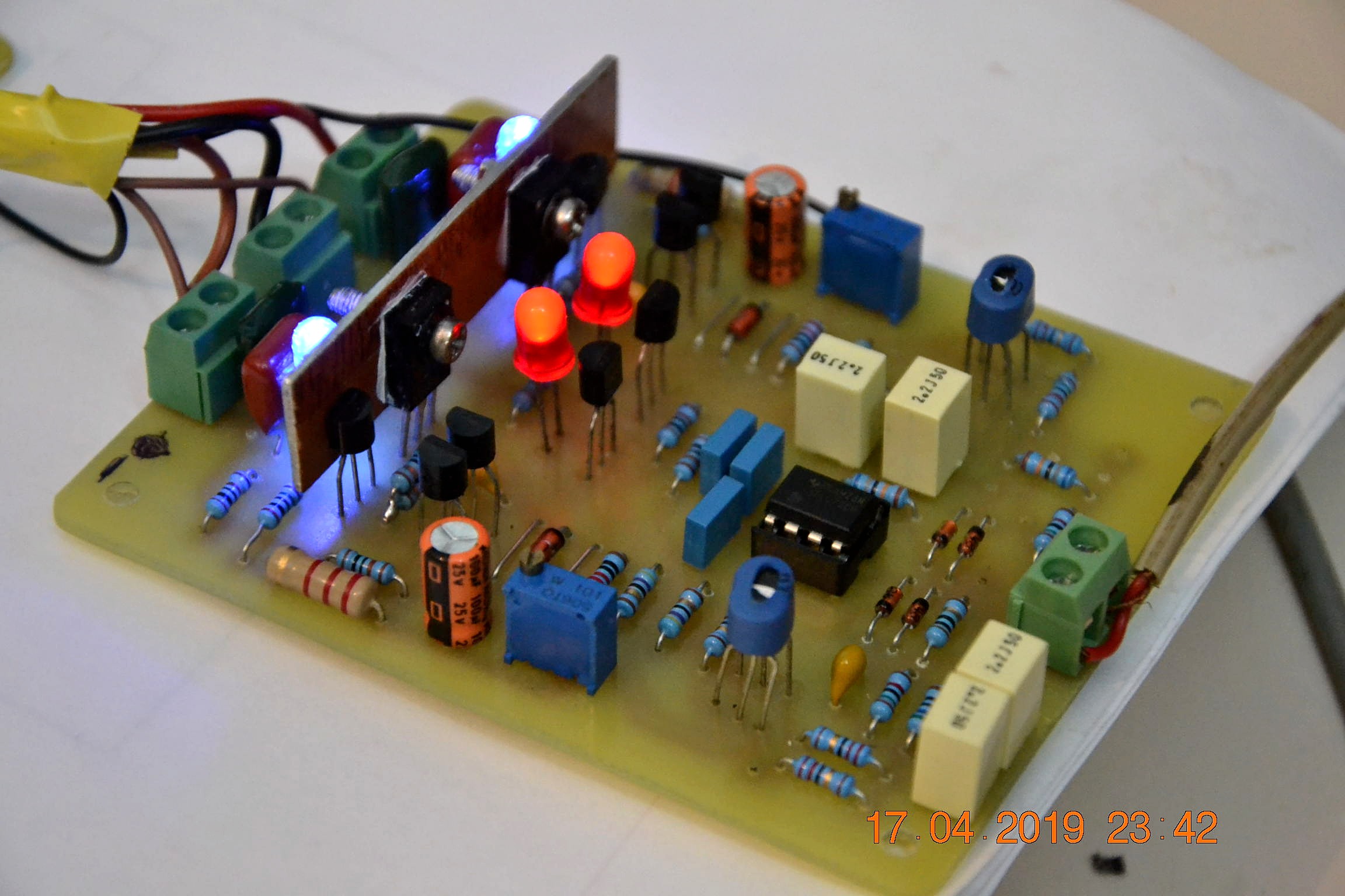

My objective is to make Spooky-Leach to work at +/-35V with 2 pair output.
Can somebody teach me how to change the VAS biasing?
Should I change R25/R29?
I wish to learn more details on the Hawksford cascode stage and how to set the VAS current.
Also, is there any change required for capacitance multiplier biasing resistors for 35V?
Thanks and regards,
Sumesh

Hi Sumesh,
You need to change:
R23, R24
R22, R27
No other changes required.
Assuming you need to maintain the same current through all these resistors, you need to re-calculate their values in proportion to the voltage change.
Valery
Thank you,
I learned how to calculate R23, R24, the rail dropping resistors, assuming 21mA current(LTP+ servo OPamp current) through them.
I couldn't find how to set values for R22,R27.
Any help in this would be great.

With 85V rails and 6.8K resistors, you will get around 17V at the zener, which should be fine.
Hari

Please always post the schematic diagram you will ask about.
This is a long thread for easy service.
If my memory serve well, you need about 5.5mA VAS current.
Voltage on a zener must be what a zener voltage is.
17v on a 15v zener isn't right. You must recalculate Rzener for 14, 8-15,2 voltage.

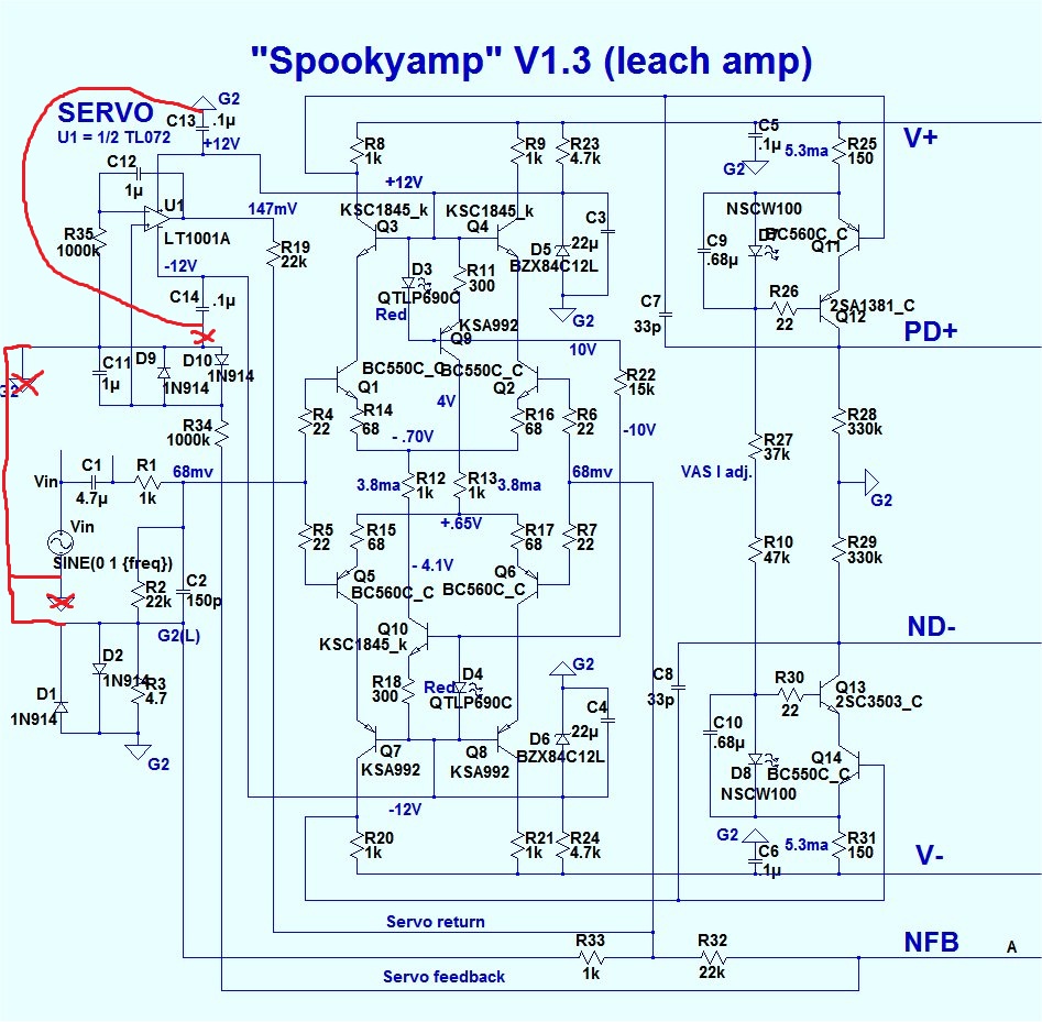

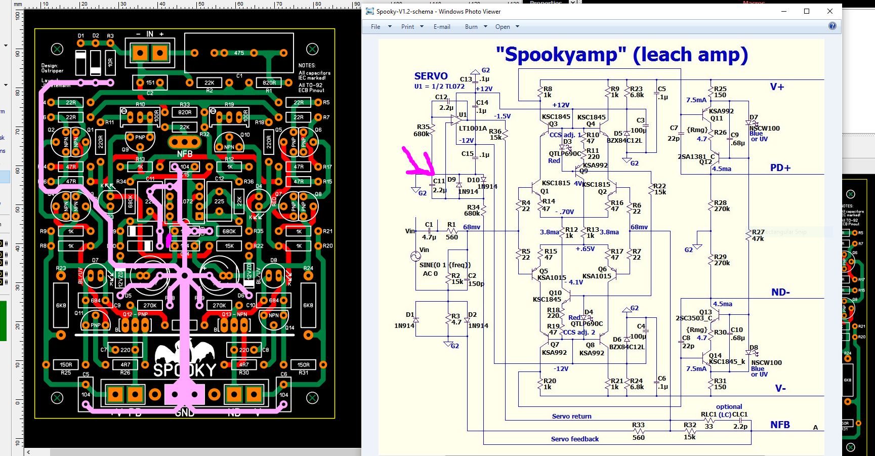

Spooky leach started singing...
Thanks for all the support...Got my doubts cleared after reading the previous posts in the thread....!
Now, only ONE doubt...Where should I connect the servo ground? To the lifted signal ground or to the main IPS ground G2?
I understand that feedback ground should be connected to lifted ground.
Pls, clarify.
Thanks and regards,
Sumesh

I think you can connect that normally my Greenamps I connected them in the same matter the servo GND is already establish see image
Thank You Juan...It helped...

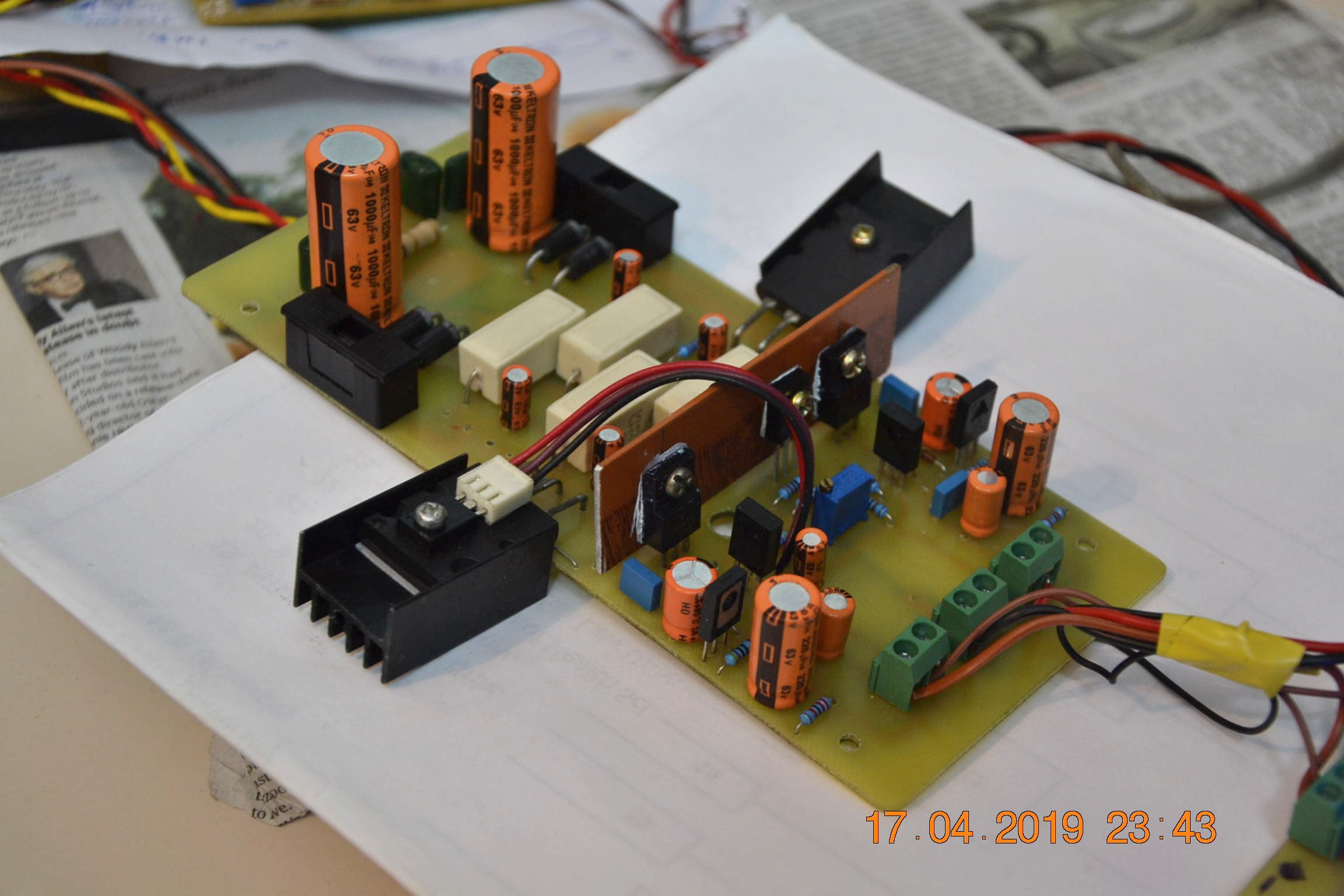

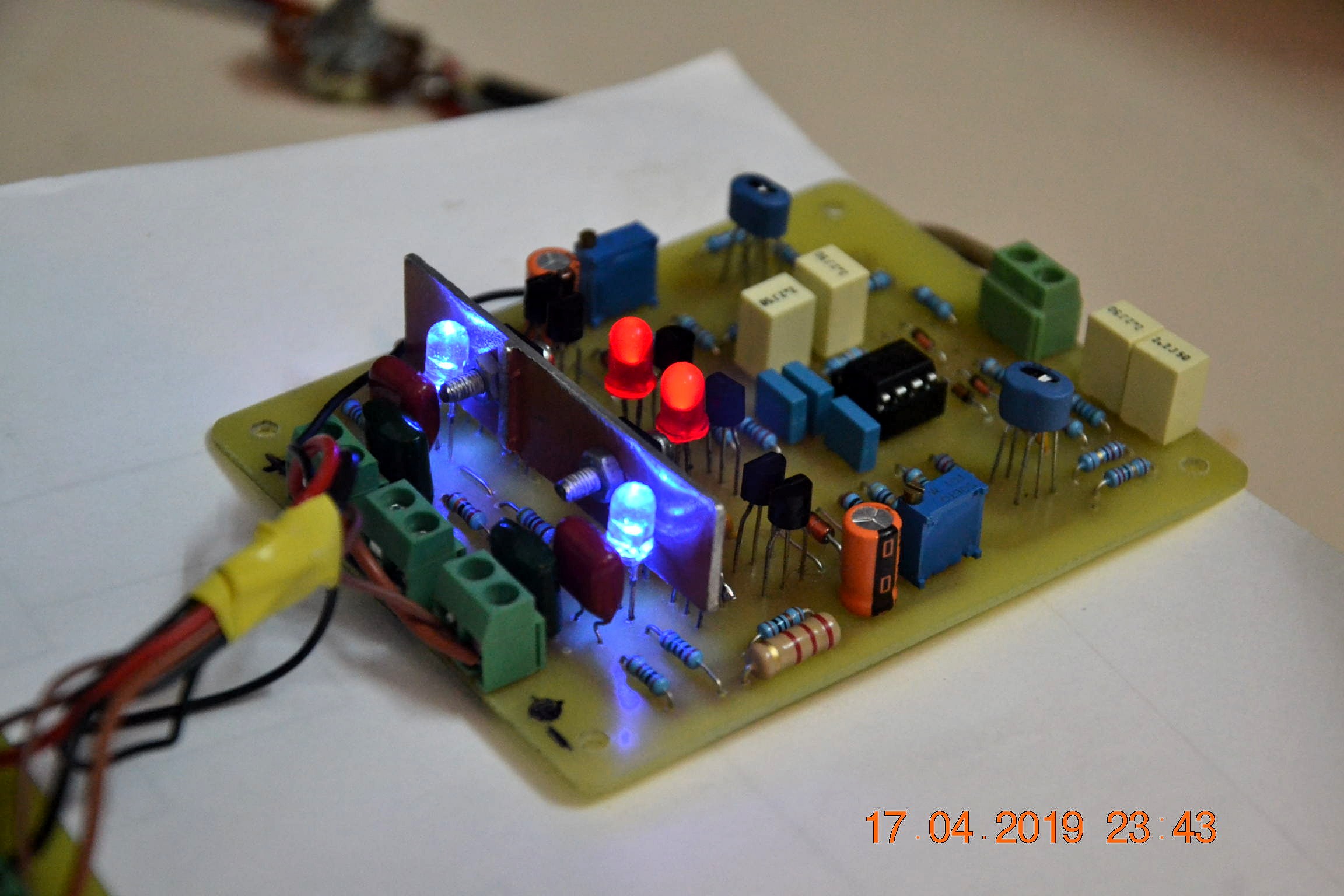

Spooky Leach 1 pair @ +/-32V
Hi...
Extremely happy with the Spooky build...
Express sincere gratitude to W. Marshall Leach, Jr, OStripper, and Spookydd, Valery, Juan, Thimios,Terry, Sownel, Jethari, Andrew Lebon and many others who have helped me indirectly.
All voltages are in accordance with OS's simulated values.
DC Offset 1-3mV
Thanks and Regards,
Sumesh

OK.
In my version of this VAS , the global bias is usually set by the current in
the LTP's. If you want a set LTP current , there is a alternative way to
fine tune the cascode's (VAS main output I) current. That is to change the
amount of current through the LED's.
Calculating the main current is as simple as subtracting the LED current from
the current across one of the main VAS emitter resistors. If you want less
current through the cascode , reduce R between the LED's.
As far a the Cap multiplier with a lower supply , one could reduce the R (C-B)
to lessen the multiplier's voltage drop.
Also , at lower voltages the 12V zener regulator resistance need to be reduced.
35V = 2.2K - 3.3K.
PS - glad Y'all enjoy the spooky/greenamps. 🙂
OS
