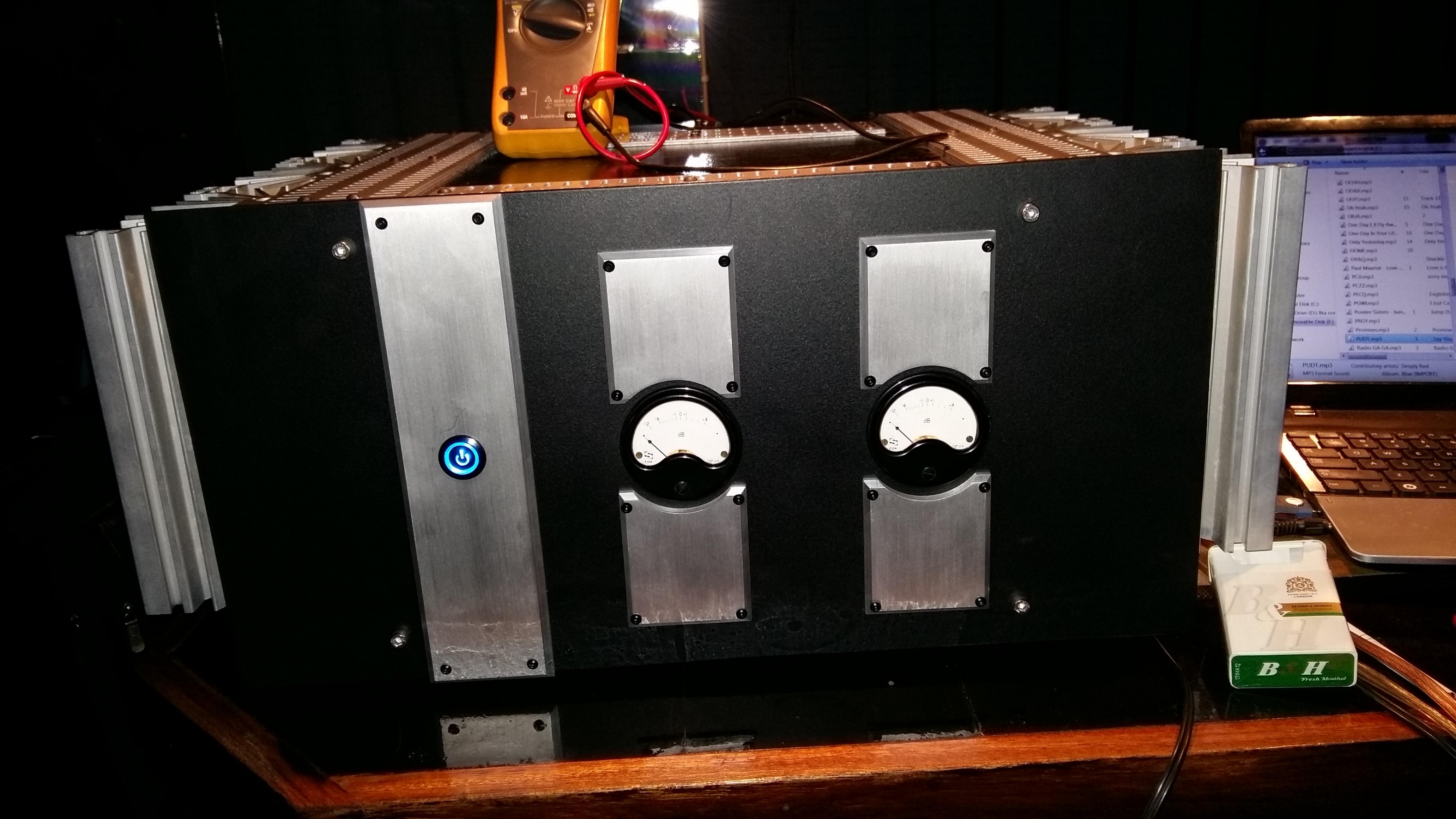

Thimios, yes, I rember those hectic Slewmaster building day's !!😀
Lots of sleepless nights, and when you do sleep then you dream about all the different building options !😀😀
Very well done.

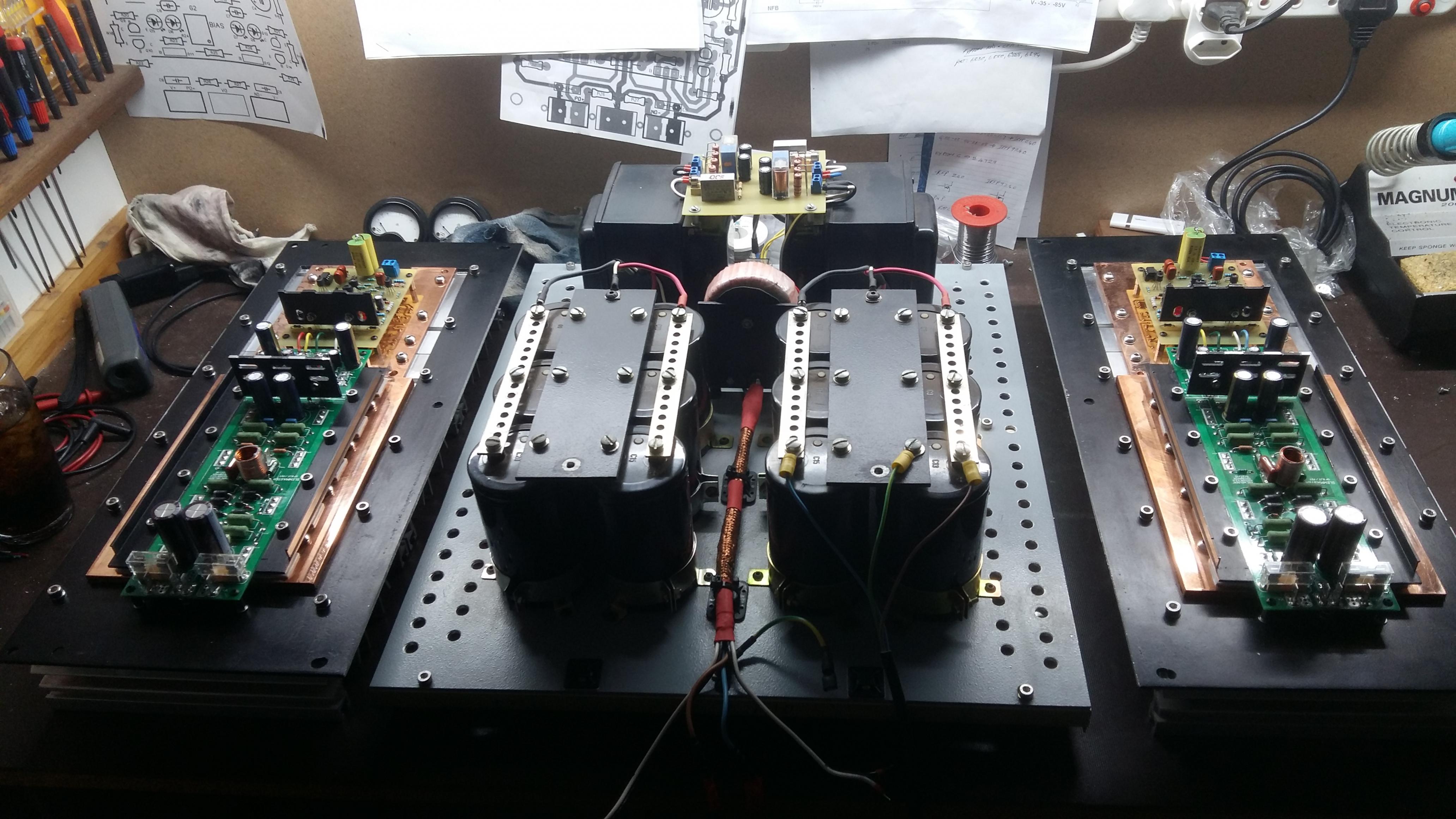

EI trafos where used because they were available or this type is your preference ?
And what kind of caps are you using in the main cap bank ? I wanted to know, I'm finally starting a similar project this month (Jeffs and Vallerys) having collected all parts except PSU. I remember I was so tempted to start Slewmaster couple years back.
Great, a unique looking one.
Seems like heatsinks are oversized do you think they were necessary or you simply wanted to be on the safe side. I was gonna order 160 x 300 hifi2000 heatsinks.

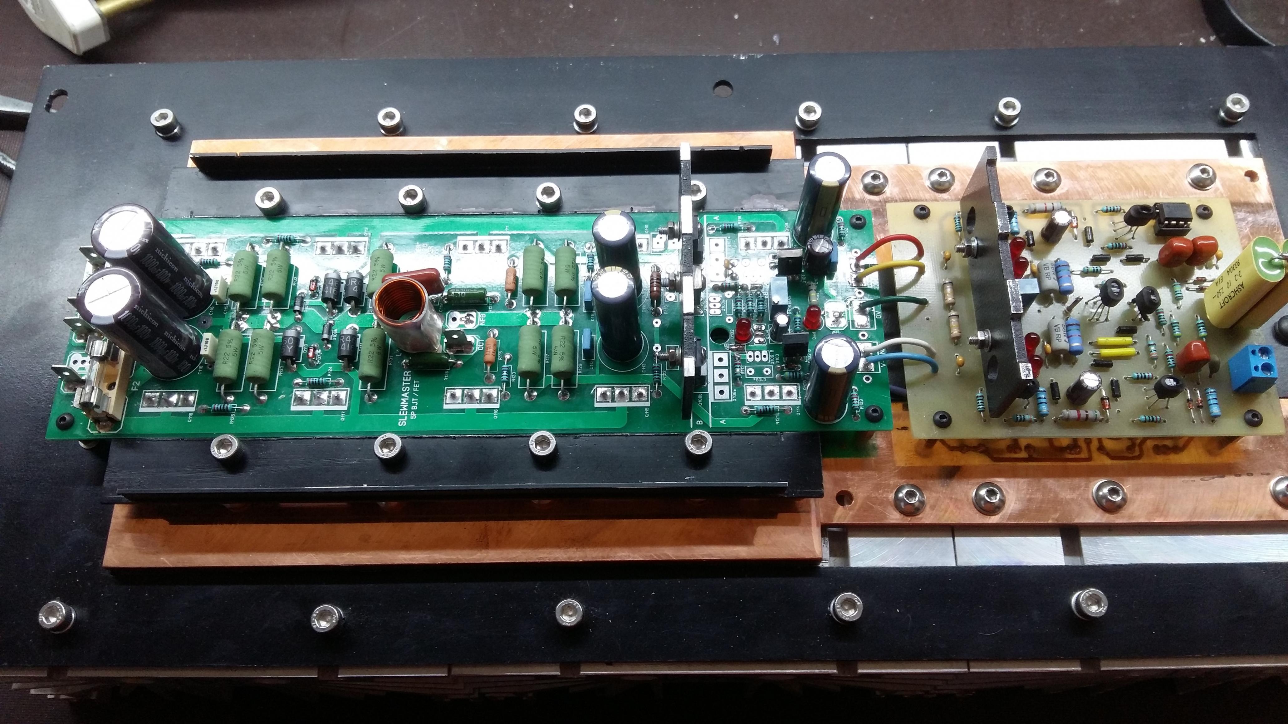

Just for giggles I grafted on a VSSA board as an IPS, lo and behold it works. Testing has to be short and sweet at the moment since it still is not on a real heat sink yet. Seems to be a little over-compensated thermally, but then I did let the assembly get quite hot. This is likely a good thing at the moment.

Savvas, the heatsinks are big, but I already had them and where I live it becomes very hot in summer, so they do a good job .😉Great, a unique looking one.

thanks for the info, I'll give it a little more thought because summers here too are very hot, maybe I'll go for 160 X 400. I also like Epcos Sikorel caps, one big or two smaller in parallel. Decisions, decisions...
