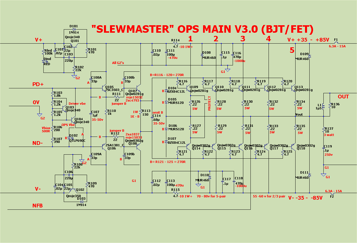

Do you have the schematic for the above pcb design and also what are the OPS transistors?
it use BJT or FET's is noting new here 🙂
I think all that he is saying is that can you combine the "power supply design" OF the green amp that Ostripper designed into the Arc welder schematic and therefore the PCB. Personally I would love to see that done. It would make a great or greater 400 watt amp. Thanks

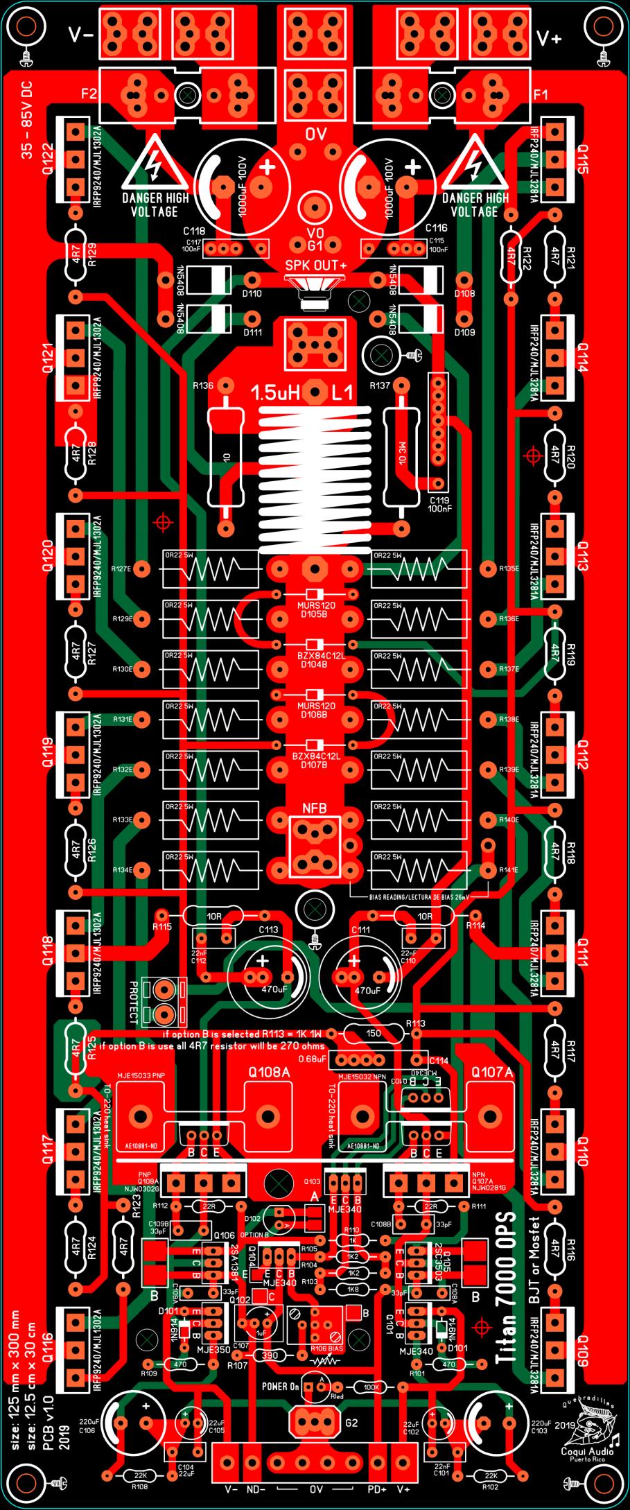

hey guys I'm gonna leave the Arc Welder Titan 7000 here please check before order the PCB's here is the files, if any error please let me know so I can corrected right away 🙂
Best Regards
Juan
