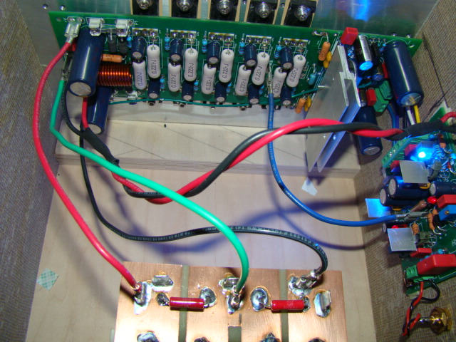

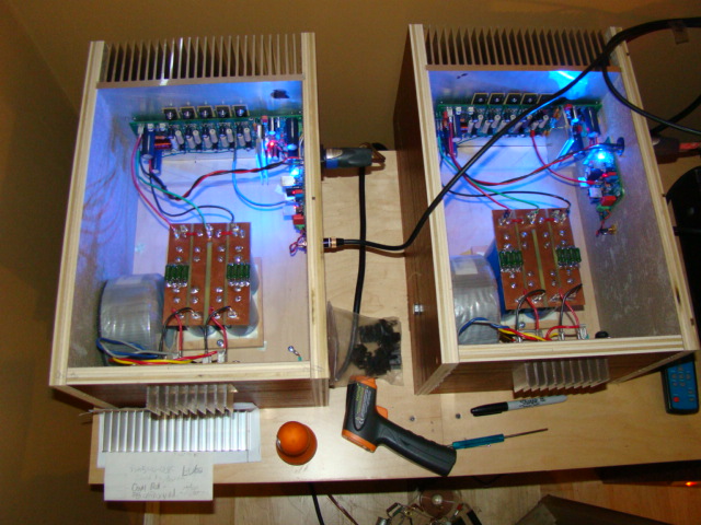

The DC offset is good both channels 5mV. Here are some pictures of the toroid arrangements.
I am please to report such excellent sound from the amp. You guys are in for a real treat to build this amp.
Very clean build. Beautiful!
![up :up: :up:](https://files.diyaudio.com/forums/images/smilies/up.gif)
Here are some shots of my first channel. +- 60Vdc. Bigger 58 vac. transformers are on the way. Mosfet 240/9240outputs. Seems to work right from start up. Offset can be set at or near zero. Bias cold is 53 mA and dropped to 50mA after playing for about half an hour. The heatsink was barely warm. Now for the second channel and a real listen.
