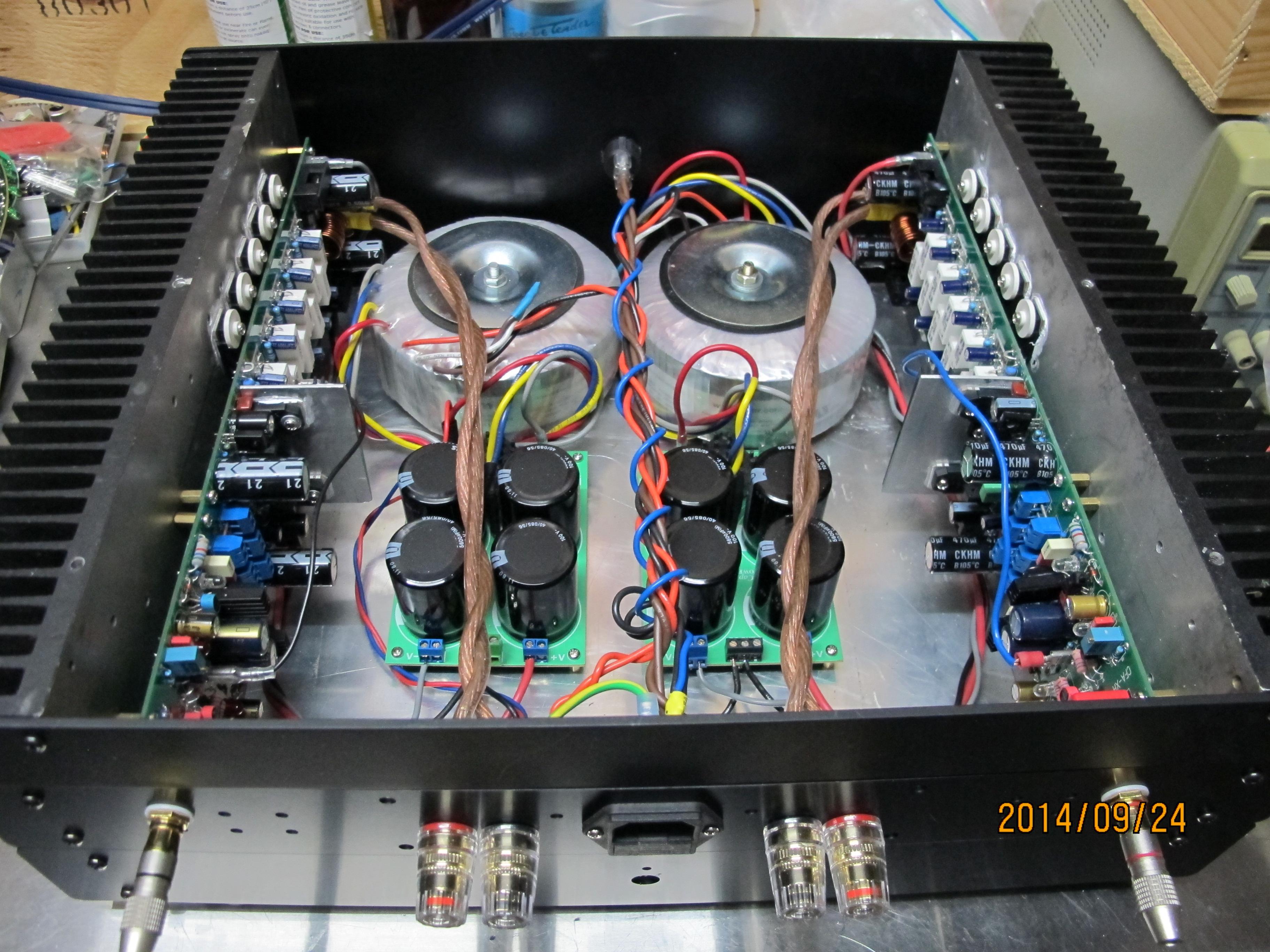

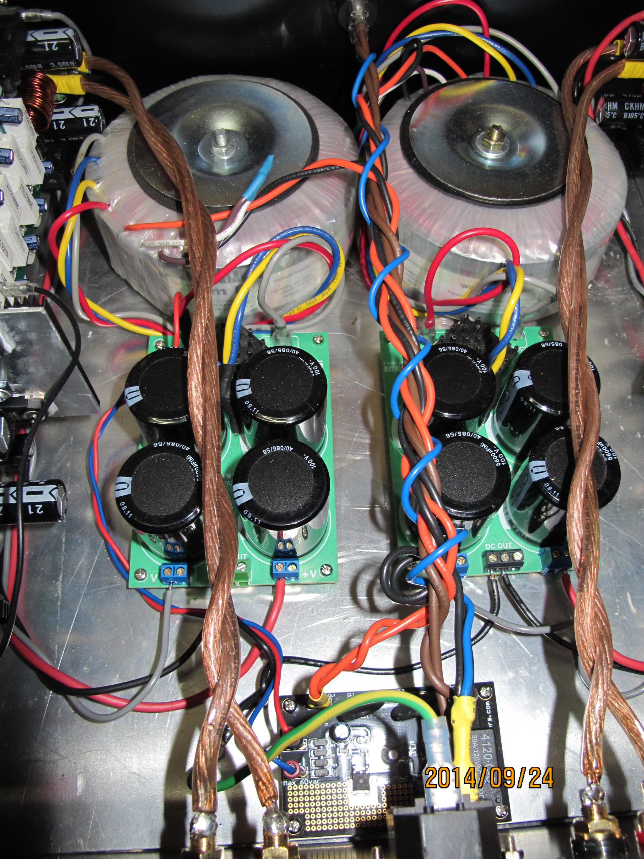

Hi Jason, I am finally boxing 5OPS/CFX IPS- one of the channel I could not get the bias to stabilised-drifting btw 16mV-16.5mV across RE, the other channel bias is rock solid. I also noticed that the transformer has a bit of buzz to it and the cycle of buzz cause the bias to fluctuate?.
Quan
Quan
Have you tried swapping the IPSs to see if the issue (a really minor issue, might even be related to a radiated field in the case) follows the IPS? Really that bias fluctuation is only on the order of 2-3mA, so isn't likely a genuine issue. Does it sound OK?
If it is a radiated field and you are using a torrid you might be able to just rotate the transformer to find a spot the perturbs the surrounding circuitry the least. Also make sure no hardware creates a 'shorted turn', this will make a transformer buzz too.
Post a picture of the current arrangement so we can visually check the assembly.

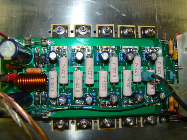

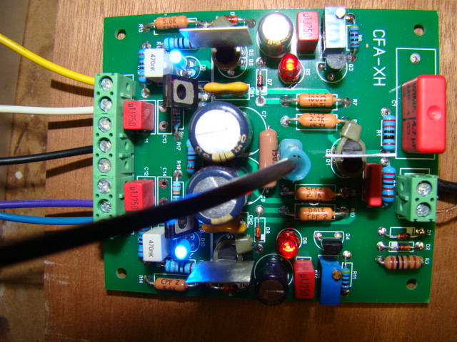

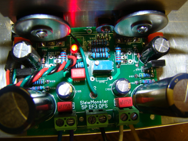

Here are some shots of my first channel. +- 60Vdc. Bigger 58 vac. transformers are on the way. Mosfet 240/9240outputs. Seems to work right from start up. Offset can be set at or near zero. Bias cold is 53 mA and dropped to 50mA after playing for about half an hour. The heatsink was barely warm. Now for the second channel and a real listen.
Thanks to all, Evan
