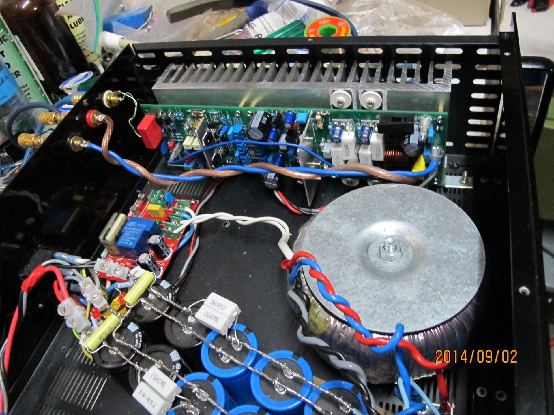

Just finished 2OP boards/Symasui-running at 45V, dc offset 1mV both channels-sounding great. I am now sourcing parts for the 5OPS with two of 400VA trafos. Just a question re front panel push button switch- rate 3A 250VAC - would it be ok?. Quan
Will you be using a decent soft-start circuit? That would likely work with a well controlled inrush current, otherwise I'd try to source something more like a 10A two pole switch for longevity.

Thanks Jason. I will be using Aussieamp soft start module with the button switch or should i get a higher rating switch as you stated above?. I will try to get some pics tonite after work.

I think you 3A switch will be fine. I must remember that regional mains differences play a key role in parts ratings. I live in a 120V region and so tend to think of current requirements double that of those that live in a 240V area.

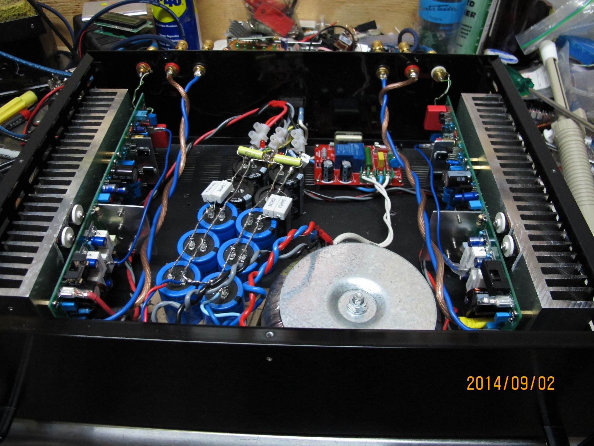

Just a couple of pictures of my 2OPS/Symasui builds.
How about the sound?

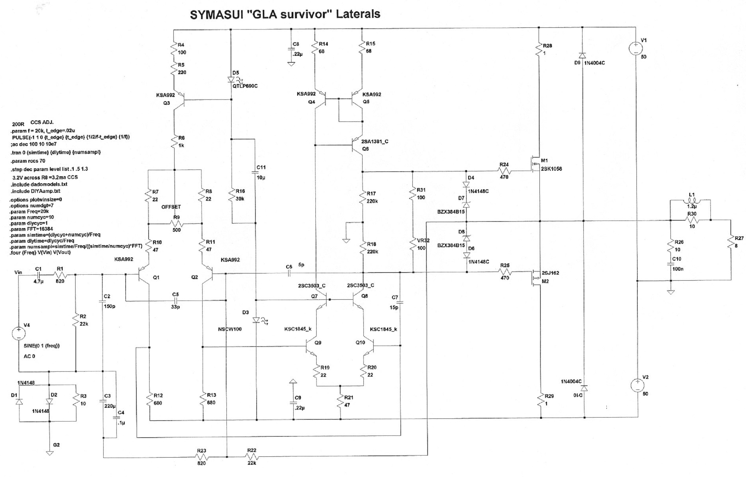

Hi Guys,
This is probably going to sound a little nuts but I was sitting here today looking at all the extra IPS boards I have and started wondering about building a very simple OPS to play around with. Inspired by the VSSA that drives a pair of laterals directly from the VAS I plugged a couple of them into spice behind the Syasui IPS. It runs but I'm sure I have something wrong somewhere so before I burn up some devices I though I would have you guys look at it. I know I probably need a vbe multiplier but hopefully you guys can give some suggestions. I want to keep it as simple as possible. This is just for fun and hopefully to learn something.

D9 and D10 are oriented to pass current directly from one rail to the other. If the intent was to use them as 'catching' diodes then reverse their polarity and connect the junction to the output node. Gate protection is also integral to the Renesas laterals, though with Alfet or Magnatec parts they would be advised. R31 and VR32 can be replaced with a simple VBE multiplier or even a pair of small diodes. I like the VBEx because it is adjustable.
Thanks Jason. I actually saw the diode mixup and changed it with an edit. Maybe you can look at it again. I don't know what a VBEx is. Do yo have a link? I suppose I could Google it.
What kind of diodes are you talking about and how do you adjust the bias with those in there?
Sorry I used VBEx as a colloquial shorthand for VBE Multiplier. I'm surfing on a tablet at the moment so a diagram isn't so easy right this second. Look at my VSSA schematic and you see the single NPN transistor in the middle Q8, along with R15, VR2 and C3 are the VBE Multiplier circuit.
