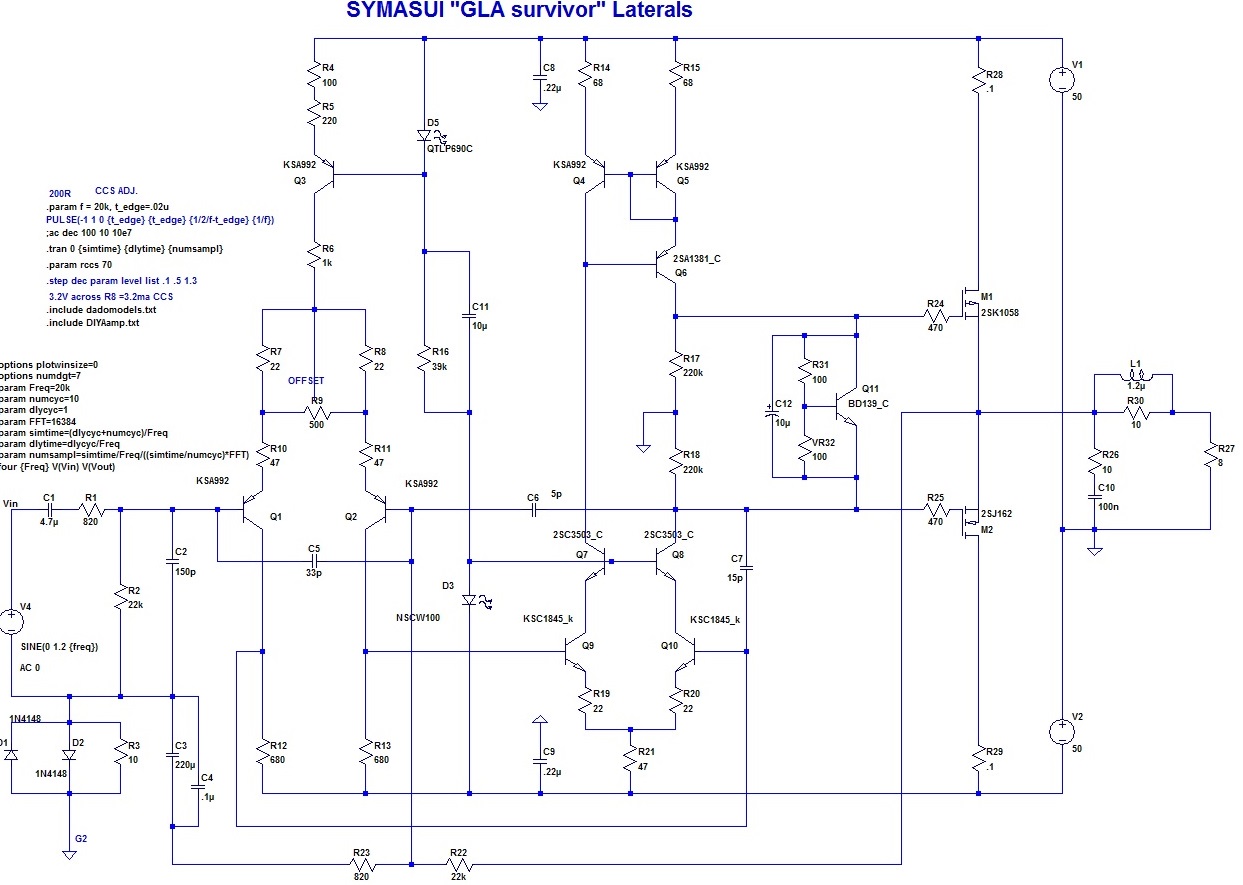

OK, I added a VBE and removed the diodes. I runs nice in spice. The overall THD is quite low but looks like H2-H4 are higher than usual. Maybe I'm reading it wrong.

Anyway, please have a look and maybe run the spice file and let me know what you think. Looks like it would be fun to put together a really small OPS to have fun with.
Blessings, Terry

Make R31 and VR32 higher in value, something like 2K2. At 100R most of the bias current is going through those and the transistor isn't doing much. Vary VR32 until you get about 100mA of idle current.
R24 and R25 can be lower too, perhaps as low as 100R.

Terry, I found a few errors. Try out this file. I put models from my collection in just for my convenience and put them right into the LTSpice file. The variable resistor in the real VBE multiplier would be a 5K pot near its middle.

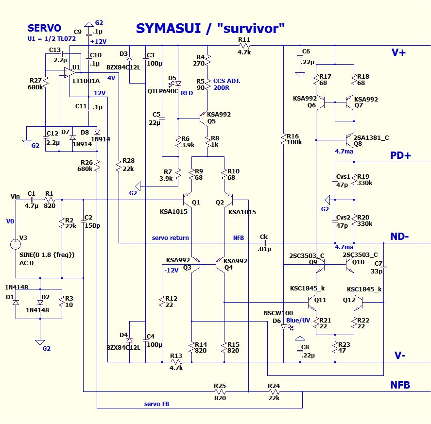

EDIT: Which post did you find that schematic in? The 'final' one in the GLA thread looks nothing loke the one you posted in the spice sim.
EDIT the EDIT: Never mind, found it!

Hi Jason,
I thought the schematic I used matched the one for the boards you made the layout for. If not can you tell me which one you used so I can make sure it will work?
That file runs nice but even with 20K in VR I couldn't get the bias down to 100mA. The error log shows low THD but the harmonic profile is not so great. Still, if I can figure out how to keep the bias to a reasonable level I would like to try it. Any idea why it sims so high?

The asc file you posted had the N and P MOSFETs reversed. Which layout are you referring to? Symasui?
Sorry, I didn't mean to change the IPS. I thought I was using the correct Schematic. I thought it would be ok here because I want to use my Symasui IPS and probably my CFA-XH boards with it. The same ones you are selling. Please give me the schematic you did the layout from and I will use that.

No problem. The GLA is a prior iteration to the Symasui. The attached schematic is what the Symasui boards are based on.
Well not so different after all. The earlier iterations were just drawn differently and some features changed or added. I got all the different versions mixed up. My apologies.

I did the best I can but just can't get it to work. Maybe you can take a look when you have time. I added KSA1015 to the list since that is what OS used. Not sure if my model is correct so you may want to look there first. If you thinks the guys here who are buying the Symasui boards will not be interested in this I will be happy to take it to the other thread.

Q3 and Q4 are KSA992, not KSC1845. Runs after correcting device choice. You have the correct symbol (PNP), wrong part (NPN). Also name the node where the MOSFETs join as vout so you get the fourier (THD) of the output, your THD was for the input node. The output THD, as it would be expected, is vastly higher. An EF buffer might help, but then we go adding complexity back into the mix.
