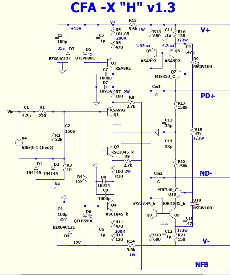

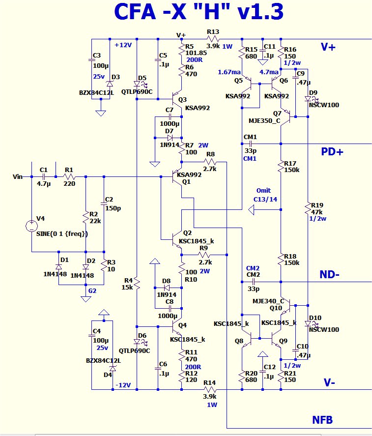

Sorry to be the one who always has the painfully basic questions but here goes.
For position r13/14 on the cfa-xh what value? 3.9k or 5.6k? I have a set running with the 5.6k and I note that the resistors are HOT. I checked voltage drop and it's at 65 volts...80 volt rails. That's about 11.61ma or .75watt on a 1 watt resistor. Should I use 3.9k on my new build or stay at 5.6k and use a higher wattage resistor.
Thanks, Evan
Thanks, Evan
Lower value resistances are for lower voltage supply rails. You could squeeze on a 2W resistor in those locations and stand it off the board. I believe the 5K6 value was optimal for 60-70V rails, you could likely go up to 6K8 the reduce dissipation and still provide enough current to operate the shunt regulators. Whatever you do don't reduce the value! The current will increase and dissipation goes up with the square of current.
