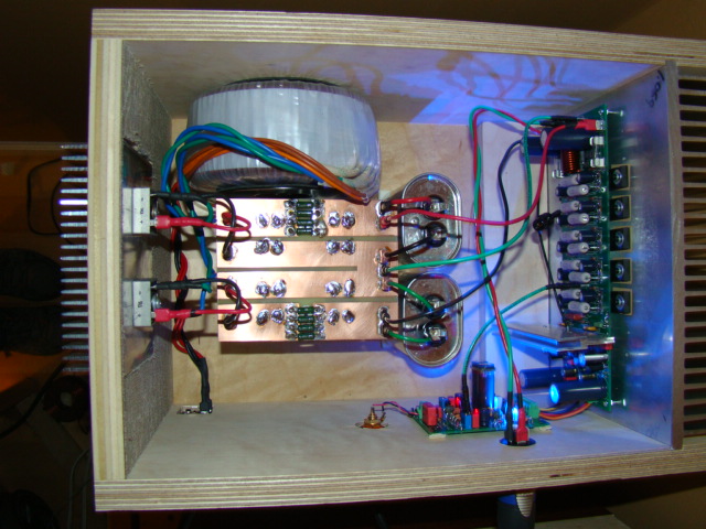

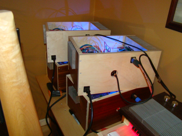

All 4 channels running, Now from everything but the subwoofer is slewmaster driven. Sounds very nice.

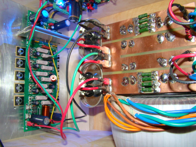

Just firing up 3 pairs of OPS and CFA-XH, things went well with no burning smell 😀.
Just a couple of questions about setting it up. I use 32AC which is about 45VDC rail.
I summarized my understanding below, Please verify if these are correct.
IPS
1) I measure across r13 and r14 (value of 3K9) in CFA-XH, it reads 30V which around 8ma. I should decrease r13, r14 so that the current is around 15mA.
2) Pot R5 and R12 in CFA-XH are for adjusting DC offset and CCS current, and the CCS can be read from R6 and R11 are these correct?
3) I adjust Pot R5 and R12 the same way as vssa. (one meter on SPK out and another one across R6 or R11 adjust so as too get desire CCS (which is 4-7ma?) and almost 0 DC offset.)

The 8mA for the shunt regulators is likely fine, though you can run them at a higher current if you like, understanding the resistor will run hotter. The CCS current can be verified across R6 and R11. Adjust it in a similar manner to the VSSA, monitor CCS current and offset. Set your OPS bias to give about 60mA per pair, measured across the 0R22 resistors.
Sounds like you are on track.
