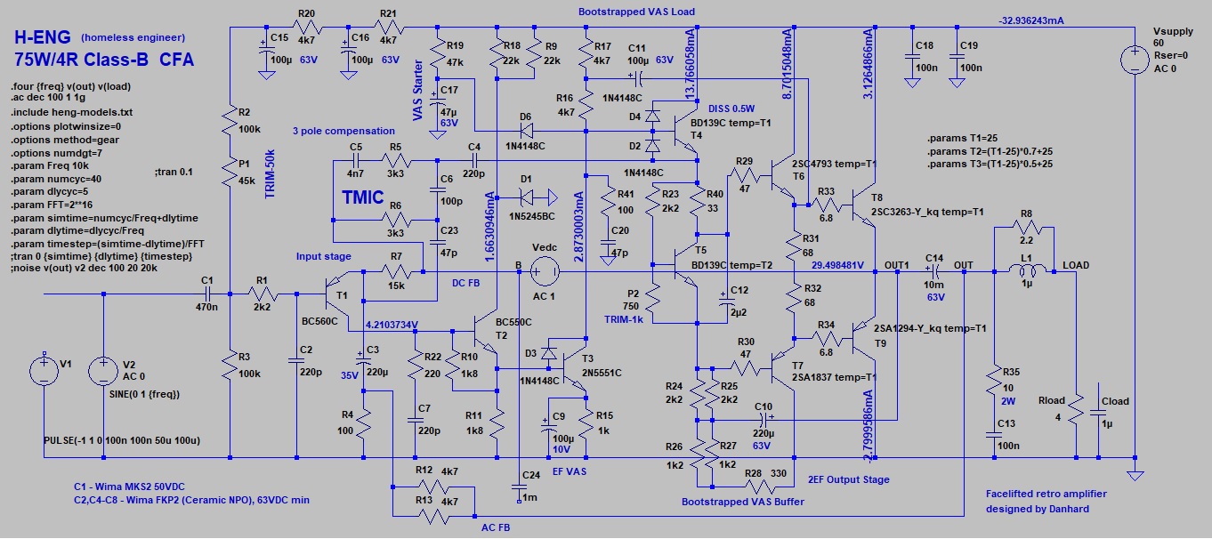

TMC is only single pole compensation for VAS.
Slow Rate determines the integration of the excitation current VAS and Cdom.
TPC presents lighter load for IPS.

If IPS standing current was higher (cc 2mA) it would be sufficient for TMC too.

And then could try splitting C4 into a TPC network as well?I would connect R6 to ground.
TPC + TMC has the same benefit as 3PC

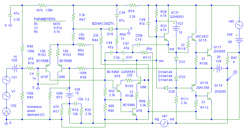

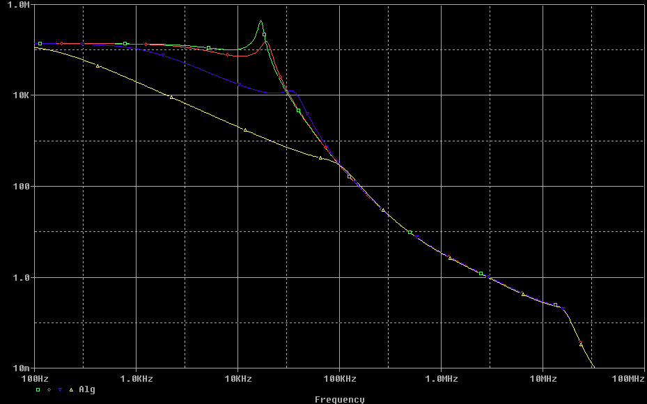

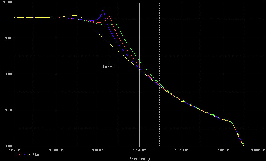

Effect of TMC tuning, benefit at 19kHz is 30dB Ry = 2k2 4k7 10k 1G (only TPC)
Degradation loop gain parasitic capacitance Cx = 0.001 0.01 0.1 1 pF

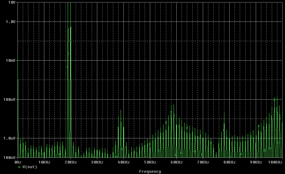

IMD1920 can then look like -140dB 😀

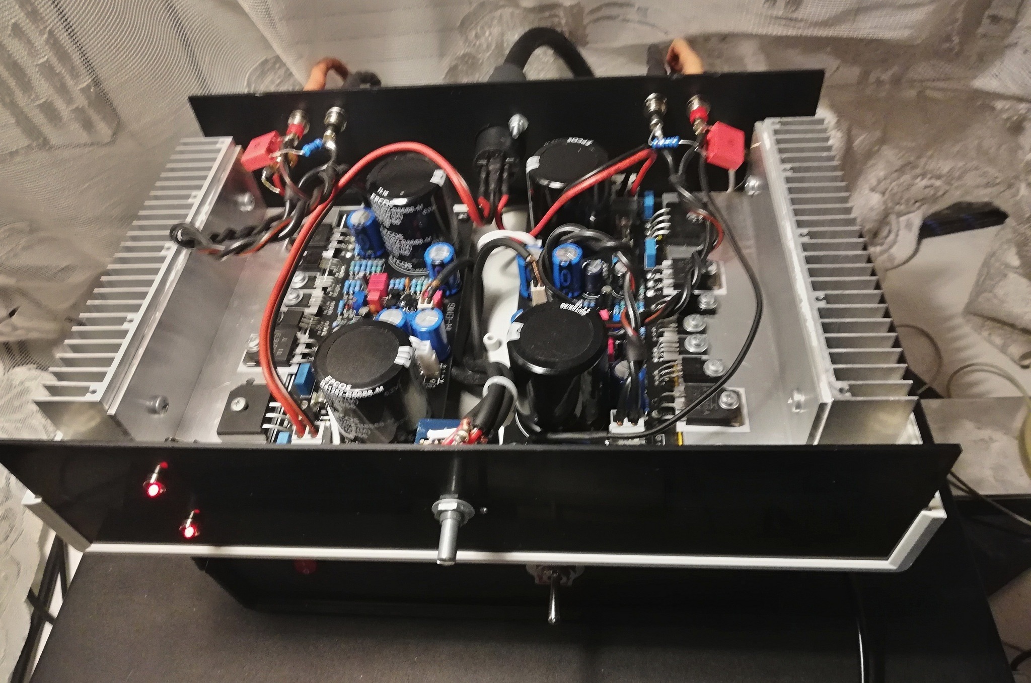

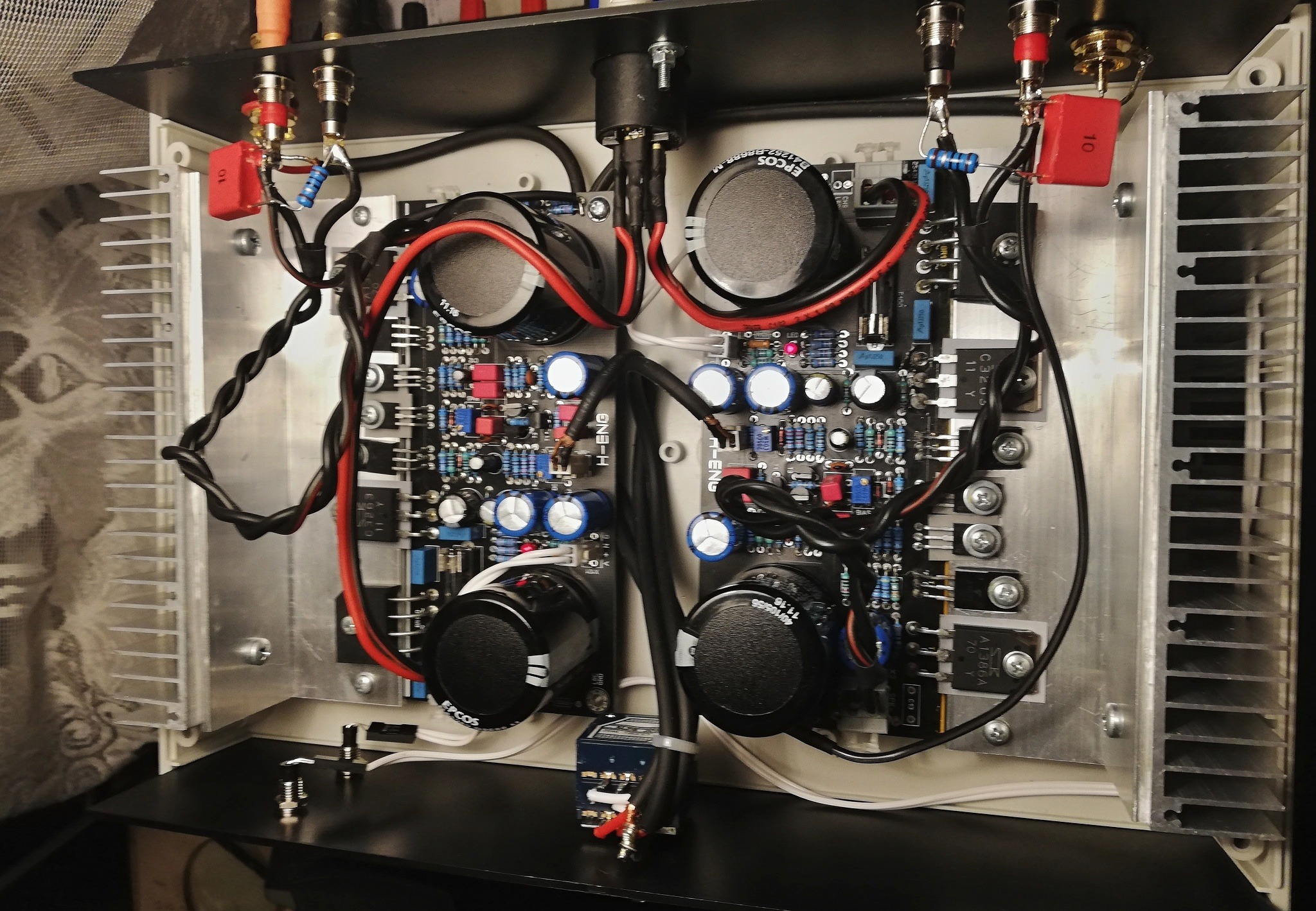

Nice one! I am almost done with mine too. I just have to wire up the inputs and outputs.Hi all, my first post on Diyaudio (but have been reading for quite a long time). My H-ENG built from prototype PCBs. Power supply is external made for both Danwatts (orig and fast) as well.
I noticed you didn't go with the inductor on the outputs?
No, I have Zobel filter instead (as recommended by LKA)Nice one! I am almost done with mine too. I just have to wire up the inputs and outputs.

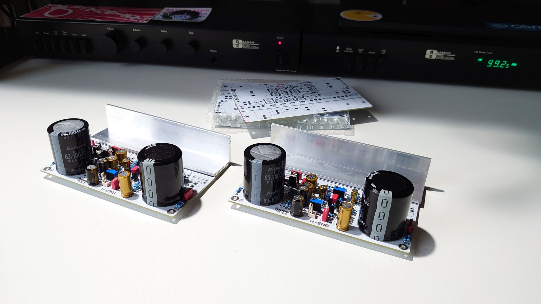

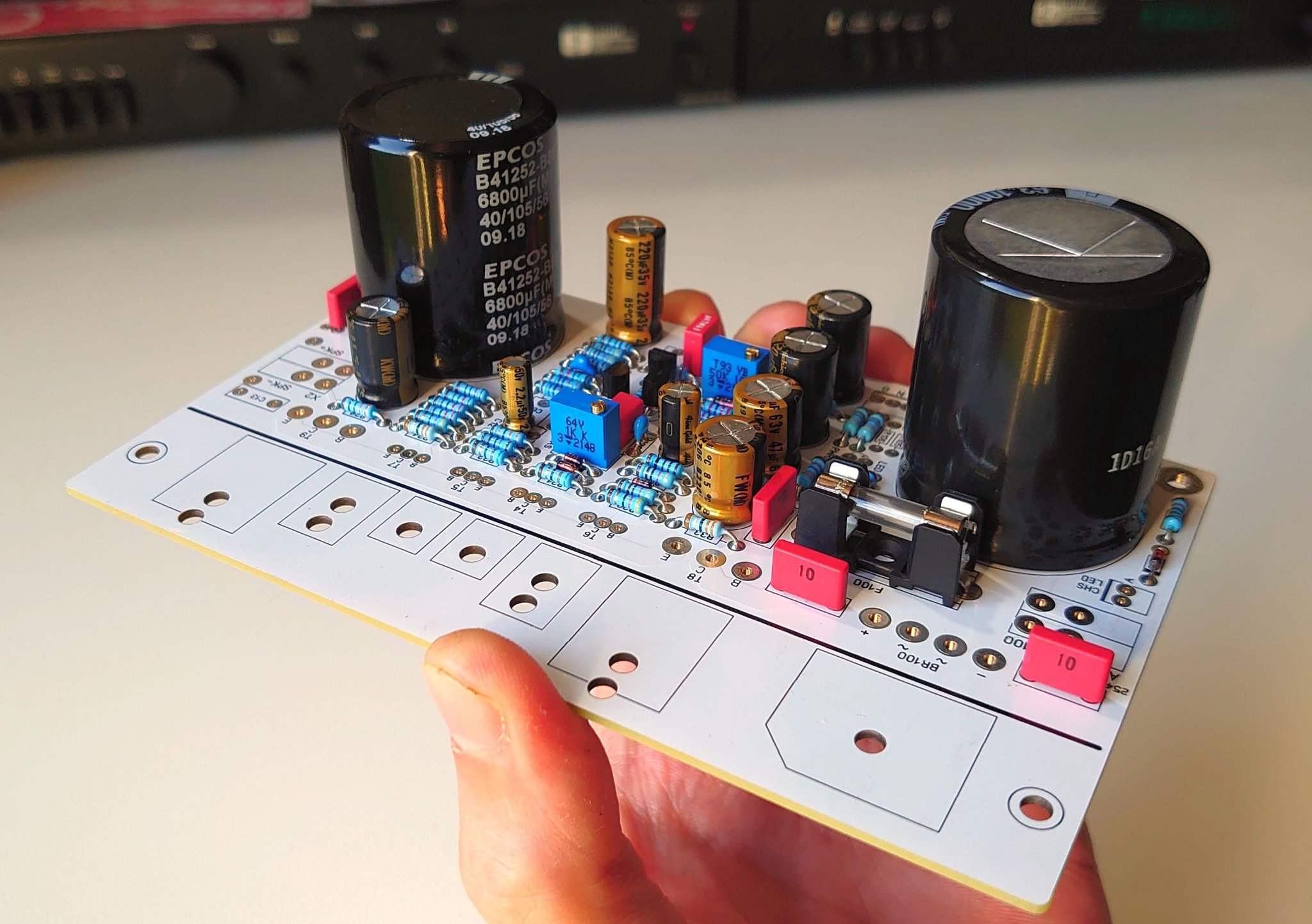

I completed my build earlier this month, with much advice and reassurance from @LKA - thank you again🙏

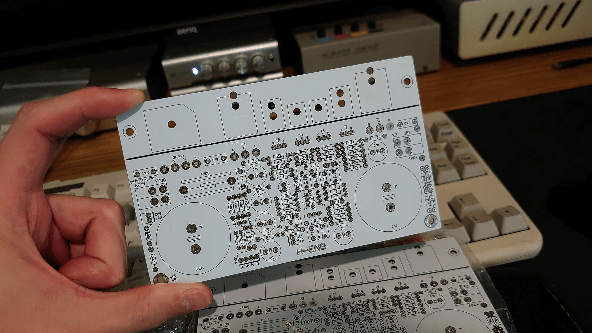

If anyone is interested in building this amplifier, I can offer my spare PCBs for the cost of shipping. Note that I am in Australia.
I have 6 spare PCBs.
I created a spreadsheet with all the required PCB components here: https://1drv.ms/x/s!AvzFj8fCrWcFgpEjywm3CmvUR7oY0Q?e=v63TWf
I am quite happy to help where I can if anyone wants to take this project on and has questions.
Some pics:

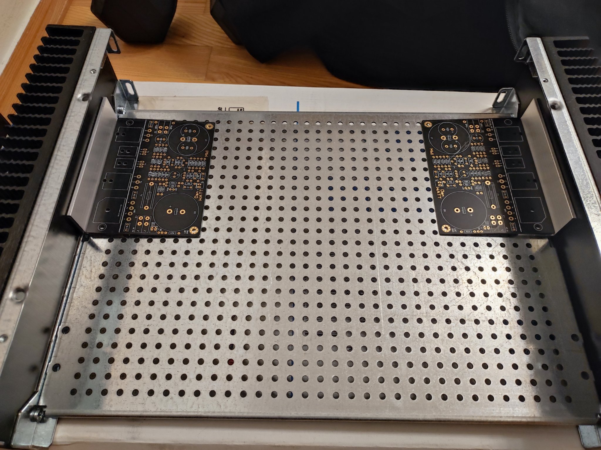

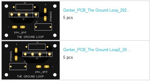

Hi, I am currently working on the Danwatt MK2 version. It's similar to the H-ENG, 2 transistors less but sonically similar...
How satisfied are you with the sound of the H-ENG?
My design will be dual mono, mirrored pcb (amp + ground loop) 2x 150W toroid + 2x 12.000uF
+ Mirrored pcb The groun loop are on their way...
@HRDSTL Very pleasing, a lot of resolution. Recently bought JDS Labs 3-ch. eq. For digital source now testing Topping D90. The most pleasing is the fact that after hours being on and playing, it is cold with very small heatsink. The power output looks to me very close to both Danwatts. However, original "slow" Danwatt is much more warmer (especially BD 139 driver working in A-class).
Very satisfied although I would not say that I have golden ears or anything. I imagine that people are more predisposed to enjoying things that they have created themselves, and so I say with some reservation that it is my favourite amplifier 🙂
It pairs well with my ESP P97 preamp build - I feel like there is a good synergy. I have it hooked up to a pair of Canton Karat 40s in my modest lounge room and honestly, I could not be happier with how it turned out. In fact, I want to also make the Danwatt Mk.2 now just to see how it compares but I'm not sure how to get hold of the PCBs + BOM for that project.

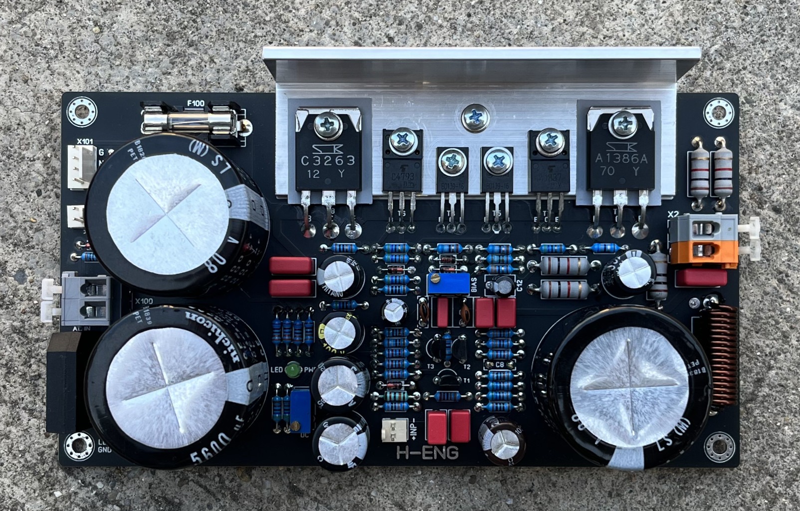

A beauty 👌latest pcb version
- power supply with two capacitors
- added output RL network
How much wider / taller than the original?
- Single supply, three-pole compensated class-B retro amp
