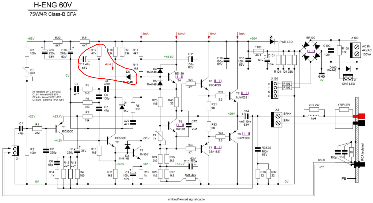

Hi LKA,
What is the reason for having the parts in the red circle? Also, what is the purpose of the diodes across the transistors? Thanks!
if i am right...input limiter - T4 should not get more wave of 0,7Vpeak
chris
chris

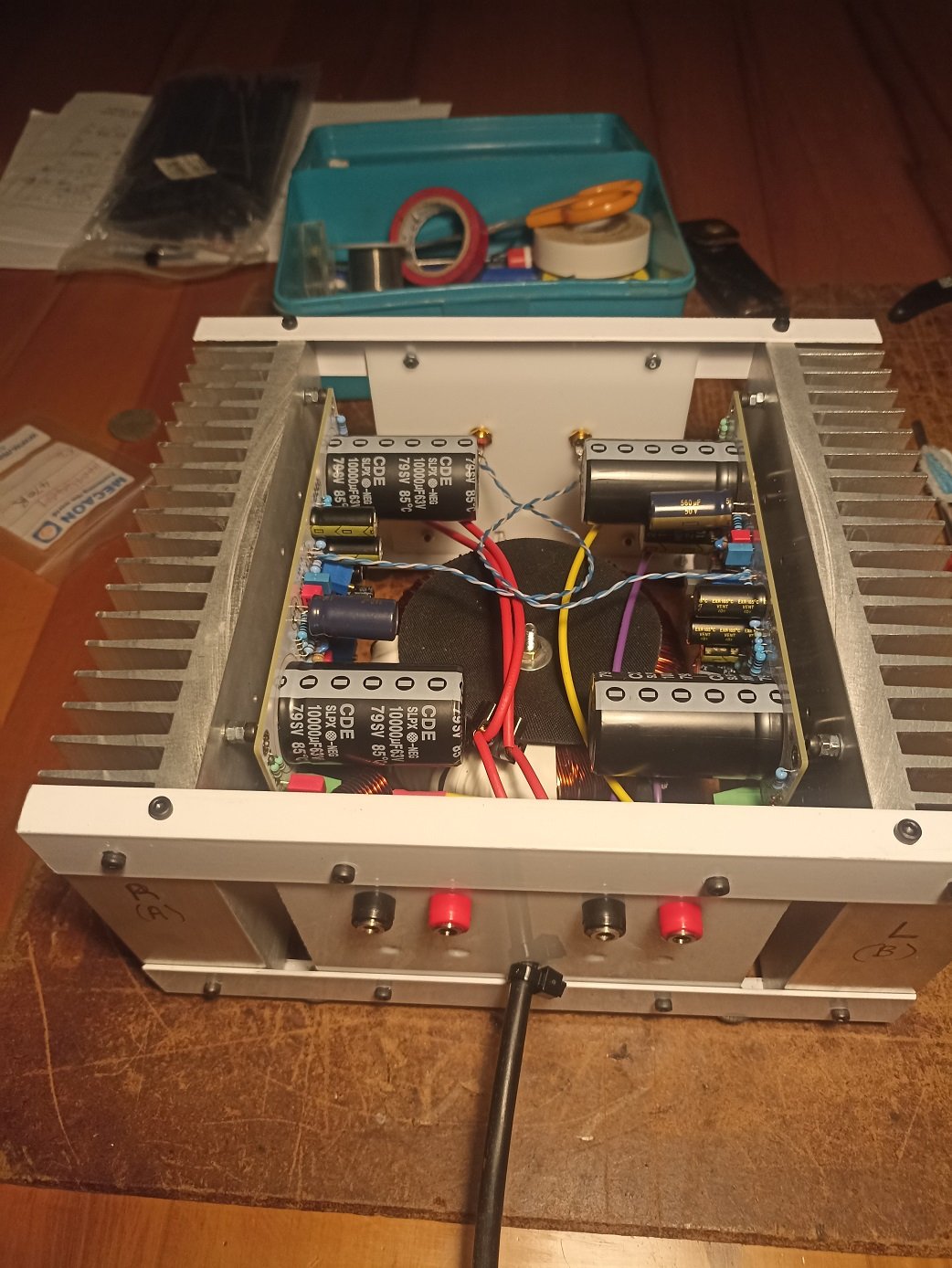

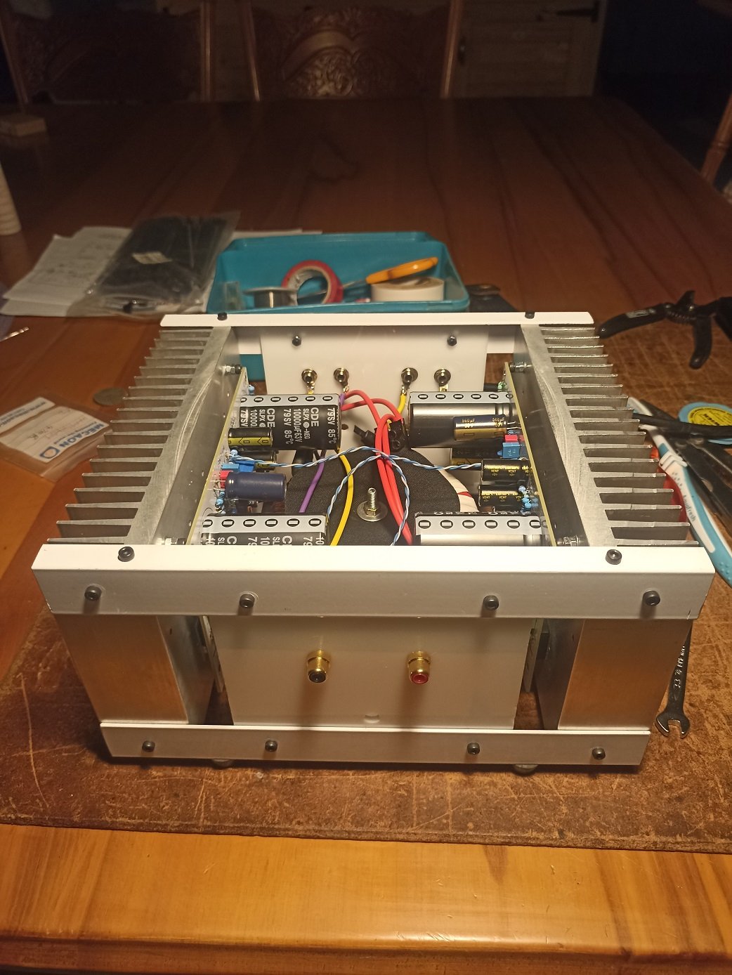

It’s alive and working! And a huge thanks to member @002 whom I got the boards (and some components) from. At the point when I gave up looking for the mistake he encouraged and helped me to find the fault. Finally got the voltages correctly dialled in and bias set at 35mA.
What does it sound like? Very, very good. I am very satisfied so far. Difficult to say if this amp sounds better or same as my previous Class A amps, but the fine details, tone and overall balance sounds very good. It will take some more serious listening to evaluate the sound stage and imaging, which I haven’t done yet. I like to spend a lot of time listening to most of my familiar music with a new amp, before making any judgement.
The reason I wanted to build an amp with this particular topology is because I wanted very good sound, but without the heat. And I think I have achieved that with this build. I am done with hot Class A amps.
For this amp I re-used the enclosure which housed a Pass ACA (Class A) amp. I called it my Meccano amp. So, the heatsinks are probably a massive overkill for the H-ENG, but that’s ok. As you can see from the pictures (taken very late at night) the space is very cramped inside and I had a hard time fitting the toroid inside too. I pick up a slight disturbance/hum which I think is because of the open toroid so close to the boards and signal wires. Think I will remove the toroid and make an outside shielded ac psu for this amp later.

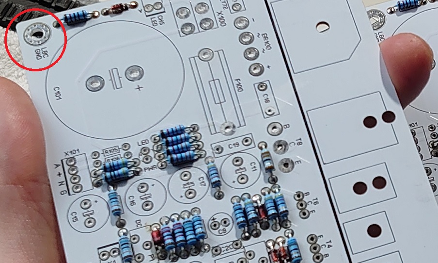

I have an issue what seems to be a ground loop problem. Just trying to understand and wire everything correctly here. What does "LBC" ground stand for, and how should it be connected and wired to the chassis and PE? I see PE on the schematic, but not the LBC GND.
Thanks.
Thanks.
Do not use LBC (Loop Breaker Connection point). Make sure you only have a single point connection between PCB ground and chassis (at RCA input). Did you use a dual mono arrangement? You should.
It is a great topology. The 2 transistor plus 2 fets delivers 100 watts at 0.005 thd.
A 3rd transistor gives Constant current to VAS transistor knocks down thd more.
Thanks - got mine wired like this.Do not use LBC (Loop Breaker Connection point). Make sure you only have a single point connection between PCB ground and chassis (at RCA input)
Nope - currently sharing a single pair of secondaries for the two boards. I tried to unwind the toroid to bring down the voltage of the secondaries to around 40 VAC but could only manage to do one of the two secondary outputs. Ok, so two toroids on the shopping list for proper dual mono.Did you use a dual mono arrangement? You should.
