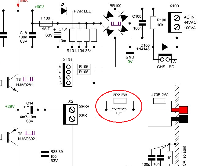

I am (finally) busy building this amp using boards I generously got from @002 all the way from the Outback. @LKA, just a stupid question about this section of the schematic - it looks like a typical Baffle Step Compensation circuit between the amp and speakers. What is the purpose of this circuit, and can I safely omit this section without ill effect if I’m already running my speakers using a BSC (4R7 + 1mH inductor)?
Inductance there is usually to prevent capacitive loads from destroying the amplifier through RF oscillation.

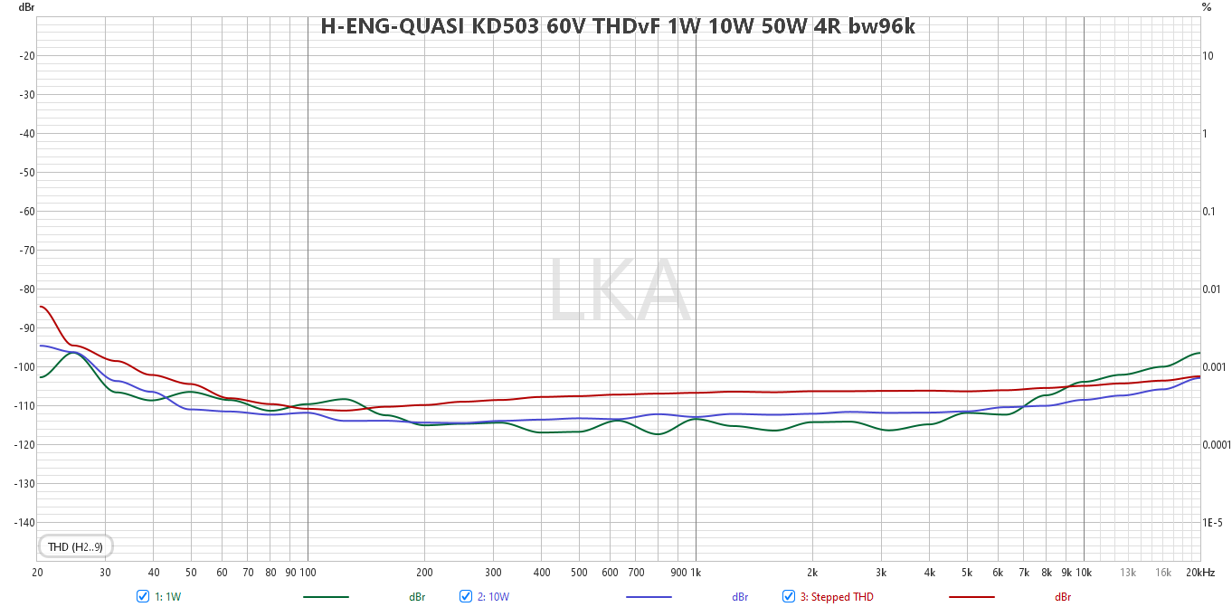

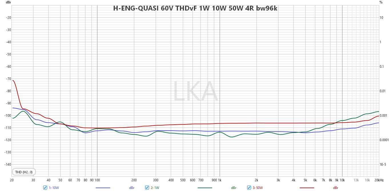

BTW, I recently experimented with quasi output, tried slow transistors like KD503 (2MHz) and MJL21194 (4MHz). The result is quite satisfactory.
KD503
MJL21194
KD503
MJL21194
Thanks Mark. I have destroyed amplifiers before, but because of my own stupidity. 😊to prevent capacitive loads from destroying the amplifier
Trying to avoid this now as best I can.

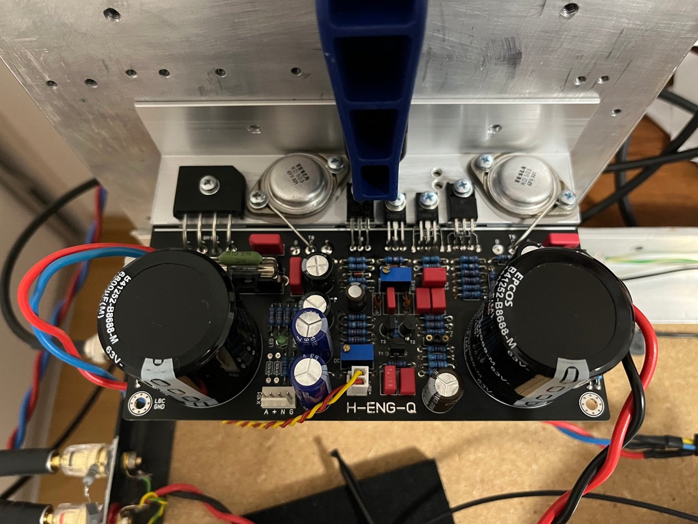

I seem to have a problem with my 60V build and need some assistance please. Boards are populated and mounted on heatsinks. I am following the startup procedures, but I am not getting the correct voltage in step 5.
The toroid transformer I ordered was for a 150VA 2 x 44V secondaries. The toroid I received says 150VA 2 x 47.5V secondaries but actually measures 2 x 49.7V ! I took the chance and hooked it up.
Step 1 says measure the voltage of the power supply with no fuse installed. I measure a whopping 70.3V. But the problem starts at step 5 - with a 1K/5W resistor in the fuse holder (which actually measures 1.04K), I only get a voltage of 6V (instead of 30V or what should be around 35V with my transformer) behind the fuse. The same problem with the other board.
Any suggestions on where to look for the fault?

I turned P2 fully anti-clockwise before applying power. Is that the same as counterclockwise?
I realise that 70V is looking for trouble with 63V caps. I will have to drop the input voltage - get another toroid.

Question - can I run this amp on lower input voltage (say 50VAC or 40VAC) without ill effect?
hi twocents
you mean rail voltage!
with 40VAC on the secondaries you get about 56V on the rail
with 50VAC you get 70V too much for your caps(63V)

i would change this caps. an give new onesYou have higher idle current than a usual 30mA. Did you set the P2 to the highest resistance ?
I you have used 63V elyts you will get into trouble with 70V supply.
