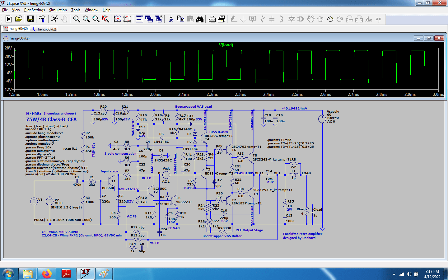

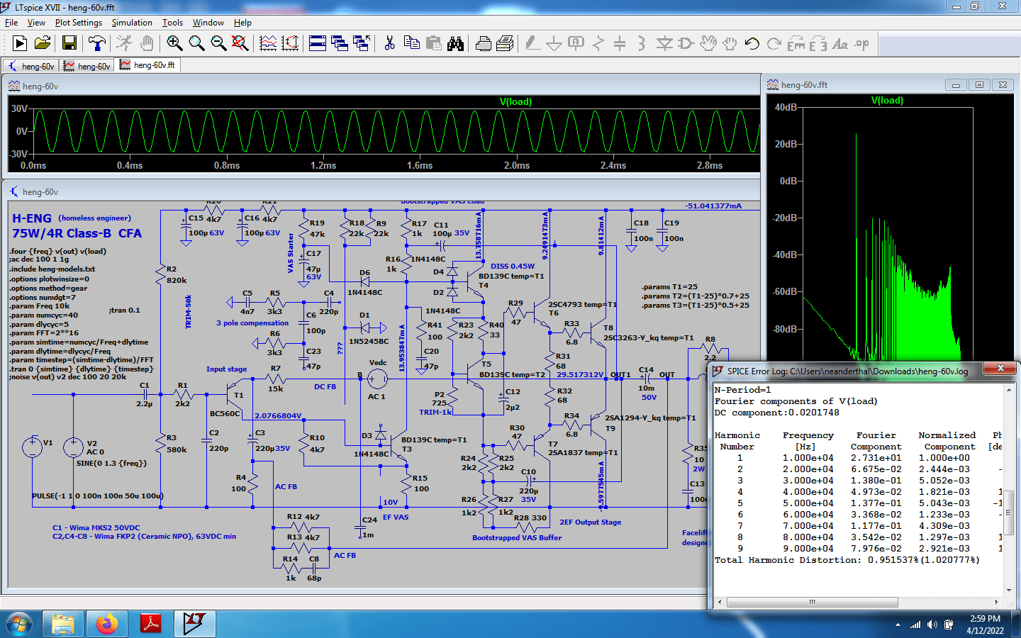

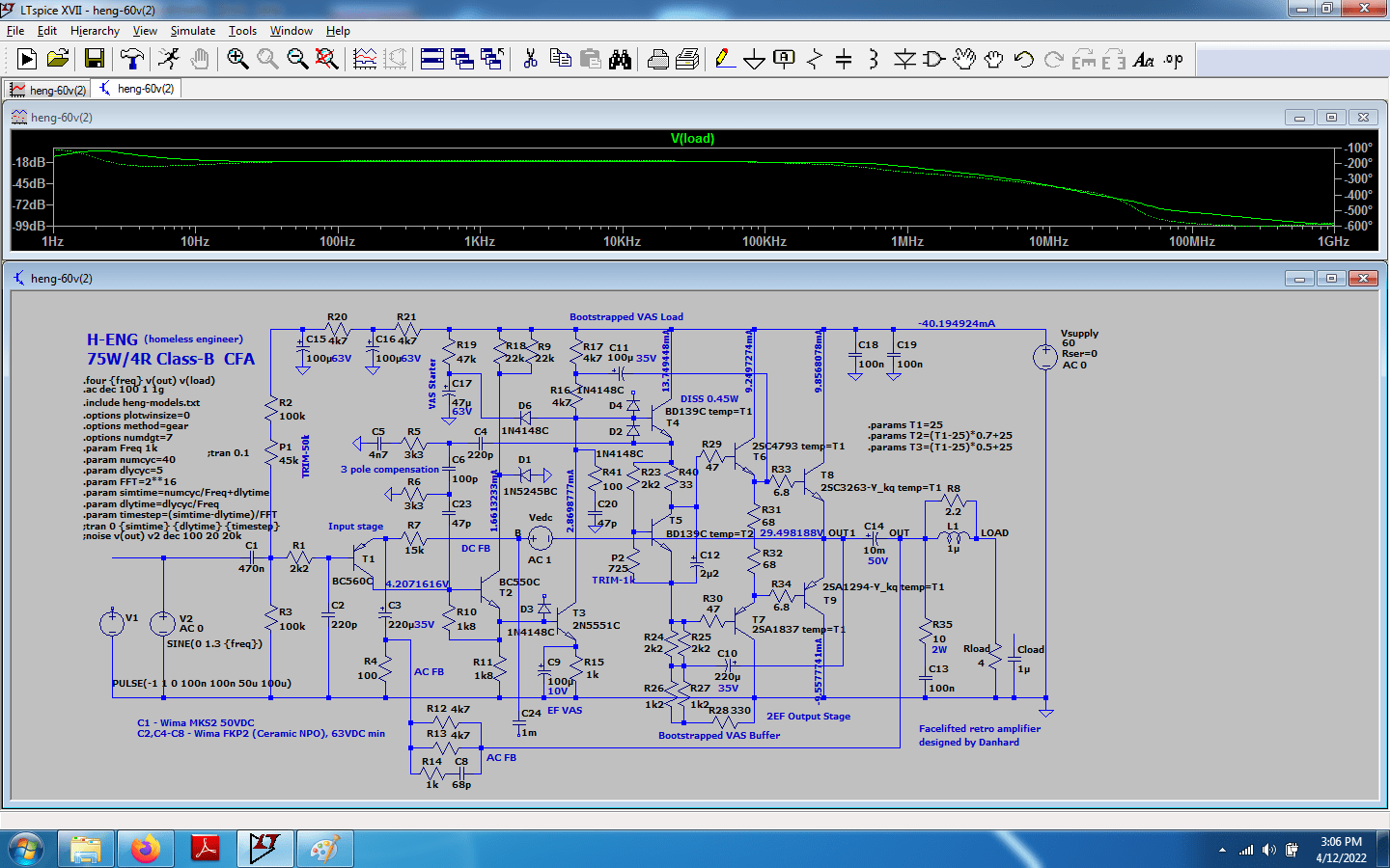

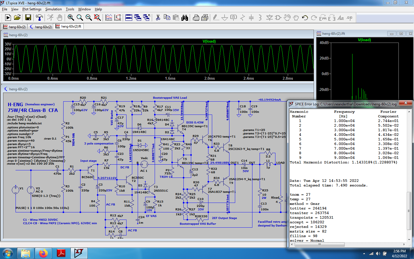

I thought that 10khz distortion isn't really that important...
It is important that an amplifier can handle frequency components of the order of 10 kHz without producing excessive intermodulation distortion. Of course the best way to test that is by doing intermodulation measurements, but a 10 kHz THD test also gives a rough idea whether the amplifier can handle signals in that frequency range well.
Do you see what you did ? Keep the modifications to yourself when you know nothing. I regret to publish the schematic.
  • Thank You
Reactions: PRR

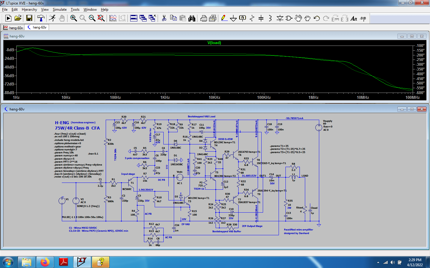

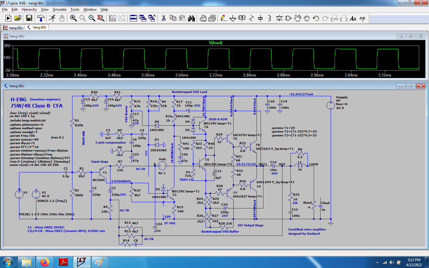

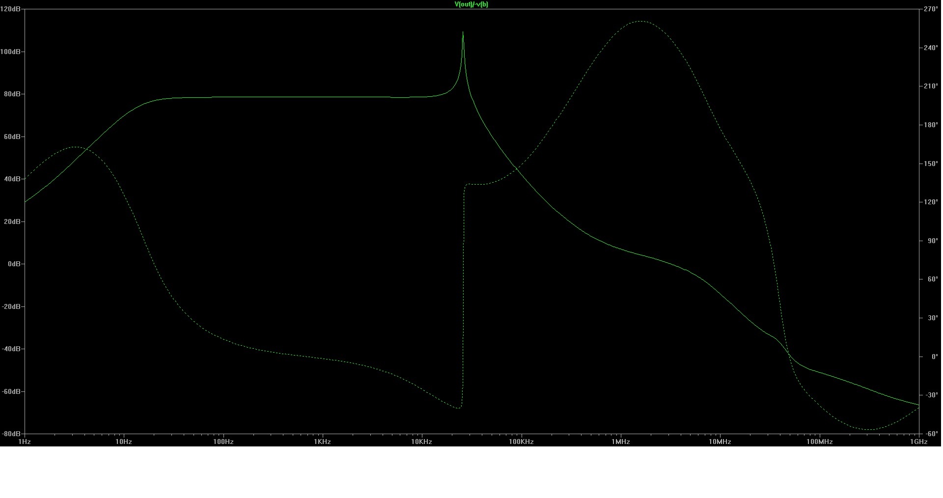

I chequed the step response and the bode plot with the simplified versions...looked fine to me, but honestly i'm not an expert in this kinda stuff.0.05% thd at 10hkz and close to clipping point is decent for any amplifier. Anyway ne5534 seemed to have 3rd pole compensation and almost nobody likes its soud for some reason...I just wanted to see a decent amount of even distortions cause i see no reason in having all that grass up to 1 meghz higher in level than the secod harmonic at 1khz.

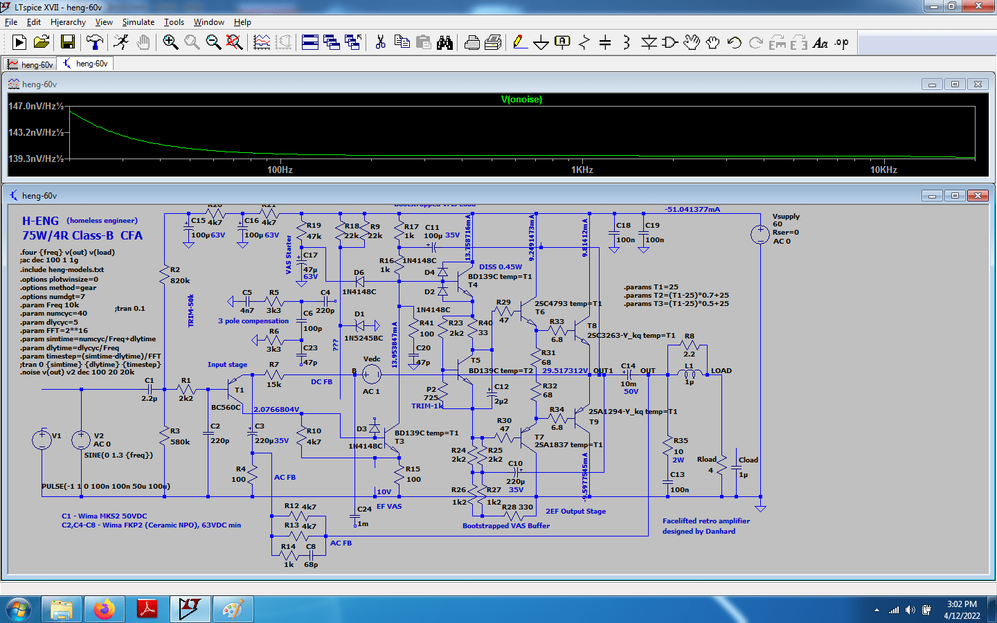

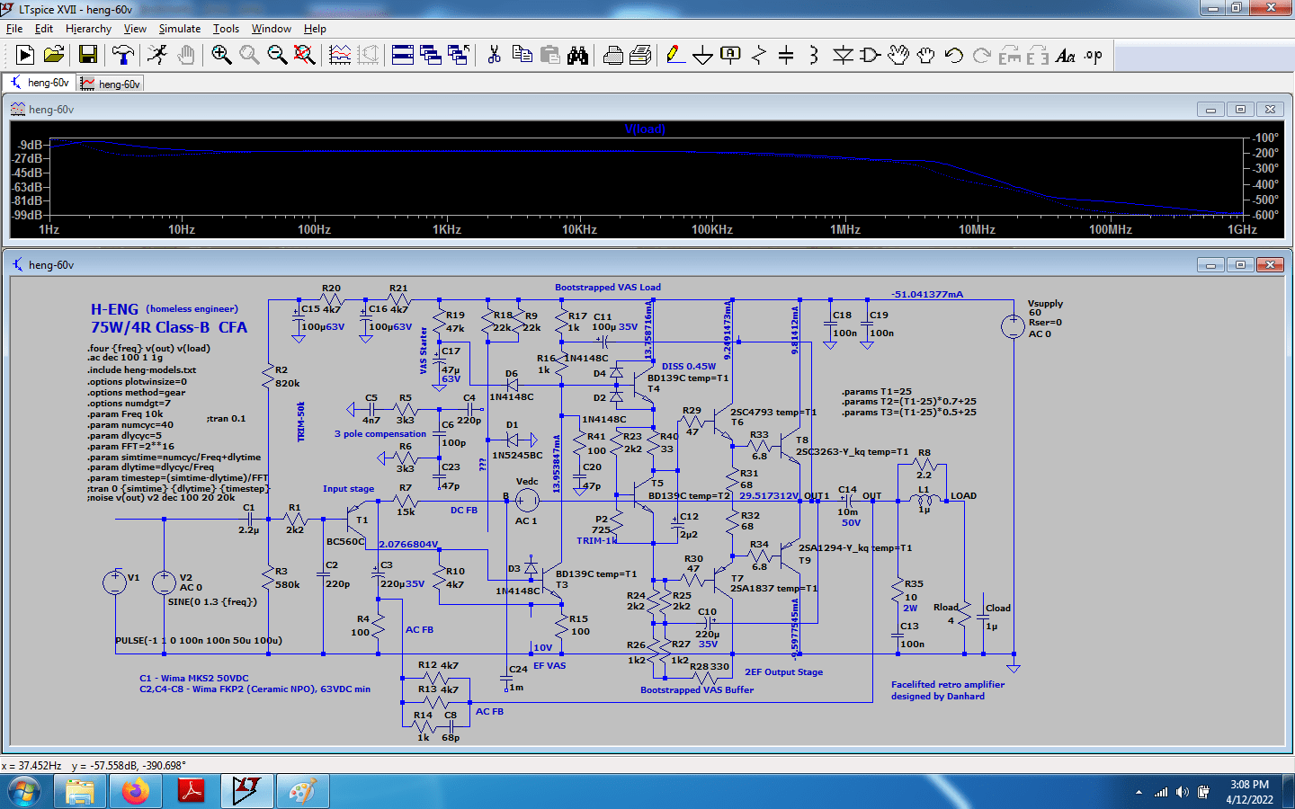

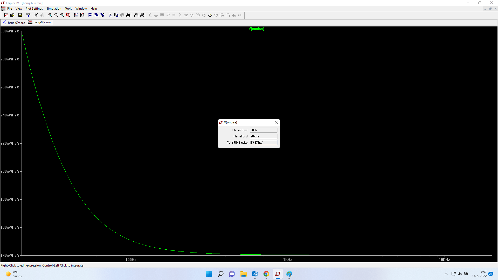

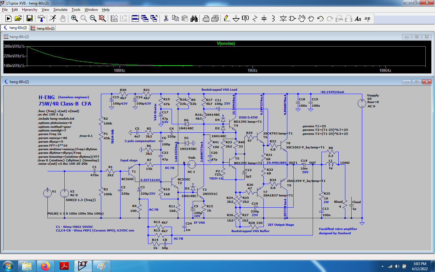

I just wanted to play around for a bit...sorry to bother.What i didn't really like was the input resistor divider values which implied more noise at lower frequencies than usual.There's no point in having higher input noise than output distortions...
Just some small mods and I actually get better at next to clipping thd, noise, and step response, the only place where the original design gets just a little bit better being the bode plot, difference being small...and i used all your default commands...I spent just a few hours on your schematic, but I let you get the best out of it cause i have better things to do honestly.Besides I never use a .noise command, the noise can be seen on the thd graph ...

I never saw 3P compensated amplifier so I tried to build one. The basic design is come from the local forum's guru, Danhard. I made fine-tuning to adapt it to the real conditions. Three boards were built

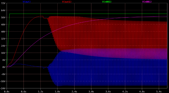

I'm interested what the power-on and power-down transients are like for the real version - I simulated power-on transient and saw out1 ride nearly all the way to 60V before recovering slowly, distorting the signal in the process.
Of course single supply amps are usually horrible at power-on and -down, but it strikes me that out1 should climb to 30V or so and not exhibit this behaviour. There are also some very long time constants in the amp, the 220uF C3 in the feedback coupled to the 15k (R7) for instance.

I’ve built a few amps so not a total noob, but this topology is new to me. I read the links at the beginning of the thread but still don’t understand the principle. What does it mean 3-pole in this context?
intrigued by this low heat high performing circuit that was or could have been made in the 60’s.

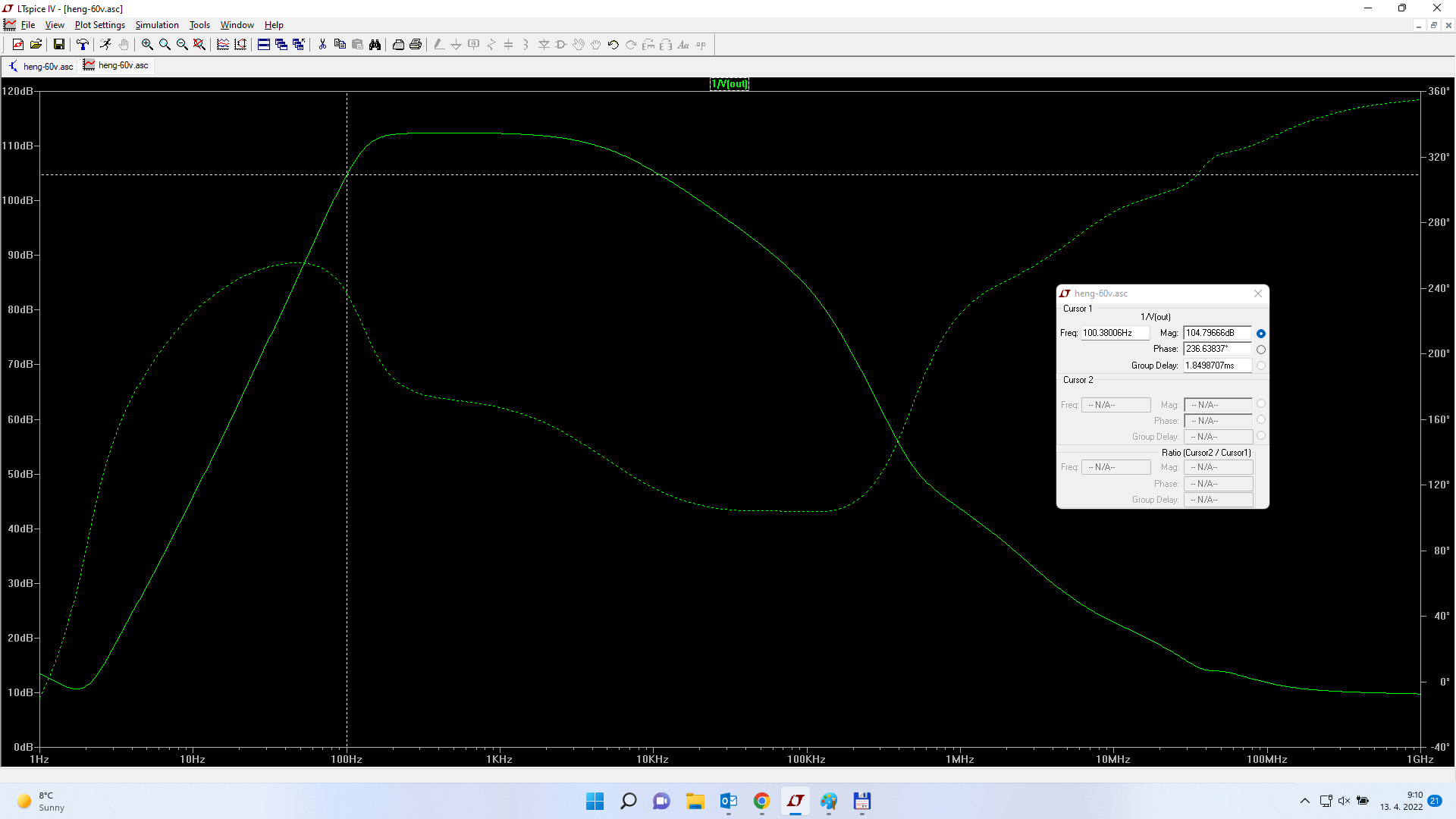

A very brief, perhaps overly simplified explanation:
Most amplifiers have their open-loop gain dominated by a single pole; their open loop gain rises at 20dB/decade with decreasing frequency.
Less common are amplifiers with two poles; their open loop gain rises at 40dB/decade with decreasing frequency.
Very uncommon are amps with three pole compensation; 60dB/decade open loop gain. Hence, mention of that gain slope in LKA's opening post.
