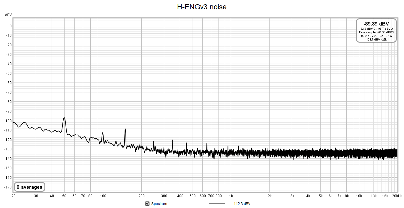

I measured the noise. (bandlimited to 20-20k) It's little higher than simulated. The input was shorted via 100R resistor.
UNW -89dBV
AW -95dBV
CW -92dBV

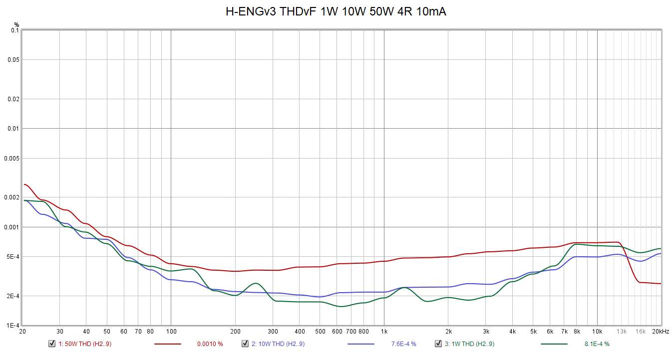

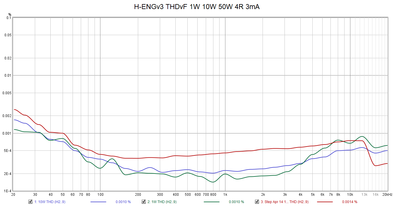

measurements - THD vs Freq at 1W 10W 50W 4R
output quiescent current 3mA and 10mA (10mA is the maximum without emitter resistors)

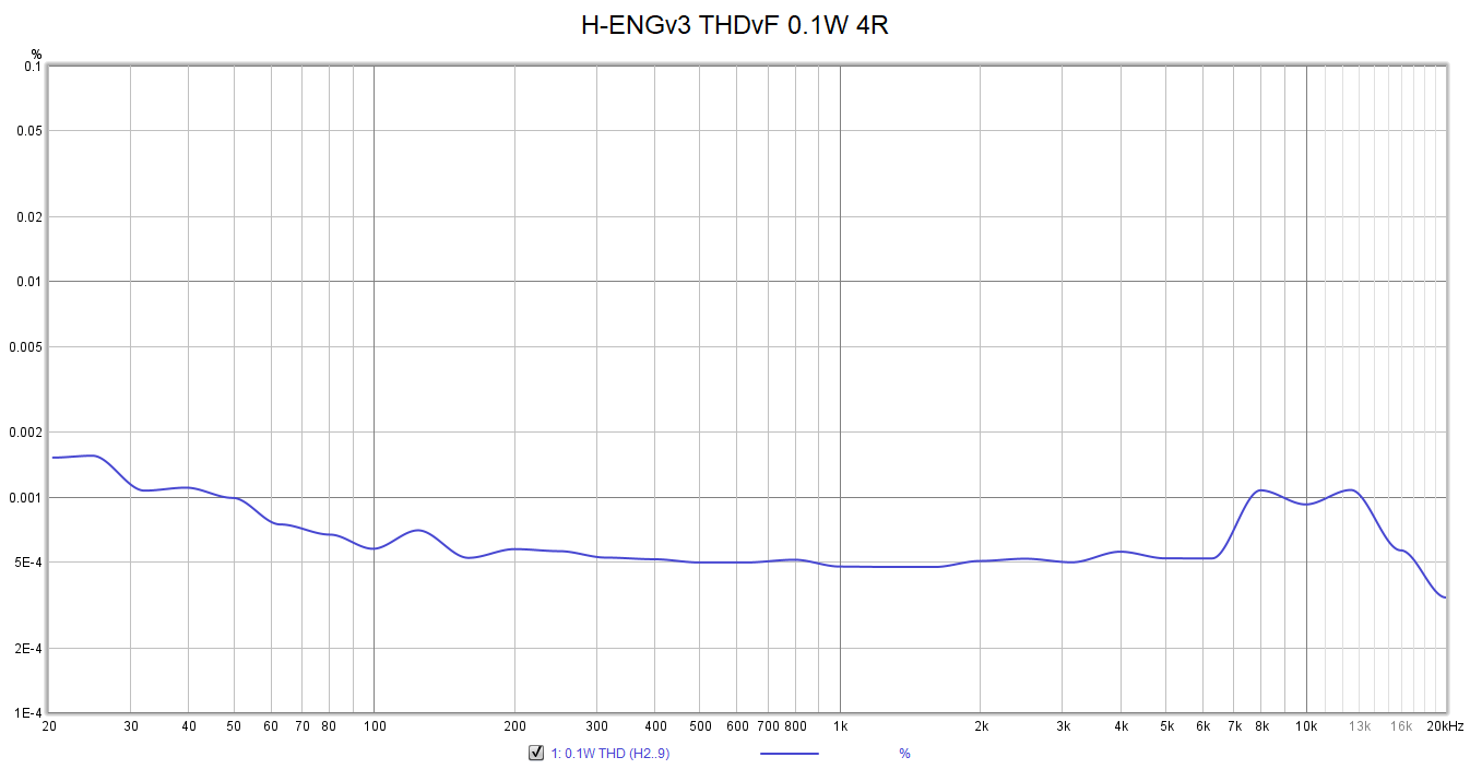

I'm feeling a bit mean here, but I'm noticing a rising distortion characteristic at higher frequencies for the 1W/3mA plot - more so than for the higher-power traces.
If this is indicative of crossover distortion, then a plot for 100mW could be very revealing.
As I say, I feel a bit mean because I think the work you've done here is really useful.

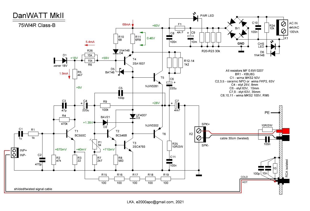

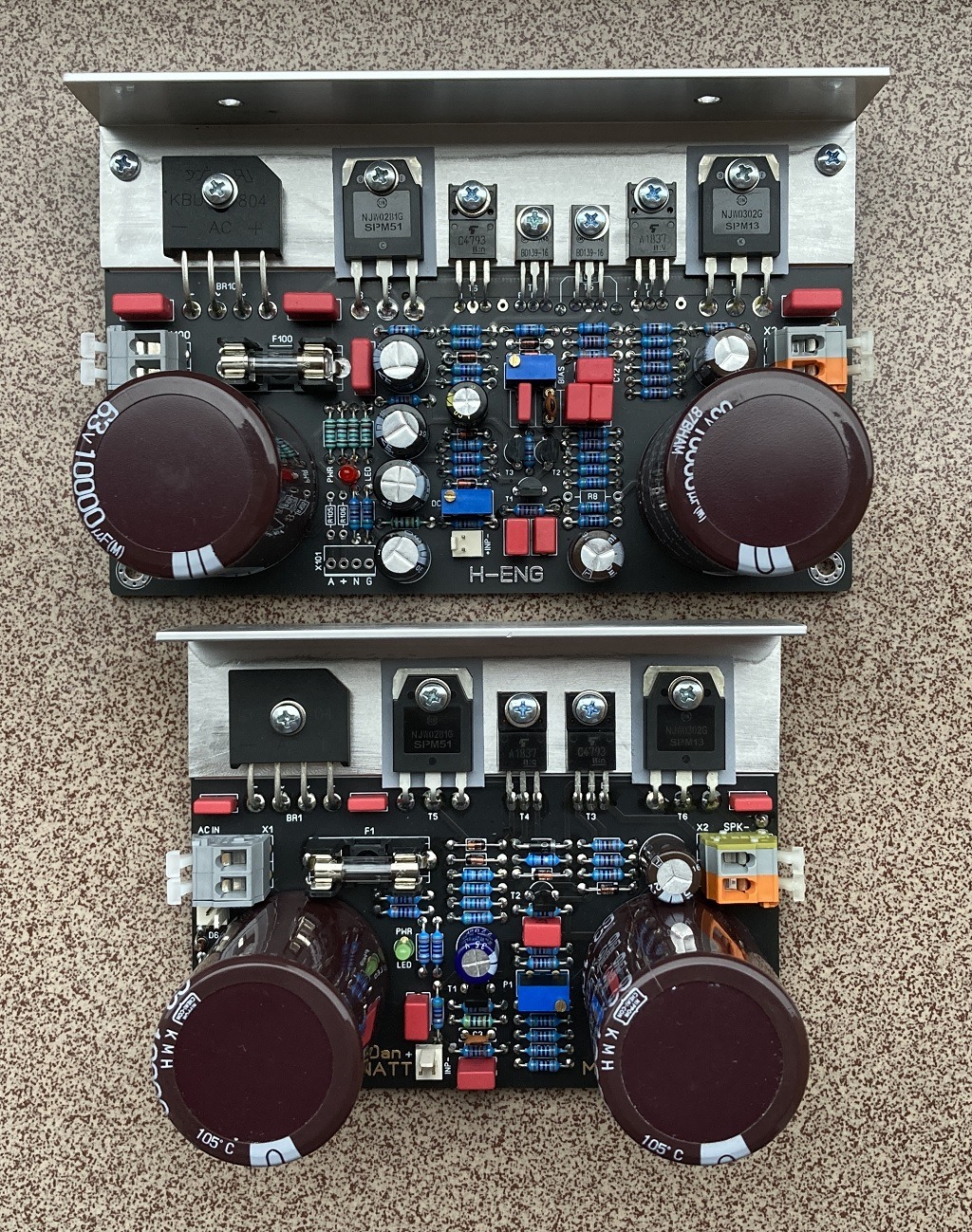

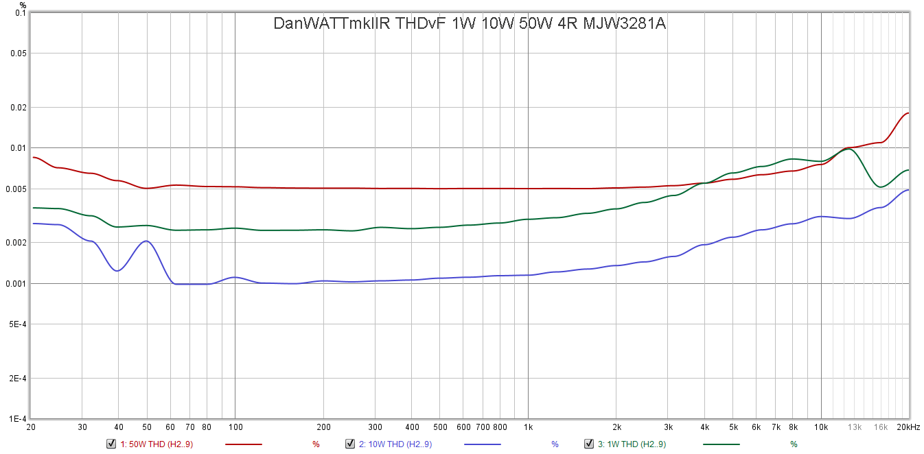

I can show you a simpler retro amp with very good performance, the DanWatt (class-b, current driven, designed by Danhard)

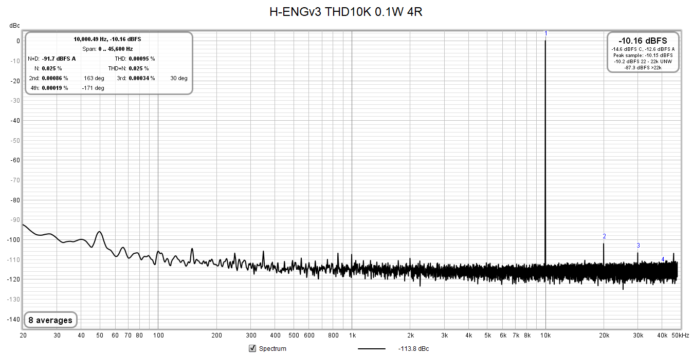

Lots of expectations ... it's a simple retro low-end amp. THD10K 0.001% at 0.1W/4R is bad ? imho not at all
Well, the fact that the increase in thd at 100mW is modest, relative to 1W, seems to me to show that crossover distortion is being controlled remarkably well. So I would have thought it completely inaudible for all programme material - by quite a margin.
I wasn't being critical, by the way - just interested in what seems to me to be one of the main reasons for wide open-loop bandwidth. Obviously, I wasn't expecting zero crossover distortion, as the hf feedback is there to reduce, not remove. Nevertheless, who needs those many exotic topologies if we have such a relatively straightforward solution?

For me I am attracted because of performance, simplicity of build, novel topology (already built several class-A and assembled class- D modules). I also highly value compactness. No 3U cases with ginormous heat sinks is a big plus.
