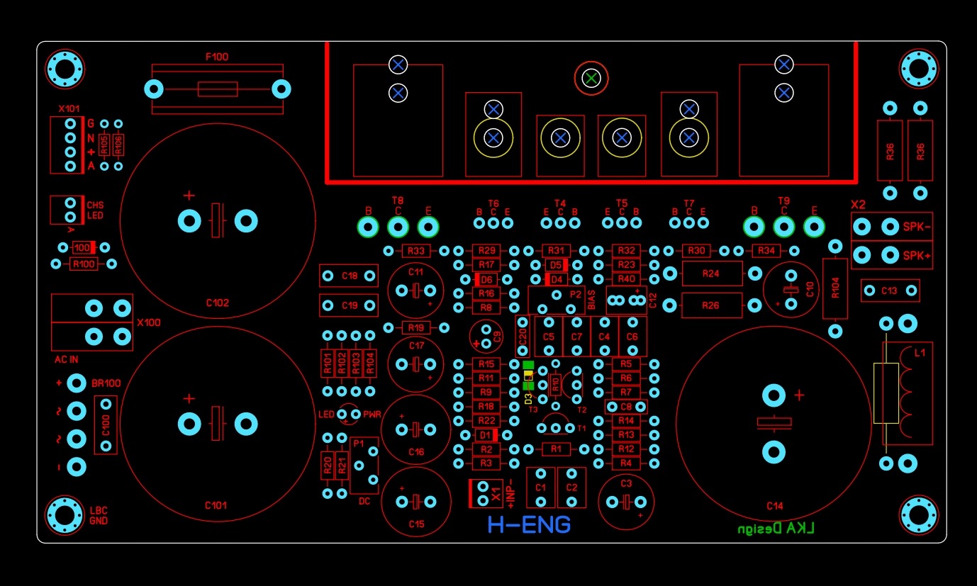

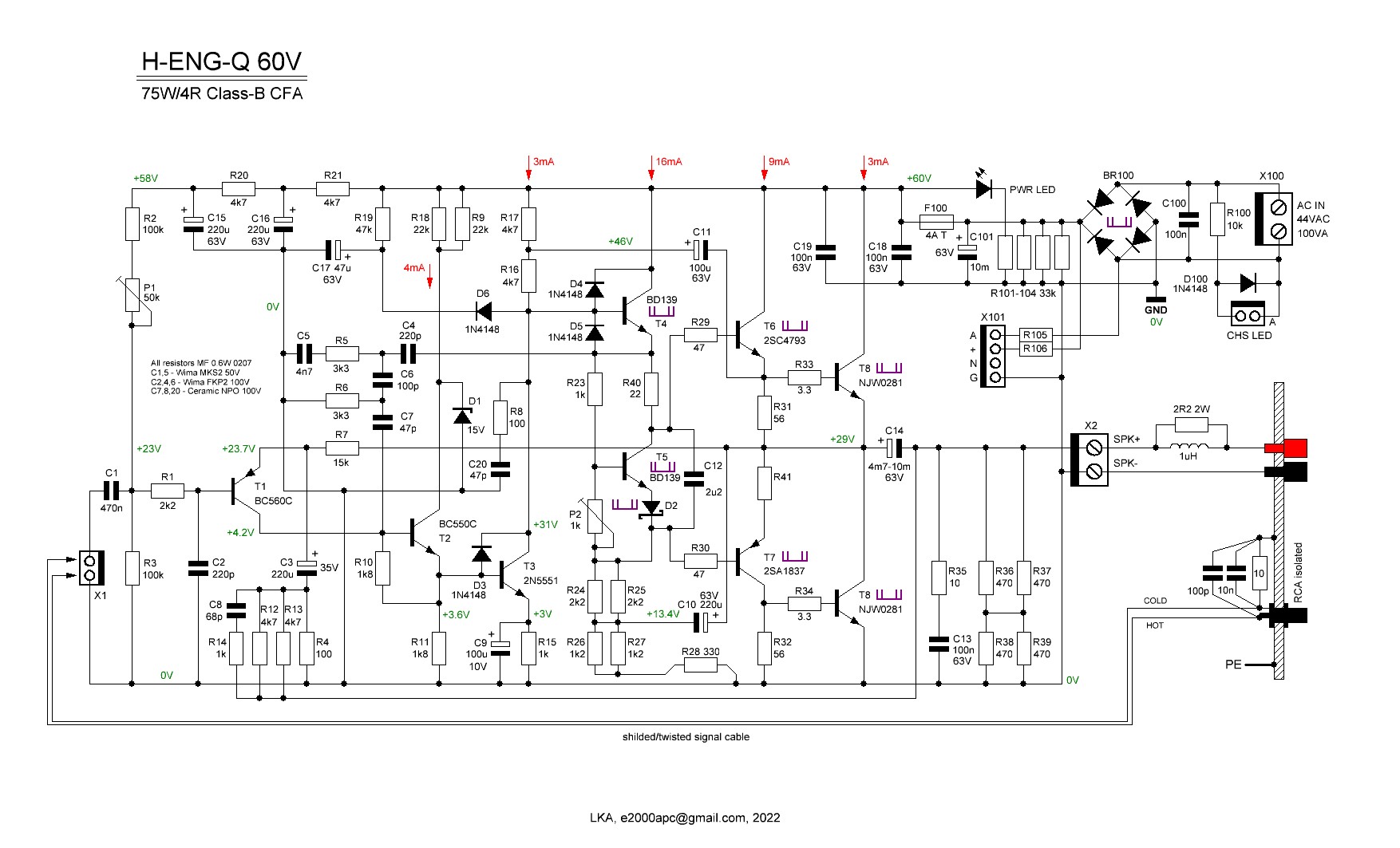

Looks great. Looking forward to the finished piece. A few quick questions:preview of the new 60V-75V powered PCB
- Is there any advantage to class AB operation, as you mentioned in post #15, and will you be including the option of emitter resistors?
- What is the gain of the amplifier, and is it adjustable (easily, via a resistor). Asking because I have been experimenting with different preamps, and this would make a great power module; although I realize it is self-sufficient.

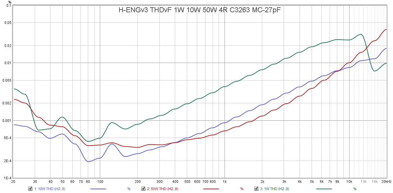

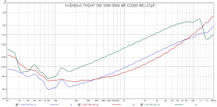

Actually the cause of lower thd at higher outputs is the effect of the bootstrap.Remove the bootstrap and you can see lower distortions at lower outputs again, but much higher thd at high output.I'm feeling a bit mean here, but I'm noticing a rising distortion characteristic at higher frequencies for the 1W/3mA plot - more so than for the higher-power traces.
If this is indicative of crossover distortion, then a plot for 100mW could be very revealing.
As I say, I feel a bit mean because I think the work you've done here is really useful.
1. I didn't see a measurable difference.
2. The gain is 21 (26.5dB) and can be slightly modified.

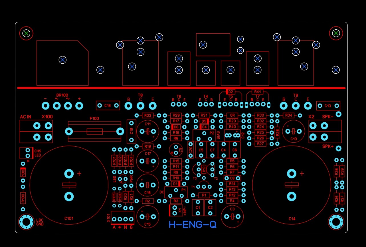

By the way, within a moth I want to try a quasi-complementary version (the pcb will accommodate to3p/to247/to3)

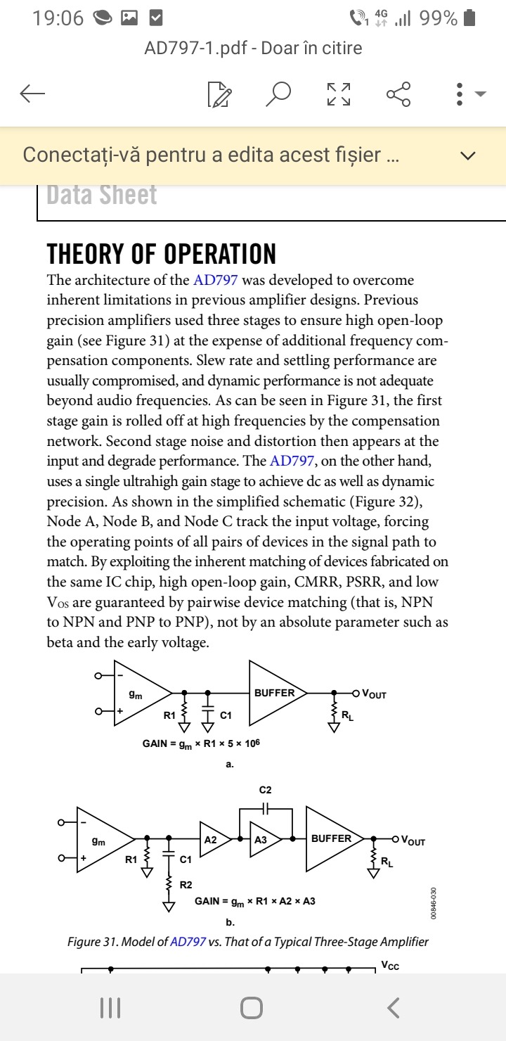

Three stage and three pole is different. Three stage is 3x gain stage. Three pole is 3x pole in the compensation. What is your point?"To have a 3rd pole or not ... that is the question" .Just found one of the forgotten discussions that makes me regret SW as if he was dead...

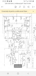

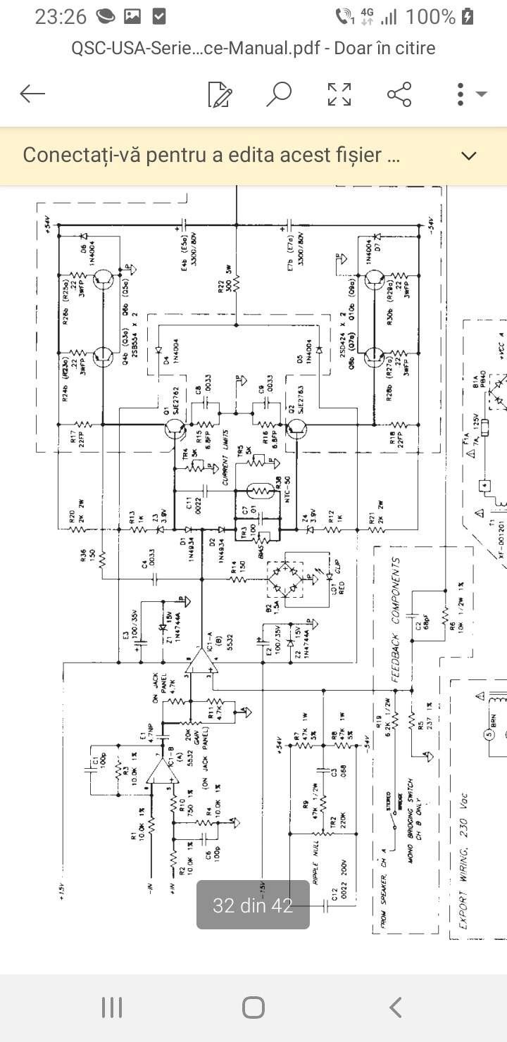

Here you have a class B amplifier and negative impedance can't be fought with just added independent emitter resistors as it would interfere with the class B itself while the feedback needs to get that class B output pair operate in the linear region when it's needed, so you can only add general output inductances to fight the negative impedance although you can hardly get negative impedance with class B output as there's no gm doubling.The output inductance in class b amps is only trying to separate the feedback action from the speaker's impedance game to make the class B stage operate in a purely current dumping fashion if possible.The reliability of version with Re emitter resistors would be definitely better than without them. Especially under unexpectedly difficult conditions with complex load.

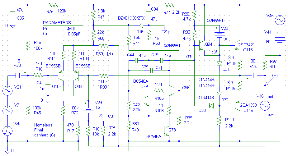

Simulation is a toy and is addictive 😀
It's a dc simulation, the capacitors replaced by a voltage source.
No symmetry, no current sources and current mirrors, all topologies are 50 years old, distortion -140dBc
At minimum distortion there is a trimmer, it will please 😆
Have you tried TMC with either one or both capacitors replaced by a TPC arrangement. Can get crazy loop gains around the output stage this way.
The nice square wave response of TMC can be preserved if you replace only the capacitor that is usually driven by the VAS with a TPC network.
