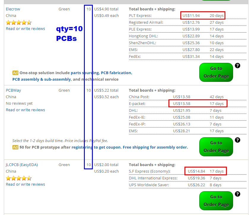

Today's price quote from PCB fabs in China. Qty=10 Quasimodo V4 thru hole PCBs, for $12 to $15, including shipping to USA.
Buy ten, use one, sell the rest for $2 each (plus postage), and turn a profit.

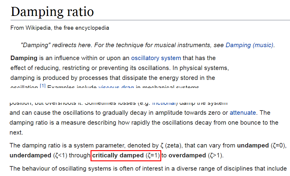

Your board might be faulty. You could test this hypothesis by connecting a fixed inductor to the screw terminals on your Quasimodo V3's terminal block. Chose an inductor whose inductance is greater than 100 microhenries. Or if you have none, just scramble-wind at least 200 turns of insulated wire on an iron nail to make your own "ghetto inductor". Then connect to QM and dial the potentiometer for zeta=1 damping. Is it ALSO 6 to 8 ohms? If so then your board definitely IS faulty.

Adjusting now the trimmer resistance for the damping factor Zeta=1.0, I obtained the waveforms in the sixth figure; the trimmer resistance at this setting measured 330R, i.e. twice the value obtained with Quasimodo and the primary and one of the two secondaries shorted.
... with Quasimodo I measured Rs=625R for Zeta=0.707 in such a configuration

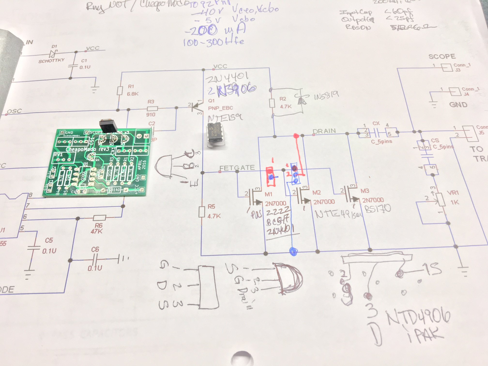

Cheapo2Quasi-ModoMagik
Just as the title says since I have the incorrect boards.
You heard me correctly I have the Cheapo-modo v3, through hole boards and I'm going to try and put some of the Quasimodo v4 parts in that one.
Part A
Step 1: Examine the schematics for each device then get the data sheets for the devices and see if I could correlate them and fit them on the board.
Step 2: Study them, over and over to make sure I knew the proper pinouts of the devices, their location, and where they were in the schematic, and their orientation on the board.
Step 3: Write down the DGS terminals on the schematic, use the board layout and original device orientation and device terminals SGD and GDS know where to place the terminals of the substiture devices in their corresponding locations on the board.
Step 4: Identify the NTD4906 GDS pins to place into the three different 2N7000 JFET pin's locations; that is, 3 sources, 3 gates, and 3 drains. Intuitively I thought I might get lucky and not have to twist and bend
the pins of the NTD4906 into a pretzel to get it to fit.
Step 5: Why did it take me so long? Well my bench is about 1/3 finished and it is a different enough configuraton that I need to work on stuff and put stuff together and take stuff apart so I won't end up screwed at a later time and not be able to remove shelves and replace them in a different location.
Part A has been laid out and it is on the PCB, not soldered yet.
Part B is to fit the DIP8 MPC1407 into the 3 pin EBC transistor slot. I think this can work as shown: Pins 1, 8 = Vcc Pin 2 = Input Pin 4, 5 = Ground
Pin 6,7 = Output
Not too sure complety....might blow something up trying to get it to work.
Part C is then to figure out where all the little caps are going as there is no provision for them in the chepomodo.
Part D also have to figure out how to power it and keep some
voltages separate from signals, etc.

Post Script - I think I'm going to hold off on the trying to implement QuasiModo v4 on the Cheapo-V3 board. Save parts, time and frustration.

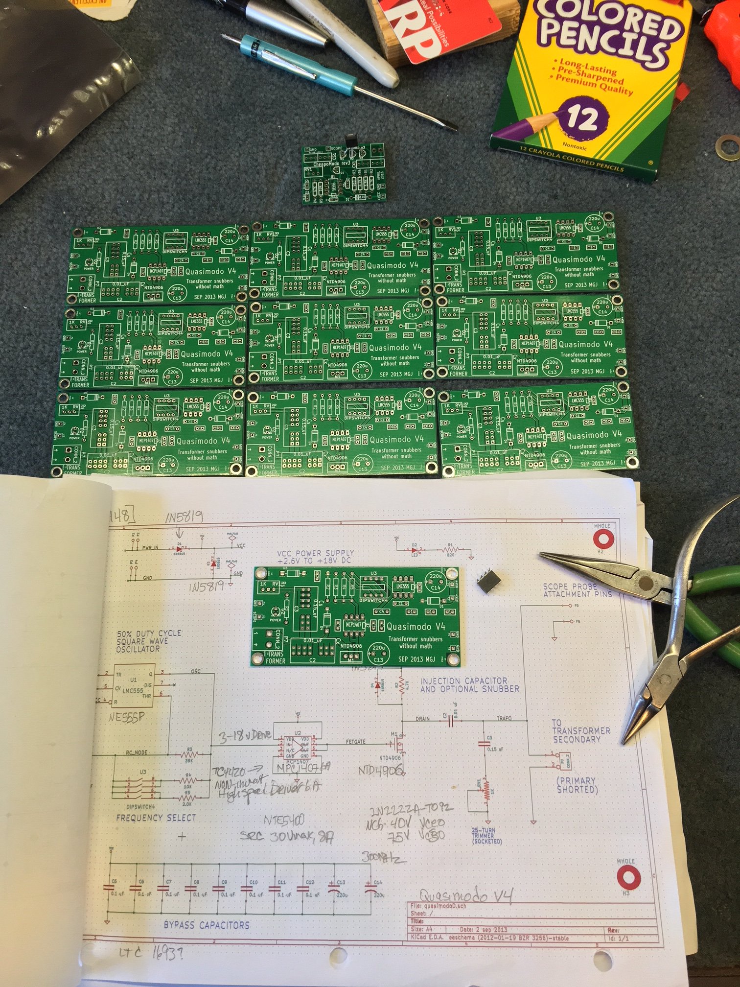

Finally the Quasimodo TH V4 boards have arrived
Ta da,
I'm happy, I did it, even with the threat of Tariff and other BS, I over came my uncertainty and bought the boards from China and got them delivered in less than a week.
